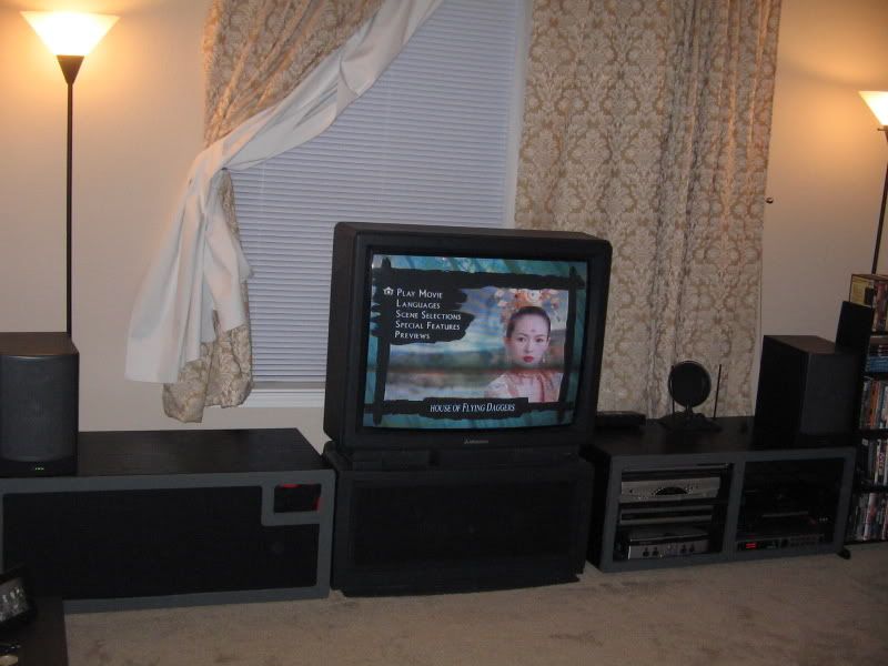

Here is a shot of my subs and mains.
Alpha LS Guy
Formerly known as Maggie Guy

I though I was nuts when I finally settled in on the centered position for my subs.Good to see more positioned like this.
There's always the possibility that you're both nuts.
What are they?
They are 12in Shiva's in sealed enclosures. The mains are Alpha LS line arrays.
