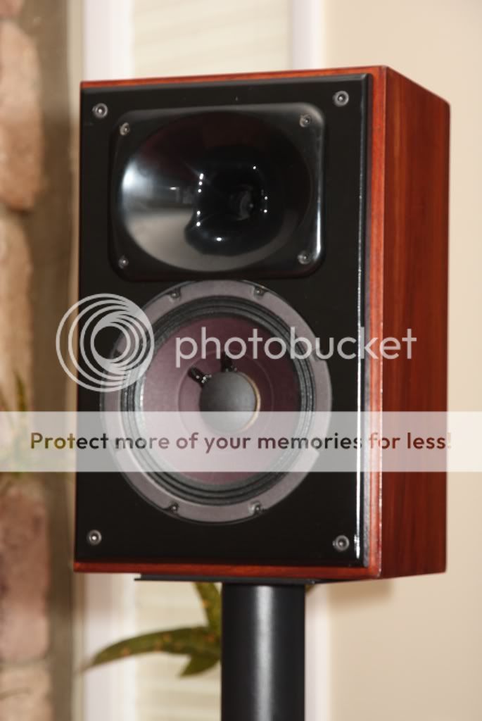

First Project
Econowave Minis
Woofer: Eminence Beta-8A
HF: 18 Sound XD120

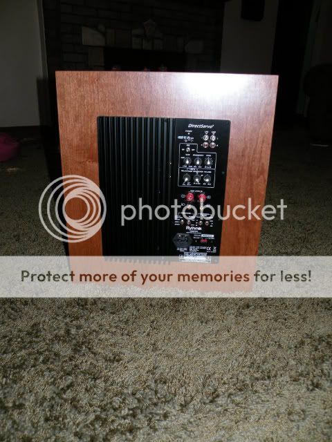

My Rythmik twins. DS1510 HP's in Cherry.

Originally Posted by gye View Post
First Project
Econowave Minis
HF: 18 Sound XD120
Very nice, love them! What box did you end up using?

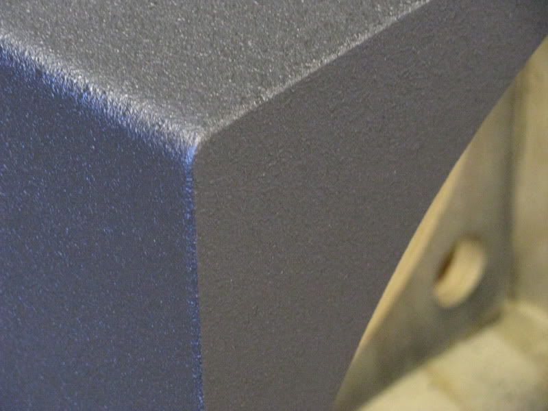

This is a 20" cube for an 18" driver.

Wrong, that is FOUR 20" cubes for 18" drivers!
All for one room?

DING DING DING!!!
Wow! how did you guess that? Unless you...........Are you spying on me?
I forgot to mention that all FOUR have a sprayed Duratex finish.
1/2" round over on all 4 sides, with a 1/4" round over in the back, and 1/8" on the face.
There is a 3/4" face that is recessed and a 1.5" baffle.

Make sure you post pictures when complete and in their new, native environment as well!
Congrats!
And which driver?

I've lurked here for years. So, here's my 1st post.
Nothing fancy. I built these about 6 years ago for my wife's Beomaster 1900. It is a set of Polk DB6750's (a component setup with 6 3/4" woofer and 92dB sensitivity). I wish I would have known a forum like this existed when I built these. I used an online program to help me with the box size and port length. A tech at Polk was kind enough to give me the details of the speaker I needed. IIRC, I turned the port to 40Hz.
After what I've read here, I'd likely have done a number of things differently. They do sound pretty good though.
speakers by chilort, on Flickr
