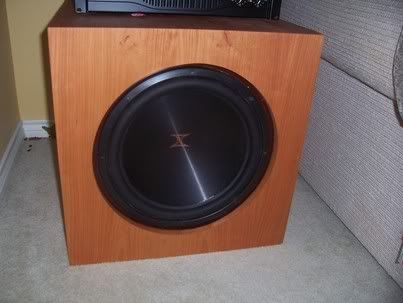

Hey all,
I finally got going on my DIY speakers, starting with my subwoofer.
Box design: Sealed 2 cu. ft. cube
Construction: 1" mdf walls; 18.5" exterior size; mitered edges all around.
Driver: Dayton RSS315HF-4 12" High Fidelity Subwoofer
Amp: Dayton HPSA500 500W subwoofer plate amplifier
Here's a couple pics:
I plan to veneer and finish shortly, once I decide on room colors. I'll either use maple veneer and stain with a dark wine red, or I'll use Ash veneer, and go black. Not sure yet.
Then I'm planning on building a set of GR-Research AV/3s, along with a center channel. Then a pair of surrounds... If I'm lucky, I'll finish it all by Christmas!
Also, I've attached a link to my build thread...check it out!
http://www.diyaudio.com/forums/showt...threadid=83265

Looks good. How does she sound?

I've only got about 3or 4 hours listening on it total so far, but I am pretty impressed. It's more powerful than I would've expected, and it shakes the house more than I would've thought. I'm still planning on integrating it into the room using the Behringer FBQ2496 and some good measurements, but I've been pleasantly surprised at how good it sounds already.
Hopefully that means I don't have big room mode issues.
Note that if you read my build thread, I indicate I'd like to build two... with how good this sounds now, I'm carefully rethinking that, but I already have the other driver, so I might do it anyway.
It sounds tight and accurate, with very little boominess. I would also describe it as fast, and it's quite musical. I'm very happy that I went with this design; it's going to meet my needs very well.
Now I've just got to figure out what finish I want on it!

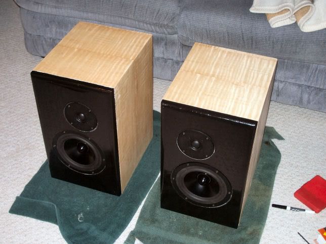

Here's My Modula MTs:

Don't you just love those speakers. They sound so good! Good work on the cabinets.

Yeah these speakers are really nice! I imagine they'll get even better as I don't have them set up properly yet, but how do these compare to your big TMWW towers?

Derek, those look outstanding...What kind of veneer is that? And, is it bare veneer or is it treated?

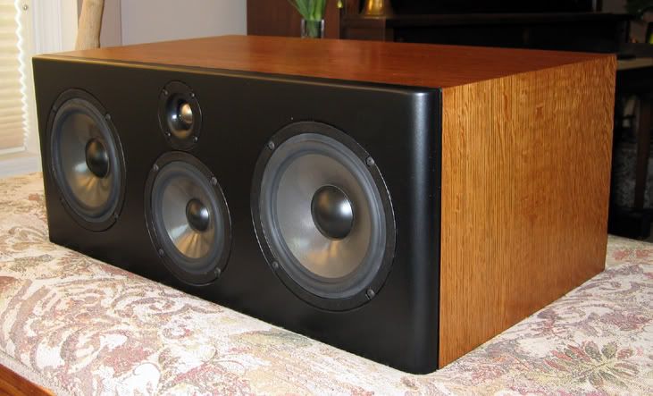

Although I've had the parts for these for over two years, it's been hard to get them done. So this summer I piggy-backed the Modula MT project on this one and it worked out pretty well. Instead of cutting four baffles, I did nine...and so on. I'm very happy with these as well.
The center speaker is quite amazing in its ability to deliver dialogue as well as musical instruments and movie special-FX audio.
Full report is here:
http://www.avsforum.com/avs-vb/showt...&&#post8551815

Nice work!

Very, very nice. Do you have a more detailed description of exactly how you did the black painting and finishing?

Hey thanks, I used some curly maple veneer I got off of Ebay and sprayed 2 coats of lacquer and a few coats of clear enamel on top of that.

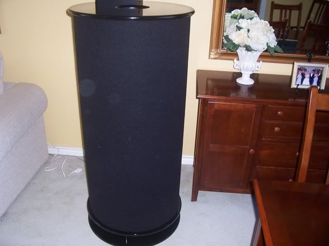

My sonosub:
Design Thread:http://www.avsforum.com/avs-vb/showthread.php?t=726584
Design: Vented, 6x27" port, tuned to ~14.5hz.
Enclosure: 24x48 sonotube. 1.5" thick mdf top cap + .75" outer panel, 1.5" mdf + .25" ply bottom cap + .75" outer panel. Driver is recessed in outer panel.
Driver: TC sounds TC2000 SVC
Amp: Buttkicker BKA1000
EQ: None
Fabric covering: Headliner material from JoAnn's fabric. 54" long by 3 yards total.
Total Cost: Approx. $800 for everything, including incidentals.
Prior speaker/sub building experience (0-10): 7, based on doing many car audio enclosures. This was my first home theater build and first sonotube build.
Summary: I am EXTREMELY happy with how the sub turned out, both aesthetically and how it sounds. Coming from the car audio background, im used to deep, loud, and clean bass. This sonosub is as close to that as I can imagine. This thing goes deep and loud and is very tight, not muddy. Building the sonosub design was not hard at all. I would do it again in a heartbeat.
