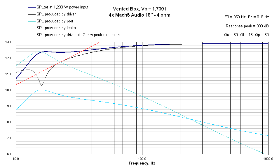

Here is a projection for my upcoming project using four of the MJ-18's (4 ohm):
1700 liters, 16 Hz tune, 1200 watts. This system is in a family/rec room, which serves as a billiards music system and secondary home theater -- I'm not shooting for the depths of hell with regards to output but it looks pretty dang flat to about 15 Hz. Room gain and perhaps some eq will flatten out the 20-40 Hz area nicely.
Obviously 425 liters x 4 is not for everybody, but I have a unique opportunity to blend the enclosures into cabinetry alongside and behind my RPTV, so they will not stand out as massive speaker boxes in the room.
Not too shabby output for about $300 shipped in drivers! These provide about 10 liters of Vd.
