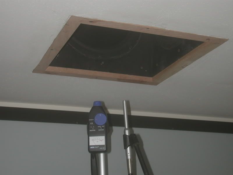

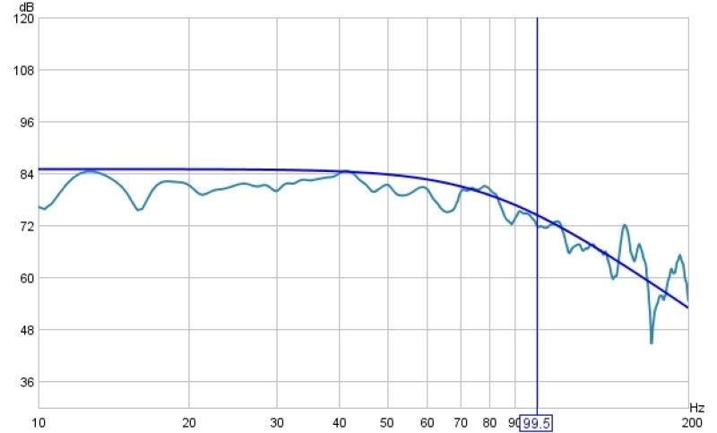

Originally Posted by SteveCallas View Post
When the bulk of the frequency range on a sweep is centered around say 85db, and then there is a 6db drop below 20hz, claiming the +/-3db point iss at 82db is pretty weak. The spl is being cut in half, it's fairly significant.
A single LLT isn't designed to be flat into single digits, where did you come up with that idea from? Just as when someone wants to be able to play at moderate to spirited levels into single digits with a sealed sub, meaning multiple drivers, the same would be needed with a LLT, in addition to plenty of volume. This idea of wanting to stay flat to the single digits with the ability to play at spirited levels is not something that will be accomplished with a a couple drivers, we're talking a relatively large scale project, like the 10 driver Dayton HiFi 15 design that was being talked about a while back. Even then, the depth one can stay flat to in the singel digits is going to be hindered by electronics rolloff. Again, it's not a simple undertaking, if it were, everyone would be flat to 3hz with 120db capability already A LLT is designed to get the most impact - the best all around performance if you will - from each driver, allowing reference or near reference (depending on the driver) levels into the low teens while maintaining great accuracy in the musical range from just one. The majority have not experienced powerful infrasonics in movies by means of a bass reproduction system that can stay flat into the low teens and still be able to play at very spirited levels. For each ported to sealed counterpart, we're talking ~6db more headroom down low, extending flat FR lower.
My measurement was made with RoomEQ Wizard, a calibrated soundcard, and a digital RS meter using Sonnie's calibration file - if you don't want to believe it, you don't have to Nichol and Jon have pretty wide open rooms to the rest of their homes and their own responses with identical subs are reasonably flat to 11-12hz.
You should check out the FR graphs at avtalk
http://www.avtalk.co.uk/forum/index....t=0&rid=0&SQ=0
the dashes on the FR charts say it all...if the FR is "centered" on 85 dB, that would mean the FR peak is 88 dB and 6 dB down or +-3 dB is 82 dB...
all i can say about a digital RS meter is that the number of calibration files vs. model numbers are increasing, this denotes a certain unreliability with regards to accurate FR sweeps...it seems hit or miss with QC...don't take my word for it, just check out the shack...that's why a calibrated microphone, not an SPL meter, presents a better option...
I simply made an observation about the LLT graphs...i'll leave the "vigorous" defense of what an LLT can and can't do to you...if the sub is'nt designed to extend into single digits then perhaps some of the observations offered in the TRW paper have some merit...perhaps the "waveform" distortion, or "destructive cancellation" theory has some teeth...i'm not saying it's fact but it bears investigation...independent investigation...
"Frequency response is NOT efficiency response."

Originally Posted by Richard Mayer View Post
You've seen? You mean you've seen some crappy Rat Shack measurements?
Do notice that his mic correction file doesn't go below 10 Hz. He haven't also calibrated his sound card/measuring chain. Those two alone can have a huge effect on roll-off you see below 10 Hz. Correct those and I'll bet his response will be MUCH flatter below 10 Hz.
I've attached Art's in-room frequency response (Mark posted it some time ago). It goes only down to 10 Hz, but are you seriously suggesting it will drop like a rock below 10 Hz?
right, here is the calibrated FR, though the ecm8000 only has correction down to 10 Hz...looks like -4 dB @ 8 Hz was pretty much on my initial measurements...
it would be pretty easy to attenuate the midbass a little and fit 7 Hz inside a 6 dB window...making it 7 Hz +-3dB...even so, the ecm8000 correction under 10 Hz is unknown...but i'm guessing, by the slope, 2-4 dB at 7 Hz...that would put even 6 Hz inside the 6 dB window...fascinating
I didn't touch the sealed sub's rolloff, that's just what it became after adding the necessary EQ boosts.
An appropriate Linkwitz transform or stacked shelving filter + PEQ is the preferred, but not the only method. The differences vs what you posted are very significant and quite audible.
4-8db/octave of room gain still means you'll need to be adding 8-4db/octave of boost in order to stay flat, and then you'll also need to account for electronics rolloff. No, I haven't even seen any system have a flat FR down to DC at spirited levels, let alone heard one. The 4x15" IBs or even 4x18" IBs I've seen don't come close to staying flat to DC at moderate to spirited levels. If you know of some, point me in that direction please.
No one has said such systems would be flat to DC. Early on catapult made and example as a reality check made of what it would take to produce DC if we actually had an entirely air-tight room.
Kramskoi, looks like you are reasonably flat to 9hz with a little more than a 24db/octave rolloff below that. So I'm not really sure what you are claiming here. The ultra low stuff in that scene is centered around 3hz I believe.
Even with my calibrated microphone there is some VLF roll off. There are microphones that can be flat to ~1Hz or so. My own system is reliable to near 6Hz and I've cross referenced it with Bruce Thigpen's system which he has gone to great lengths to calibrate to very low frequencies. I would be hugely surprised if the kramskoi's measurement doesn't include some inherent roll off in the measurement system. While some like to point to the very lowest content in every case, stop grouping everyone's oppinions as one. The point is that there is in fact energy to very low frequencies, and there are systems that are reproducing this to varying degrees down to the 5-12Hz range. Many have agreed that they have observed notable subjective improvements with such systems. It isn't just about SPL, but the entire mix of qualities in signal reproduction that we suspect is responsible. Or at least that's my own suspicions.
And I've asked you to post such measurements before, as you've claimed a couple sealed 15" woofers will be flat into single digits in most rooms. When you have, the response is definitely not flat into the single digits. We must have a different idea of what flat into single digits means.
I'm not quite the response-nazi that Bosso is (think Seinfeld soup-nazi). I also have used quite a few different measurement systems and methods. "Flat" is a useless definition for a measured frequency response without some stated or implied tolerance window. Is "flat" +/- 0.5dB? +/-2dB? +/-5dB?
I've referred to this before in posts that the idea of "flat" at low frequencies is a bit of a moving target, especially in relation to higher frequencies. The acoustics of a room can HUGELY affect the subjective observation of what a "flat" magnitude response sounds like. Floyd Toole has made public comments that early on a big problem they had with the JBL Synthesis systems in using their EQ and measurements for level setting was that between larger, lossier rooms and small, rigid spaces, they were finding a variance of up to 10dB for what subjectively sounded like the same relative ballance of bass.
I give them a fair shake, but I can't take things seriously when it's suggested that a couple sealed 15s will stay flat to DC in most rooms. I haven't seen anything like that in ANY room, let alone most rooms. I'm trying to be realistic about this stuff, but many sealed afficionados seem to be living in some kind of make believe world. Take a new look at the many sealed projects completed on here and other sites in the past couple of years, most start rolling off ~20hz even after EQ. Your own subs Mark, in the installs I have seen, dropoff around 6db below 20hz, then slowly taper off. Yet all these FRs I see just get a pass for some reason, like we're not looking at the same thing.
Ok, I agree with that. If a house curve is a distortion though, any type of a rolloff is also a distortion, whether it be shallow or steep. I'd just like to see bosso be consistent about that. To the point though, what we're talking about here is being flat to a lower frequency and having a steeper rolloff, or rolling off sooner but being less steep. If the goal is to be flat to the lowest frequency, and the rolloffs are already occuring in the infrasonic ranges anyway (meaning potential ringing isn't very detrimental), the first option would better suit the goal.
Keep your arguements separate. Bosso was the one saying house curves are bad. This is one area where he and I dissagree. You are also forgetting a few important relevant factors when looking at the responses of systems like Art's and the others I've posted. Those systems are in dedicated rooms and are expected and capable of playback at higher main volume levels than many generally listen to. You also cannot see the relative ballance with the main speakers and are failing to keep the points on the response curve in perspective with the rest of the frequency range.
The response curves were concious decisions, as it is easy to make the response measure flatter in those displays. If the system was rarely,if ever, listened to above -5dB from calibrated reference, some of those curves likely would have had more relative 10Hz level. In the context of most of the systems, the ~10Hz level is in fact quite close to the relative level above say 150-200Hz. In my experience it is quite easy to discern a shelving of the response below 20-40Hz by even 2dB. In the setup process I first achieve a response curve that is appropriate for the subwoofers and what I expect to be desireable based on measurements and experience. After that I get to listening and make finer adjustments in the overall level and general shaping of the response. For a wide variety of reasons, I usually deviate from ruler flat.
I understand that a higher order rolloff will result in more GD, but is the difference between the two systems being discussed meaningful? Again it gets back to in room FR. Flatter lower or rolling off sooner but less shallow. As for your second point, now we're talking about in room GD, and that's a different topic. Like I said before, GD in and of itself I could care less about, it's the in room FR that matters most. If a system has a less than 12db/octave rolloff that it can maintain, it should have a nice in room FR that stays reasonably flat to DC with great GD. Please show me such a system in existence, I've never seen one.
Many rooms will have some added losses below some single digit low frequency, and as you well know, many electronics start a roll off in the 3-10Hz range. Such roll off is present with a vented or a sealed system. The coupling to the room will usually result in a shallow roll off at some low frequency, combined with a softer overall knee of the electronics. This most certainly will have a better group delay profile than a vented sub with a much sharper corner below it's tuning frequency.
Technically that may be how it's done, and if you consider a steady 6db drop to still be flat, more power to you. I'll agree to disagree.
To play devil's advocate, what were they coming from before, and after how intensive an installation? How much of the improvement they are experiencing is from being able to play into the teens reasonably flat as compared to single digits at 10-20-30db down? Comparing something to nothing is a no brainer, but your same logic can be applied to higher frequencies. Back before infrasonic capability was the norm, would you rather have been flat to 20hz with a steeper rolloff or start rolling off at 35hz with a more shallow profile? The hearing sensitivity curves tell us that we become less sensitive as frequency lowers, so at least staying flat would be a reasonable goal. When you make it a subjective issue citing individual preference rather than an issue of accuracy, it becomes gray area, as everybody will like something different. There are people who don't like any infrasonic capability. That conversation will only get so far, and we end up in this continuous loop like we are now.
I didn't link to that graph, just responded to it. If I'm not mistaken though, he's using four of those subs plus some built in woofers in the walls, yes? I'd think that would level out the playing field between his system and a more typical one with only one of those subs. Point I'm trying to make yet again is that it seems to be underestimated in this thread the amount of air moving capability it takes to be able to stay flat into the single digits while being able to play at spirited levels. Again, if it were easy, we'd all be flat to 3hz with 120db capability.
Again, we're talking about infrasonic rolloffs vs FR linearity and low end headroom. Accuracy will side with the latter, whereas you might cite some individual preference for the former. I have a series of interesting blind tests I would like to participate in regarding this preference you cite. I will make an effort to visit someone with an apporpriate sealed system to eventually conduct these tests and report my findings.

Well, that isn't very difficult to calculate. Four 15" RL-p's: Sd=3200 cm^2, Xmax=25mm. Add an average 8 dB/oct. room gain starting at 30 Hz. Note that I didn't add any boundary gain, these are 1m free-space numbers.
Code:
Freq.    SPL
5 Hz    112.4 dB
10 Hz   116.5 dB
15 Hz   119.5 dB
20 Hz   120.5 dB
I can keep this up forever, but no progress is really being made.
We know, we know...
Richard Mayer is offline
Code:
Freq.    SPL
5 Hz    112.4 dB
10 Hz   116.5 dB
15 Hz   119.5 dB
20 Hz   120.5 dB
This is a great example. Obvious to most of us. Conservative at that.
There is also the fact that only an escaped mental patient would listen to a system that is calibrated flat to 20KHz at these levels. It bears mentioning that, at lower levels, the subwoofer described above could easily be calibrated flat to 5Hz at 110dB.
I've actually done that with 2X15", the graph of which I posted several times over the past couple of years.
Bosso

I have that graph saved. I've attached it for Steve.
