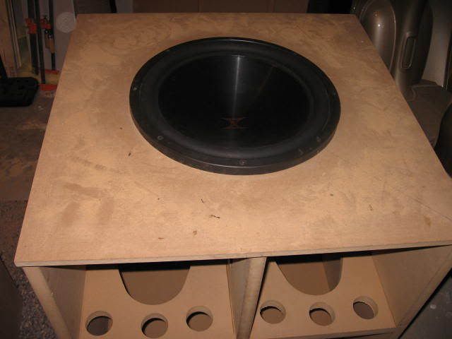

No fear at all. I like the "sealed" sound better, I guess I have yet to hear a vented box done right, but I have not had the chance to drop in on other peoples projects either.
With that much power in that much space, it works quite well. It shakes the house plenty.
A pic of the home theater, an acoustical nightmare btw. Ya gots to work with what ya got.
Don't mind the tower speakers that are there now, they are about to get displaced.
But, you can see, I don't have hella room to work with, and this sub does the job in that space.

Originally Posted by vitod View Post
It would be too big and expensive for him. But you never know.
Hmmm. Aren't they selling the DB-500s for like $75 right now?
Hey, Digital,
Very, very nice work on the oak sub
Bosso
bossobass is offline
post #26 of 42 Old 02-08-2007, 01:12 PM
vitod's Avatar
Location: Pocono, PA
Posts: 3,666
Quoted: 248 Post(s)
Liked: 124
Hey, Digital,
Bosso
Your right. Too big then.
