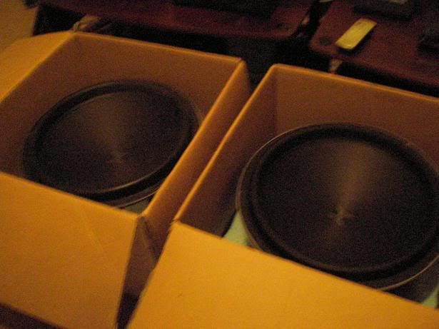

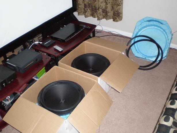

Mega bumpage time!
Look what arrived at my front door this week.
Bought these used from user tjambro over at HTS. Same RLpd4's that I have. Plan is to use all four for a quad sealed setup. Still need to build the cabs and get another amp though...
The journey begins.... again.

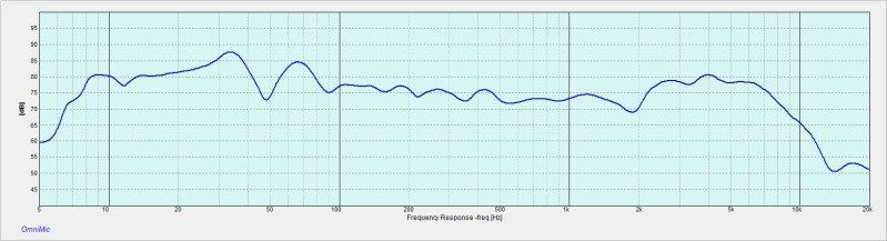

Got bored today and played around with my OmniMic system, which is awesome btw. Totally forgot to ever measure my damn twins with it. Lol! redface.gif
Here is the system FR with no EQ:
It flattens up with a single filter on the BFD except for that dip in the upper 40's. Most likely room/listening position related. EDIT: Sorry, that was left at 1/6 smoothing.

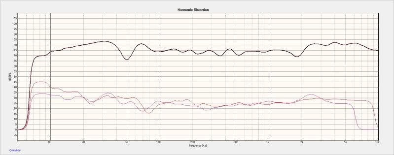

Here is another with the single filter engaged on the BFD and 1/12 smoothing.
And distortion plot for s**ts and giggles. IIRC, the red is 2nd and the purple is 3rd. Looks pretty good to me. smile.gif
You need to run that distortion curve at more than that SPL. How about 100dB and 110dB distortion sweeps?

maxmercy is offline

I'll see about running some more tests on them later this week. This was just me fooling around and getting aquainted with the Omnimic system, really.
