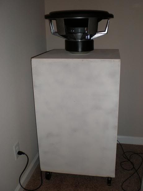

Here is the first cab I built for my Dad, three fake ports due to me routering the wrong end of the box. No big deal though, I'm building him a matching pair now. They will be finished out as end tables.
Stats:
24"h X 18"w X 36"d
Just over 6cf @12.8hz
Here's why I get asked to design subwoofer cabs

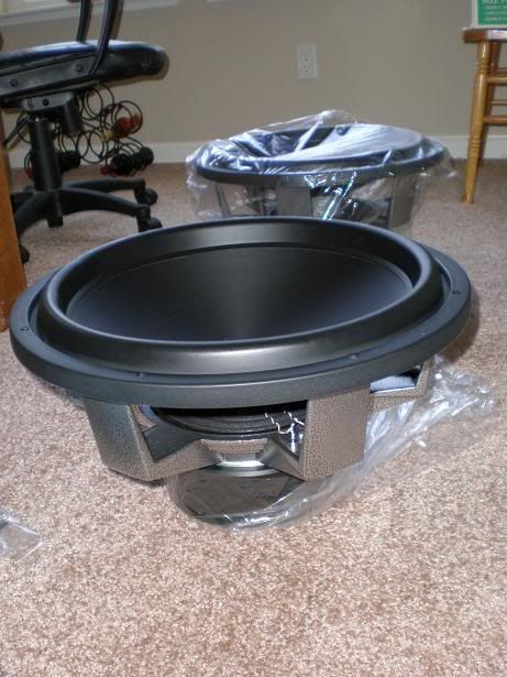

Anyhow...I took these about a month ago and I am not sure who has seen them.
teh box
Driver on top of my current vented Tempest

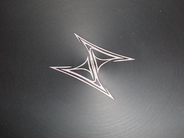

Logo

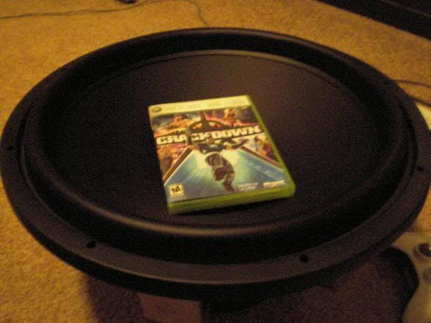

Amaray case on top for scale. Some people were using dvds/cds on their 15 inchers for scale but this just makes more sense for a large Sd driver such as this.

That is some serious sub you have there! The poor Sunfire looks so tiny next to the mighty goliath.
Scott,
Those Soundsplinter RL-p18 woofers look like serious business,definite eye candy for the sub fanatics.
I wonder if they have them in stock...
Sent them an email,I like ...I like.

Ahhh....so you're the one who built that sucker! I love that thing. Wish that was my first subwoofer, ever. Haha! Are those AV-15's in there. Holy cow! What's that tuned to?
That end table sub you made for your dad looks pretty nice. Lots of router work, looks like.

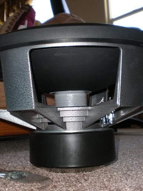

Glad you guys like
the drivers are Eclipse 88 series, 3" VC, 19mm X-Max, QT .474, FS 21, VAS 201L, good stuff. Box is tuned around 14hz IIRC, I should check it with WT2.

Glad you guys like
