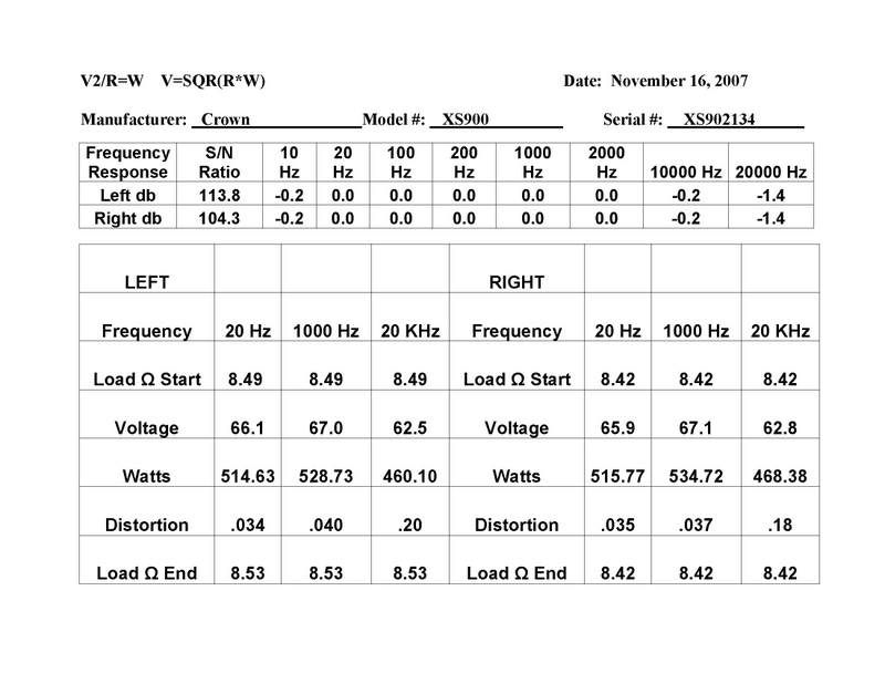

Here are the measurements for a Crown XS900 power amplifier. This amplifier comes courtesy of WillD who had it sent to me before he has even seen it! I am going to try and get it up to him by Thanksgiving so he has something to play with for the holiday.
The manual states the following specs:
8 ohm stereo 600 watts per channel 20-20Khz .5% THD
4 ohm stereo 900 watts per channel 20-20Khz .5% THD
2 ohm stereo 1200 watts per channel 20-20Khz .5% THD
8 ohm bridged 2100 watts 20-20Khz .5% THD
4 ohm bridged 2400 watts 20-20Khz .5% THD
The unit employs 2 variable speed fans located at the front of the unit and sucking air in from the front and out the rear. The front panel has every indicator imaginable that a person could want on a power amplifier.
AC Mains present
AC power on
AC fault
L & R signal present
L & R clip
L & R temperature
Bridged Indication
Here are the measurements at 8 ohms stereo.
The measurements for 4 ohms stereo, 2 ohms stereo, 8 ohms bridged, and 4 ohms bridged will follow shortly. I will also have close up pictures of the unit as soon as my camera batteries charge.
Chuck
chasw98 is offline

Here are the measurements for the Crown XS900 amplifier at 4 ohms and 2 ohms stereo.
An interesting sidenote. I have a 30 amp variac that is plugged into its own dedicated 30 amp circuit. This amplifier was drawing 24.8 amps at 120 volts during the 2 ohm full power load test. It would only do it for a very short time.
chasw98 is offline

Nice. What design/class is the output stage? Consuming "only" 3000 watts of power while putting some 2400 watts total into the load is about 80% efficiency, isn't it? That seems too good to be true, so perhaps I'm missing something.
I know Willd was looking at the XS1200 as an alternative, so I guess that amp could only be even better.
Signature Challenged.

Doesn't sound like a bad deal really. The 1200 can be had new for $599, so used should be a real steal.

Thanks to WillD for the use of his new XS900 and thanks again Chas for your excellent equipment setup and testing. This amp shows some power, quality distortion figures, excellent S/N ratio, and frequency response, but like some others the power figures fall short of manufacturer's specifications and claims when using these stringent tests. We are left to decide for ourselves whether or not the amps perform as advertised.
