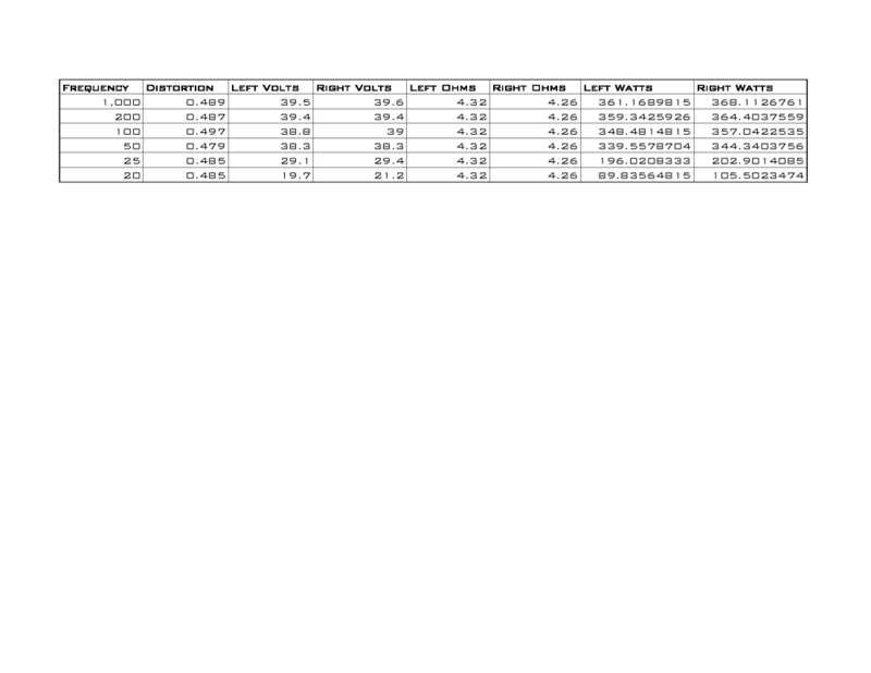

Those numbers are really strange indeed. If the amp is not defective, I have to admit that the xti series is umbelievable.
But that is not the most disturbing thing I have noticed now that this gigantic noise has risen because of this new test. What disturbs me the most is that, even people who have several different amps, good and bad, couldn't distinguish the horrible amplifiers from the good ones with their ears? Now that the amp has been tested and you have the numbers, all of the sudden everybody gets angry and starst yelling everywhere. It's like the audio hobby for some people is to watch all sorts of tests all day long and brag about ther über systems and gadgets. I tend to use my ears time to time, when comparing different systems. Not just watch some test data and numbers all year around.
90w in subwoofer application is something that everybody should have been able to hear with their ears, and not just blindly believe the high price and ultimate marketing bul****. Even I did notice the huge leap towards better sound when moving from 350w plate amp to 2kW pro amp. The difference was just something that you have to be a deaf people if not be able to tell the difference.
I do have SDX15 sonosub tuned to 15Hz.

The inside of my XTi 4000 has more . . . . . stuff. More capacitors and 16 transistors vs 12 for the XTi 1000. It DOES look like the same circuit board as the XTi 1000.
I also notice that on the Crown website they have added a "20 msec Burst" power rating to their wattage stats for the Itech amps. Maybe the consumer pressure to tell the approximate truth is getting to the manufacturers? Nawwwwwww.

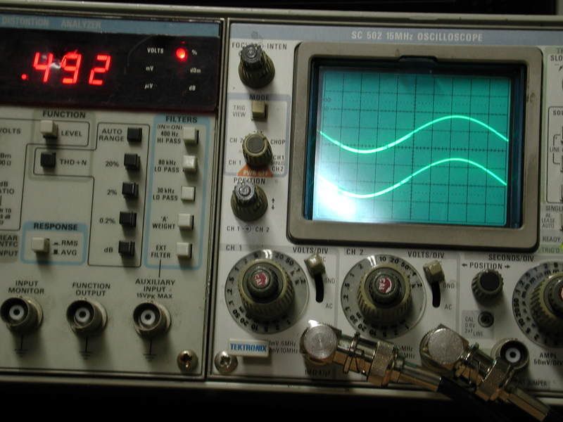

post #743 of 1919 Old 05-15-2008, 06:33 PM - Thread Starter
chasw98's Avatar
Location: Margate, FL
Posts: 1,089
Very precisely and carefully I made another set of 4 ohm measurements at 1,000 Hz, 200 Hz, 100 Hz, 50 Hz, 25 Hz, and 20 Hz. All readings were taken with a THD set between 0.475% and 0.5%. Just in case you are wondering how this is done behind the curtain, I have included 2 photos of the analyzer set at THD and then at voltage while testing at 20 Hz.
Distortion set point.
Voltage reading after setting distortion at 20 Hz.
The results of the measurements with all pertinent data.
If you look carefully the power really appears to drop at 20 Hz.

Thanks a lot fireanimal for sending your amp to Chuck!
Bizarre how the amp drops in output from 50Hz to 20Hz.
