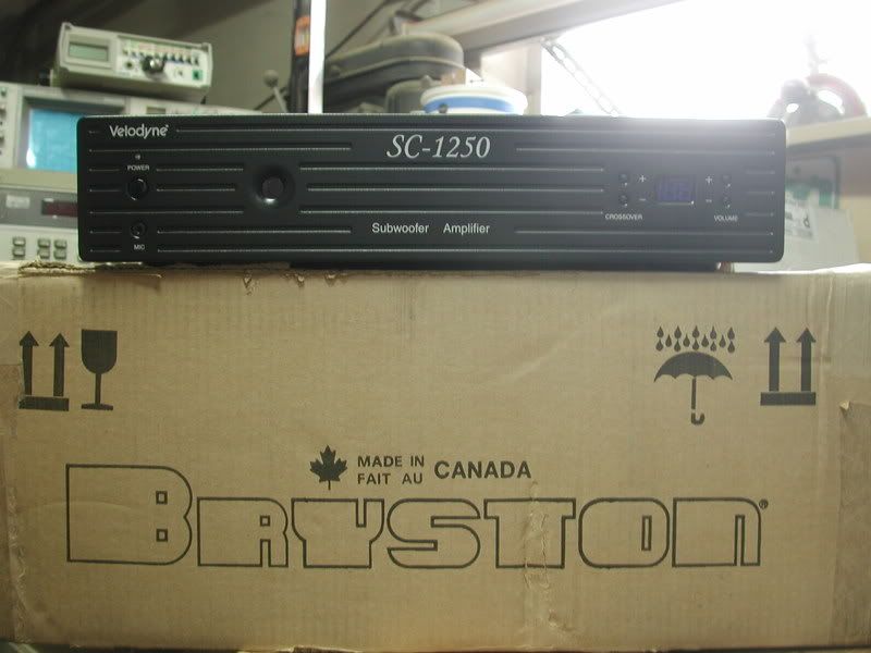

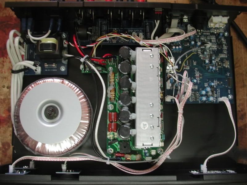

post #1006 of 1918 Old 06-01-2008, 11:10 AM - Thread Starter
chasw98's Avatar
Location: Margate, FL
Posts: 1,089
Here is a Velodyne SC-1250 subwoofer amplifier. penngray has kindly sent this amp to me for testing. there is a previous review of this amp from here: http://www.hometheaterhifi.com/volum...06-part-3.html.
Exterior view:
Interior view:
Continued
chasw98 is offline

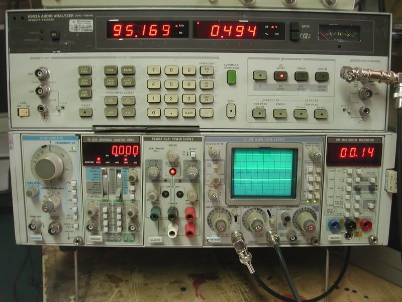

post #1007 of 1918 Old 06-01-2008, 11:14 AM - Thread Starter
chasw98's Avatar
Posts: 1,089
Here are the measurements. I have only published at 50 Hz because it has essentially the same readings at any other useable frequency.
And here is a shot of the 96Khz oscillation that exists in this amplifier at all times.
Doesn't seem to hurt anything and it is noted in the other review, but it still seems very high. I knocked it down by 25 dB with a 30 Khz filter.
Chuck
chasw98 is offline
post #1008 of 1918 Old 06-01-2008, 11:26 AM
NEO Dan's Avatar
Location: North East Ohio
Posts: 3,010
finally, something that actually makes close to rated power.
Dan
NEO Dan is offline
post #1009 of 1918 Old 06-01-2008, 11:56 AM
penngray's Avatar
Location: Florida
Posts: 26,862
Liked: 41
Thanks Chuck for the test!
penngray is offline
post #1010 of 1918 Old 06-01-2008, 12:39 PM
BassThatHz's Avatar
Location: Northern Okan range (NW Cascades region)
Posts: 6,884
Mentioned: 65 Post(s)
Quoted: 1905 Post(s)
Liked: 1452
I am quite surprised to see a toroidal transformer in there. I had the plate amp in my HGS-10 replaced from 2002 to 2007 design, it does NOT have this...
Both appear to have the same laminated transformer for the DSP (circuit on the right), which in the case of the HGS this is supplanted by an analog Servo/Crossover module.
I recognize the amp module, the metal box and caps, which looks 100% the same BTW.
I wonder how this extra toroid effects the output rating?
Any idea what percentage of the 5.79 THD is the 96khz?
I won't even ask about 2ohm
BassThatHz is offline

post #1012 of 1918 Old 06-01-2008, 07:04 PM
Jack Hidley's Avatar
Join Date: Apr 2003
Location: Danville, CA
Posts: 627
Velodyne uses Class D line switching amplifiers in powered systems. Line switching means that there is no power supply transformer, so no isolation from the AC line to the electronics inside the box. In a powered subwoofer, all of the electronics are inside the enclosure. The driver frame can be made of a nonconductive material and/or covered by wood. The bottom line is a number of steps can be taken to ensure that if there is a short in the amplifier, the user can never touch anything on the subwoofer that may have a dangerous voltage present on it. There is no way to get UL or CE safety approval with a line switching amplifier.
Since the amp that Chuck just tested is not embedded in a powered system, it uses a power supply transformer to ensure that the user can't be shocked if there is a fault in the amplifier.
Jack Hidley

I contacted Velodyne directly, let see what their support has to say about the toroidal transformer...
I just re-read the manual it doesn't say anything about an infrasonic filter starting point and oct/slope. I am fairly sure based on the DD series that it has one and is fixed to either 20 or 15hz... just not sure which.
Do not confuse the EQ in the SC-1250 with the SMS-1, there is no on-screen display.

[quote=penngray;13993018]Why do you say that, it does not have a hard SFF
Chucks Frequency response chart shows it down 4db at 15HZ and down 25db at 10Hz.

[quote=LINEARX;13993248]
Chuck's test is kind of invalid. The subsonic filter changes along with each preset.
"Each preset has its own characteristics with respect to subsonic filter, volume differential and a single equalizer (EQ) in order to optimize the listening mode for the preset."
Also, the subsonic filter and other things change along with selection of the specific matching subwoofer model that is set in memory. The SC-10 is the default subwoofer setting (rated at 24 Hz low end). It looks like the amplifier limits power / frequencies based on the subwoofer drivers capabilities.
"Your SC-1250 can control a variety of Velodyne SubContractor Series subwoofers as well as generic passive subwoofers. Special internal software settings are designed to maximize performance and reliability depending on the model of subwoofer being controlled, so it is important to match the SC-1250 amplifier with the subwoofer(s) it is controlling. The SC-1250 comes with a default setting for the SC-10 subwoofer. When the unit is first powered up, the model being controlled is displayed for 2 seconds on the numeric LED before the display reverts to the volume setting. The subwoofer to be controlled is shown as follows:
** - The generic subwoofer setting is for passive subwoofers not on the above list. CAUTION: there is no anticlipping or anti-distortion protection on this setting."
J_Palmer_Cass is offline

The SC-1250 will not do 2 ohms!! Its says so on the website, in the manual, etc.
Its actually the amp used with the SC class of passive subs from velodyne. Each SC sub is 8 ohms so you can wire one sub @ 8 ohms or wire two subs into it @ 4 ohms. That is what its designed for but I use two with my DIY subs (dont wire 2 4 ohm subs into it though!!!).
What do you use for settings for your DIY subs? Default? Generic subwoofer?
You should do a True RTA sweep of the amplifier to see what the electrical FR looks like (AKA value/rolloff of the subsonic filter).
