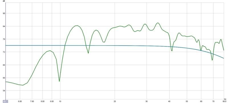

Originally Posted by ssabripo View Post
very interesting observations Dave! I was actually discussing this with ol' Chuck regarding the anomalies that my very challenging room brings to the table.
Interesting there is a HUGE null at below tuning point right around 10hz. My first reaction was that it was the K2's highpass, but that is set for 8hz, and you can easily see how that kicks in exactly at 8hz as well.
But as you said, the proof is in the pudding....once the sealed units are placed in the same chain, and measured with the same EQ + power, it will be interesting to see how they behave!
My opinion is that the dip at 10Hz is a result of phase cancellation between the 2 subs vs the mic position, because with the single AV sub, there is no such dip and, at 10Hz, you'd need a room dimension of 56 feet to see a null.
One of the cool things about the sealed versions is that you could stack all 3 of them in a corner to see if the 10Hz dip disappears (or did you succeed in acquiring the 4th driver?).
It looks like a 10dB L/T or shelf boost will get you very good results, based on the driver/box model and graphs you've posted. In any case, having your detailed posts and graphs and my DIY hero Mr. Chas there will make for a great report and ensuing discussion, no matter what the results.
Bosso
Bosso
I have a feeling it is a room / Sub cancellation as well. Hopefully spreading 4 subs around the room will solve this.
So far I have only 3 ava18's.....I wasn't able to acquire the 4th one. So I'm looking for a 4th as we speak. If I can't find one in the next week, I'm ordering a maelstrom X`18 from Kevin...it outta be as good!
The 1st cube is done...just needs some sanding and painting now. Chuck and I are hoping to power it up tomorrow or this week and play with it a little.

bosso,
"25dB of BG/PVG and you have 112dB... 4 high excursion 18" drivers can easily generate enough output to result in a clean 110dB at the LP."
Are you saying that because of level not decreasing so much with distance in the pressure region (a most interesting point BTW, thanks), SPL at LP is the same as at 1 m?
Have you verified that by measurement?
Yes, I'm saying that some of the gain realized at the LP is due to the fact that ULF travels much farther than higher frequencies without losing intensity.
Yes, I have measured the phenomenon. When I originally showed the graph, most said that it was an outside artifact, like an HVAC system, a passing train at the time of the measurement or some such other ambient noise.
I then took 2 measurements from the same mic position with the same sub and signal chain, etc. The only difference was the introduction of a 20Hz HP filter, which acted upon the measurement exactly as one would predict, eliminating the response to single digits.
Since this is a relatively new thought regarding in-room response, I am open to any opinions that may better describe what is happening in these graphs, but the evidence seems to point to the facts that:
1. All rooms produce gain below 10Hz because they are too small to set up modes due to the wave lengths involved.
2. Ultra low frequencies are largely immune to the inverse square law regarding loss of intensity over distance.
3. Boundary gain is only adversely affected by the construction of the corner used for placement. This can be shown by the increases observed by measurements of the same subwoofer placed in 3 different rooms of varying degrees of lossy construction.
This had led me to the conclusion that a portable corner of a certain design and build may possibly be used to retain some of the gain otherwise lost to poor room construction.
EDIT: Notice, in the first graph, the loss of exactly 12dB from doubling the distance twice from 1 meters to 4 meters, above 20Hz, as well as the reduction in loss of intensity as frequency decreases.
Notice the nearly perfect 2nd order roll off below 20Hz with the inclusion of the HP filter in the second graph, which would not have been the case if the single digit response were due to a constant in the ambient environment.
Bosso

The discussion regarding THD in the first 2 octaves is an absolute non-issue. Noah and Mark are correct, but I have always said that, in either case, the harmonics of these frequencies are inaudible. They are inaudible. They have zero negative effect.
There is also the measurements that I've taken at 4Hz, 5Hz, 6Hz, all at the same dBSPL at the LP and all with extremely low HD showing up on the graph. If there was 100% THD, the harmonics peaks would be there on the graph.
You may as well argue the audibility of group delay at 5Hz.
It doesn't matter the condition. From an extreme mathmatic perspective, a sound source ALWAYS drops at a rate of 20*Log(D/Di).
I understand the theory involved, but I haven't seen any measurements that bear it out. The evidence suggests that ULF does indeed travel much farther at an intensity that contradicts the law. If the explanation is that higher frequencies are attenuated by refraction and/or absorption, the formula for the law is incomplete and has no application in HT discussions.
GP tests such as Ilkka's sweep of the LMS5400-18" L/T, expanded to 1Hz, could easily nail this one. A measurement at 2M and at 16M should show a perfectly uniform drop of 18dB across the entire BW. End of story.
To date, there is no such measurement comparison that I can find anywhere.
Any surface that is large relative to the wavelength involved can be viewed and considered as a miror of the source. If the complex situation of a room is viewed as an array of virtual sources instead of a ray tracing problem, we can get a different perspective on the behavior we can expect that makes it much easier to conceptualize. Once you have an array of spaced sources, we can evaluate the problem based on wavelength vs. spacing. Mathmatically the result is the same for any given point, but it makes for a lot of messy math to observe what is reasonably obvious to anyone who has modeled and tested the interactions of multiple sources such as pro audio loudspeaker arrays.
I suspect that this is the correct explanation. The room creates virtual sources and those virtual sources vary in intensity according to their refractive properties and are frequency dependent.
Of course, again, the evidence shows that this theory is also suspect. ULF appears to be less affected by walls and in fact travels better through the earths crust than it does through air. This makes it hard to understand how a 4" wall in a typically constructed home offers any sort of refraction as frequency decreases, much less offering more refraction.
In the end, I am less interested in the precise mathematical formulae involved and much more interested in the results. I'm not a physicist. I'm a HT enthusiast who has a library of source that has content that's intended to be reproduced as part of the A/V presentation.
I continue to be taken to task over this by the weakest arguments imaginable. "It's impossible with conventional drivers. Flat isn't loud enough. There's too much THD. The source is mistaken, it's just artifacts. It adds nothing to the experience. There isn't enough juice in a 20A circuit. The signal chain rolls off. GP measurements to below 10Hz won't offer any useful information. There was a bus driving by. The HVAC skewed the measurements. It's one of the walls. The box is too small. Ported is better..."
Mark is right, this is just a silly thread jack. I've gotten Mark so befuddled that he doesn't know where to start. I apologize, Chas. This is a great thread that should have all of these first octaves posts deleted.
My original intent was to lead to the suggestion that a FR graph for each amplifier be included because reproduction of the LFE channel, especially DD TrueHD and DTS Master Audio, includes information that a SW amp should be capable of amplifying. It seems that watts at 20Hz vs rated watts is all that matters, which is cool. It's a great thread.
Back to amplifier tests...
