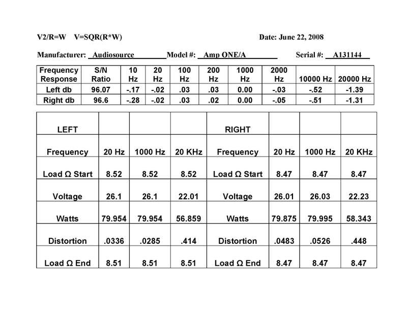

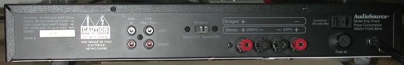

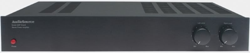

Here is an Audiosource amplifier, model Amp ONE/A that jvgillow has sent to me for measurement. Here are the manufacturer specifications.
Specifications: *Power output: 80 watts per channel @ 8 ohms, 100 watts per channel @ 4 ohms, 200 watts bridged mono @ 8 ohms *Total harmonic distortion: <0.04% *Frequency response: 20-20,000 Hz *Signal to noise ratio: 110 dB *Inputs: Line in (RCA) *Outputs: Line out/Thru (RCA) *Speaker connection: 5-way binding posts *Dimensions:16-1/2" W x 2-3/8" H x 11-5/8" D.
Large torrodial power supply
2 ohm stable
And here are some pictures:

Here are the results of 8 ohm stereo and 4 ohm stereo testing.
This amplifier pretty much, kinda sorta meets its specifications. It will run at 2 ohms but it does not like being tested at 2 ohms. Same goes for mono/bridged operation. I went through 4 6 amp fuses from the power supply when trying to bring up the amp at 2 ohms or bridged. I also noticed that distortion rises drastically as the heat builds up. I had to stop and let it cool down several times. In everyday use none of this would matter and it would work just fine.

It's an inexpensive amplifier at $209 (@ PE) and like you said makes it's claims, kinda sorta. It doesn't advertise itself as the end all and doesn't get there with it's performance either.
If there were a DIY old widow who liked a little bass with her stereo, she might buy this one.

Thanks for the test data Chuck, you are da man
I'm glad to see it didn't test too poorly, at least it meets/exceeds rated output at 4 ohm; I use mine bridged at 8 ohm per for mains. Not sure what it was doing with the 8 ohm stereo @ 20kHz but interesting nonetheless. I've never had a fuse blow on me but I never have pushed them as hard as Chuck does in his tests. For a few weeks I was using one bridged to drive my SVS CS-Ultra (4 ohm) and it never even got very warm.
Buy.com has them cheaper than anyplace I've seen recently, but I got mine back during the Ubid refurb sale so they were I think $85/ea delivered. Not very interesting as a sub amp but they were the cheapest option for me at the time I wanted to go separates.

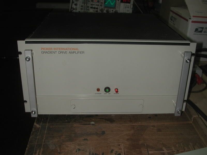

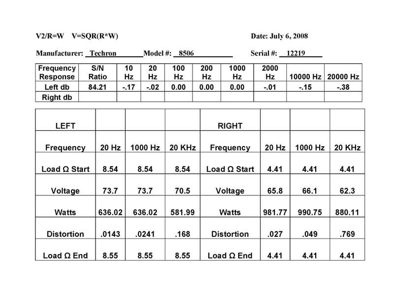

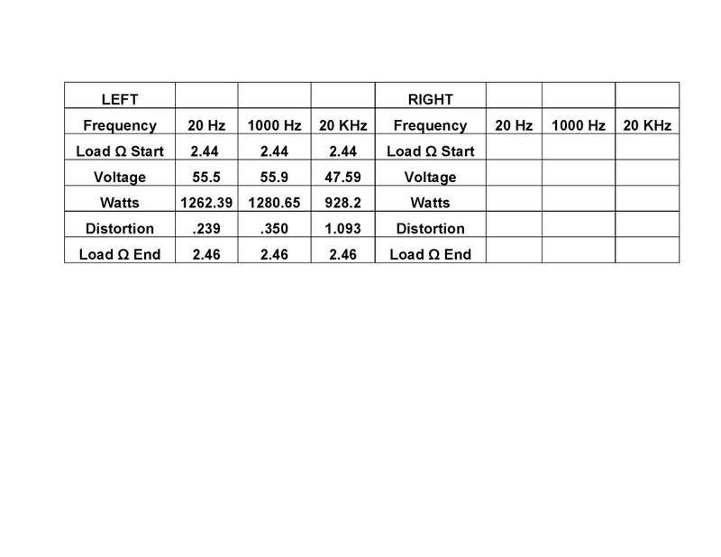

We have a Techron 8506 'Gradient Drive Amplifier' provided by Ricci. For those of you that don't know or are unaware Techron is/was the industrial/laboratory division of Crown International. These amps are huge! I estimate that one of them weighs close to 100 pounds. The manual provided with the amps is for a 7560 but the labal on the amplifier states that it is an 8506. So, I set them up and measured them (there are 2 mono units).
chasw98 is offline

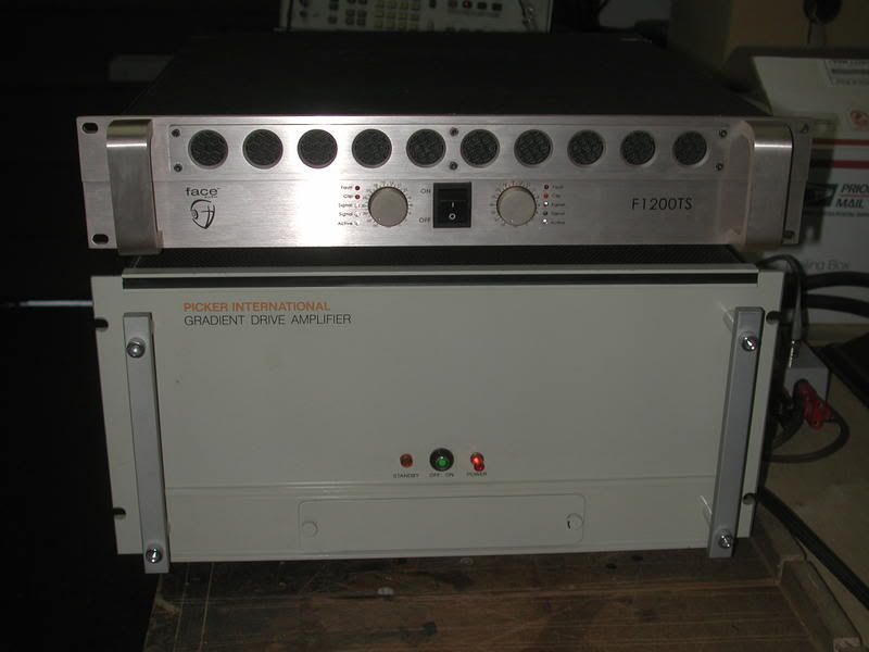

And a size comparison picture..............
chasw98 is offline

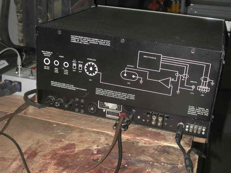

post #1154 of 1921 Old 07-06-2008, 10:37 AM - Thread Starter
chasw98's Avatar
Location: Margate, FL
Posts: 1,087
Rear view.
PS: The date on the manual is October, 1988.

Can we expect the Face amp tests later today?
And good FR, pretty solid power output from that Techron. What are its manuf specs?

Hey...not bad! I'm kind of surprised that they did so well. Pretty much matches the specs for it which I think were 600 / 8ohm, 1000 / 4 ohm and 1250w at 2ohm. FR and distortion looks decent too with a bit of deviation at HF. SN ratio isn't the best though. This is the old school, overbuilt , brute force kind of amp.
Chuck,
Did you test both and they were really close, or just one? Any hiccups during testing? Blown fuses, etc? How bad was the amp sucking the line voltage down?
The Face will be done later this week. I am about half way through the testing and recording of the measurements.
I have a manual with one Model number on it and an amplifier with another Model number on it, so I am not sure what the specs are.
Chuck,
Yes, both were tested and both measured almost identical. No hiccups at all. They are rock solid old time big heavy iron amps. No blown fuses, but a bunch of heat out of the top and the fans would kick in regularly. Voltage was not sucked down, but they were running on a dedicated 30 amp circuit and would draw close to 20 amps.
Here's the specs on the AETechron 7560. I can't find jack from either Crown/ Amcron/ AETechron about an 8506 model
http://www.aetechron.com/7560.html
Physically, the amps I have look close to the amp pictured in the drawing. The specs are probably very close to the amps I have and they only vary in minor ways such as (1) No meter or provision for meter on the front panel, (2) 1/4" jack instead of BNC on rear.

Originally Posted by Canadian_Dude View Post
Can we see the inside of that big sucker?
I will try and take a picture of the inside of the amp. They are very heavy and hard to move around, so I only plan on moving them to crate them up and I will try and take a picture then.
