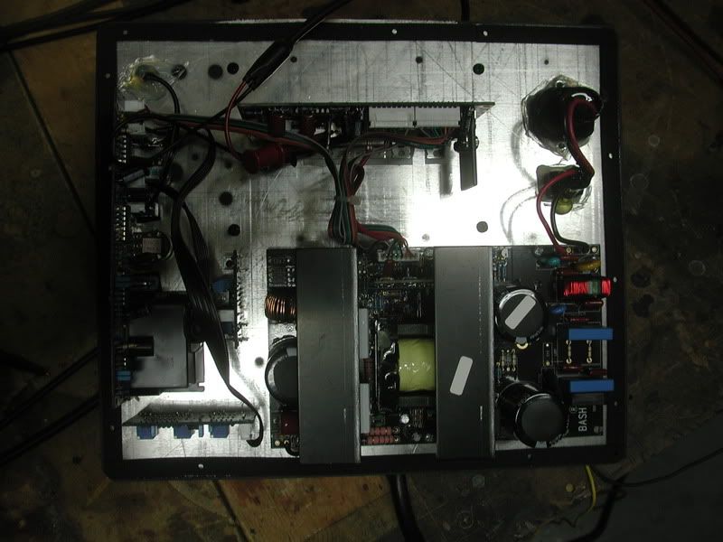

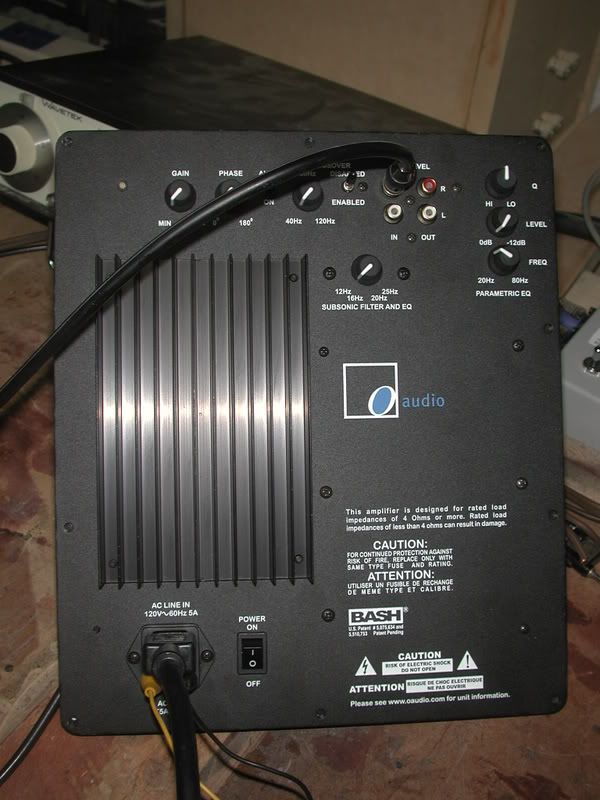

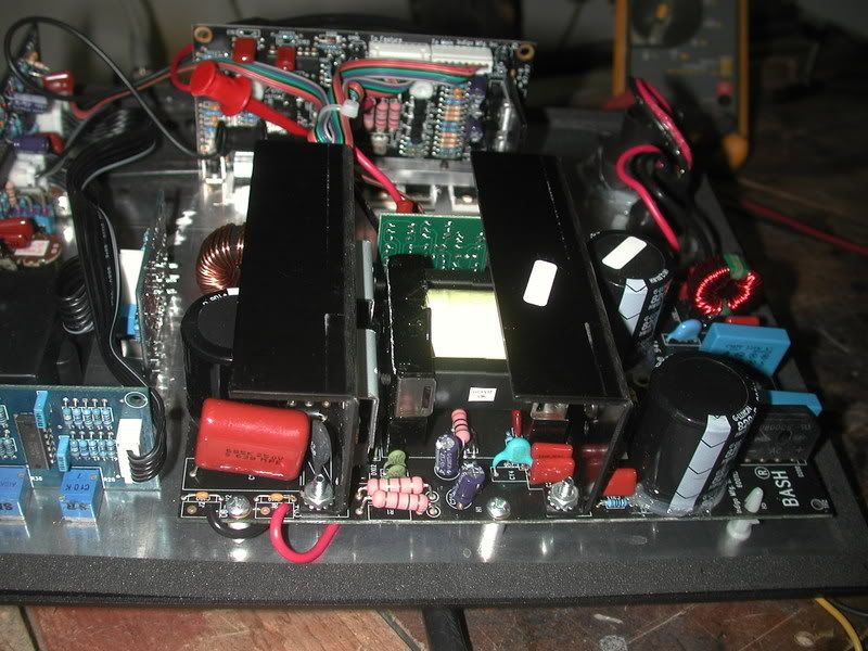

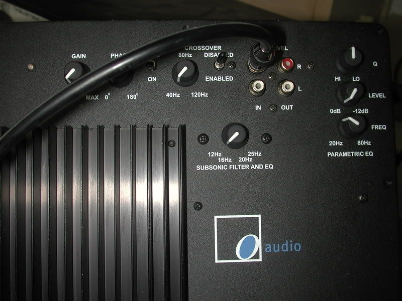

Tonight for your listening pleasure we have an 'OAudio 500' BASH plate amplifier. I would like to thank JoePerri for sending me his brand new amp to test. Thanks Joe! I will have to say from the start that I like this plate amplifier. It can be bought for $229.00 + $10.00 shipping from www.oaudio.com and packs a lot of punch for the price. This was the plate amplifier that was used in ssabripo's first DIY subwoofer that we built together. That being said, here are some specs and test results.
Controls
Close up controls
Rear PC Boards
Closeup Rear PC Boards

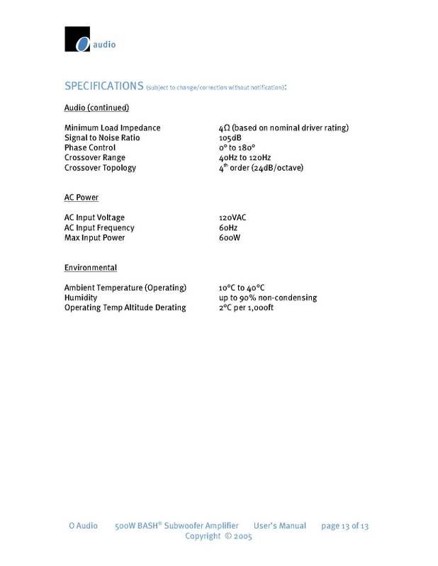

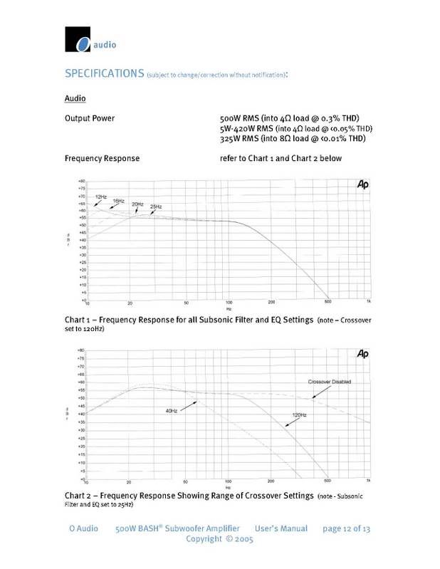

Now here are the specifications and the tests.
Specifications page 1
Specifications page 2
Test results

Let's see..... the first thing I'll hear is 'It doesn't even meet specifications' and 'Those aren't great numbers'
and 'It doesn't have flat frequency response.'
You're right. It also only weighs less than 10 pounds soaking wet and costs $239.00 delivered. If you look at the controls, you will find features that don't exist on comparable PE plate amps. The quality of assembly and components used are very good. Yeah, it's made in China and OEM'ed to OAudio but it has good quality and decent specs.
It has a soft clip circuit that reacts when a steady state sine wave (or music) is applied and brought up to full power slowly. I could crank it up quickly and watch it peak without clipping but I could not get it to run at a steady 80 Hz at full power. You could see the waveform being 'adjusted' electronically. Now, for a 500 watt plate amp, this is a good thing. You can see from the current reading in the last image that I am drawing 4.94 amps. The fuse is rated at 5 amps. (I got tired of buying fuses and just put the current meter in line to monitor the draw.)
The fact that I have heard this amp work in a well built cabinet with a great 4 ohm 15 inch driver is what I base a lot of my praise for the amplifier on. This amp was run right with sherv's old SVS Ultra and it bested that sub easily. So, even though it only gets close to meeting specs, it has some power behind it. And it's efficient. For a plate amp, this is one of the better ones. Thanks again to JoePerri who shipped this to me from California so that I could test it.
Chuck

I agree watt per dollar is good. I also think that the 6db rise in the frequency response as you reach down to 10Hz is probably a designed feature rather than a fault. Remember this is an amp dedicated to be used as a sub amp.
I've seen a low frequency boost built into other plate amps. They even suggest or will allow circuit changes to be made to gain that 6db rise.
I'll bet if you examined the amp's circuitry you'd find a Linkwitz Transform or an ELF as part of the design.
