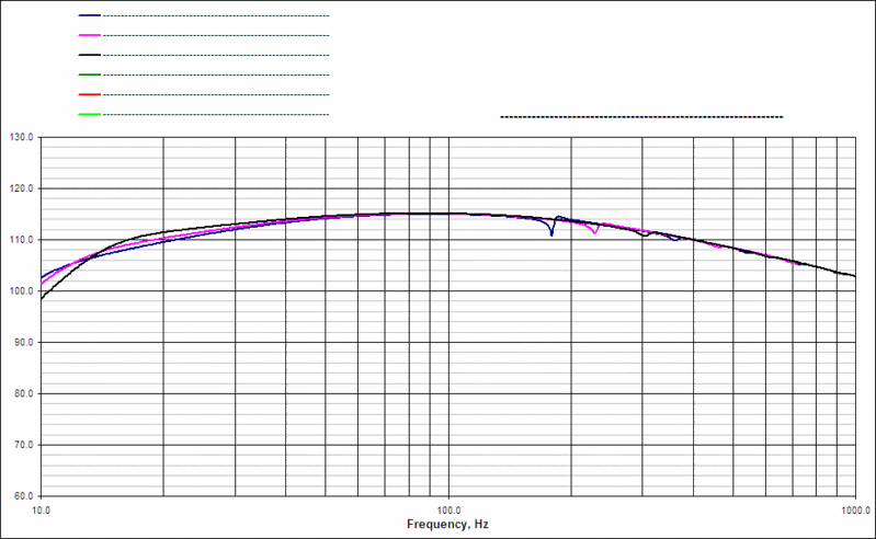

You only need 2 sheets of 3/4" MDF to build this box.

How about adding a FR simulation given the box size, tune, etc....
Blue = 11.5hz
Pink = 13hz
Black = 15hz
@ 350w

I like this much better
BassBox Pro TC 3K.pdf 111.6396484375k . file
