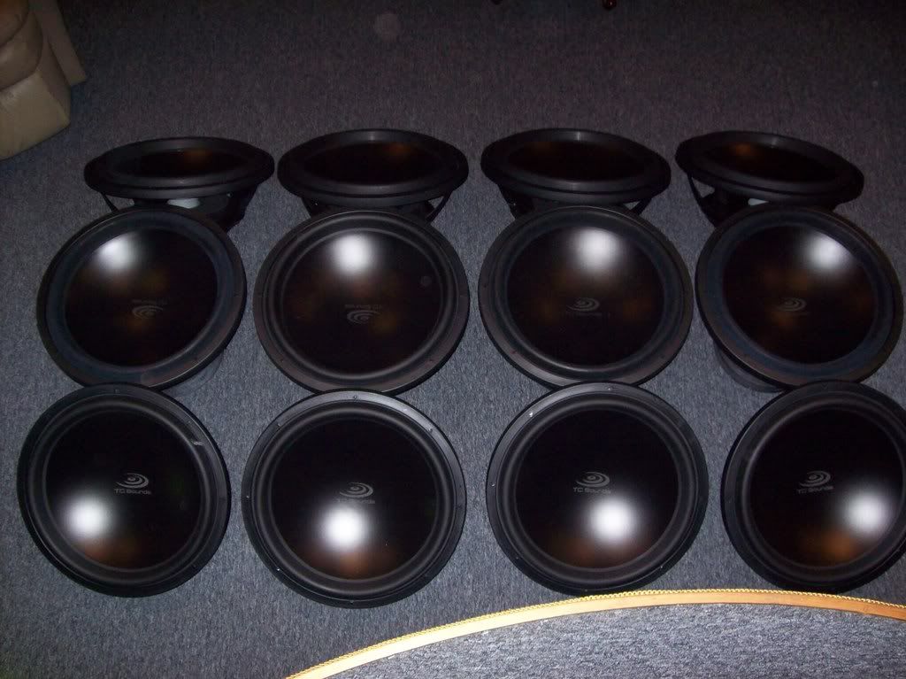

I just opened all of the boxes and!!!!!!!!!!!!!!!!!!!!!!!!!!!!!!!!!!!

Forgive me for the pictures being all over the place, but I am just learning how to use these digital cameras and the photobucket.
robertcharles is offline
post #107 of 1768 Old 11-29-2007, 12:42 AM - Thread Starter
robertcharles's Avatar
Location: New Orleans
Posts: 1,607
Well, it seems that I figured out how to post the pictures, so if anyone is interested, I will start to post the pictures of the build as soon as I get this thing going. I was on vacation for the last two weeks, and getting back to all of the work has been a big time consumer. I posted the pictures so I might get a little kick in the butt from others to get this thing going. Tell me what you think.
Thanks to all,
Robert
Hey Dan, Thanks for the design help. I am going to give it a real good shot and take my time with it. I really appreciate the help.

excuse me while I go change my pants!!

Robert,
Have you considered running in the "Primaries?"
WOW!!!

Now that's what I'm talkin' 'bout!

I see that the hour grows late... and we may be in no position now to stop the evil genius Mr. Robert Charles from assembling his diabolic creation...the "GIRTH A TRON!!!"
With it he will seek to complete his unholy quest of WORLD DIY SUBWOOFER DOMINATION!!!!

Holy **** that is amazing.

SPEECHLESS.

4 18" 5400's powered by 2 qsc rmx 5050's
See what happens when you don't open them up right away... They multiply!

That's quite the collection of drivers. I can't wait to see the enclosure you're building.

I'll trade you my RL-P18 for all of that.
