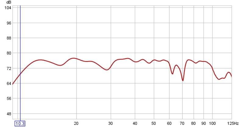

post #1690 of 1768 Old 11-24-2009, 03:34 AM - Thread Starter
robertcharles's Avatar
Location: New Orleans
Posts: 1,607
btw, i'm not look'n to pick nits. just curious what you were seeing.
Do you mean my impression of the graph?
robertcharles is offline
post #1691 of 1768 Old 11-24-2009, 03:43 AM - Thread Starter
Posts: 1,607
Here is one of the graphs.
Photobucket
I was fairly happy with the outcome of the graphing sessions I had since the graphs really fairly tracked what the winisd program calculated when I was planning. But, when I posted my grahs, I was not met with any really good comments, so I guess there is something wrong or off in my measurements or design. Any thoughts?
Robert
post #1692 of 1768 Old 11-24-2009, 03:47 AM - Thread Starter
Posts: 1,607
IMG]http://i228.photobucket.com/albums/ee292/robertcharles123/averageofallmeasurestodayatcenterca.jpg[/IMG]
Robert

post #1694 of 1768 Old 11-24-2009, 04:03 AM
LTD02's Avatar
Join Date: Oct 2003
Posts: 20,469
Mentioned: 478 Post(s)
Quoted: 2495 Post(s)
Liked: 2830
it's coming through a-o-k robert,
holy crap. that looks awesome robert! what is all the banter about???

post #1695 of 1768 Old 11-24-2009, 04:10 AM - Thread Starter
Posts: 1,607
Because of the roll off at the low end. In the position my cabs are in, I do not get the massive room gain in the listening position down low. Although it seems that the bass levels are absolutely phenomenal at the screen area. I am going to move the cabs forward soon. I have a few friends lined up to help move them and we will see what happens. I am very happy with the sound as is, but I would like to see if there is a way to get that magical flat line to single digits. I would also like to experience one of these systems for myself to see what or if I am missing anything. All I know is I am happy with the outcome of my build so far. It can only get better as I finish the HT upgrades-amps and electrical and placement.
post #1696 of 1768 Old 11-24-2009, 04:17 AM
LTD02's Avatar
Join Date: Oct 2003
Posts: 20,469
Liked: 2830
the null points are most likely room artifacts that could be at least in part amelioriated with some good bass traps. http://www.gikacoustics.com/ the nulls are high enough up that bass traps of reasonable size may actually help. gik may be able to help you out for a couple hundred bucks...chump change in your system. most every room has null points. not every room has the headroom of yours. overall, yours is definitely a top 5 of all time on avs (though with all the recent horn builds, you will have some competition). :-)
Listen. It's All Good.
LTD02 is online now
post #1697 of 1768 Old 11-24-2009, 04:24 AM
LTD02's Avatar
Join Date: Oct 2003
Posts: 20,469
Liked: 2830
oh, i see. well, a drop in frequency response that low is just something sucking the energy out of your system. plug up your windows, doors, hvac...trade your wood flooring for concrete and your drywall over studs for solid rock and you will get down to single digits no prob. however, your modal peaks/dips will become worse, so overall, who knows if you will be ahead or not. ok, that was a long winded way of saying that low frequency dips are energy losses and that may not be a bad thing.
LTD02 is online now
post #1698 of 1768 Old 11-24-2009, 04:33 AM - Thread Starter
Posts: 1,607
oh, i see. well, a drop in frequency response that low is just something sucking the energy out of your system. plug up your windows, doors, havc...trade your wood flooring for concrete and your drywall over studs for solid rock and you will get down to single digits no prob. however, your modal peaks/dips will become worse, so overall, who knows if you will be ahead or not. ok, that was a long winded way of saying that low frequency dips are energy losses and that may not be a bad thing.
I did a little experimenting the other night. I played some sine waves and the Danley fireworks. this was the first time I actually put myself in the front of the room when program material was being played. The "feel" was very intense. It felt like the floor was "waving" under my feet and the pressure was probably too much. But, in listening position, the sound and feel seems more natural and probably more like it would be outside without the room gain involved. Definitely a different experience going from listening position to screen area. The more I think about it, I might be better off as it is, but I would like to have options for the free lunch everyone is talking about
post #1699 of 1768 Old 11-24-2009, 04:45 AM
LTD02's Avatar
Join Date: Oct 2003
Posts: 20,469
Liked: 2830
did you see that i caught the danley fireworks clip as clipped? bogons apparently were at work. td indicated that he would repost the non-inverted, non-clipped file shortly.
low frequency sound typically builds near walls and corners, so that is probably what you were feeling.
if you want a little bump in frequency response to nudge your system into single digits, why not just put in a little eq? surely your system has PLENTY of headroom for a little boost down low. personally, i'd say you have things locked up as is.
LTD02 is online now
post #1700 of 1768 Old 11-24-2009, 04:54 AM - Thread Starter
Posts: 1,607
Thanks for the encouragement. It would be nice to have a few people who actually know what is what to personally hear or feel my setup so I could get some direction. Hopefully, some interst can be generated for a GTG. I was hoping to be done with some things around Mardi Gras. Maybe that could entice some interest for a really really southern GTG. I would be more than glad to put it together. I would also like to get that Danley sub in the mix so everyone would be able to get a peak at it.

post #1702 of 1768 Old 11-24-2009, 07:00 AM
Ricci's Avatar
Location: Louisville KY
Posts: 5,341
Mentioned: 101 Post(s)
Quoted: 246 Post(s)
Liked: 573
Rob,
You won't get that flat to single digits response without sealed subs. You have a resonant alignment with a 14hz tune. It will drop off from there. You don't want to boost below that point either. I would not worry about the <10-12hz stuff.
Also your graph appears to have a lot of smoothing on it. Looks good otherwise though.
Ricci is offline
post #1703 of 1768 Old 11-24-2009, 07:31 AM - Thread Starter
Posts: 1,607
Originally Posted by Ricci View Post
Rob,
The graph is all I have since I rebooted my computer, but I do know it is listening position. As far as the alignment, I planned on doing some sealed and testing the waters with that to see if the graph changes at all. I am not going to be building anything with such detail, but the drivers will be of the right kind and the volume of the box will be correct. If I get the same sort of response curve, then I know the room is at fault. I definitely want to do some kind of A to B comparison in that room with what I already have to see what comes of it.
