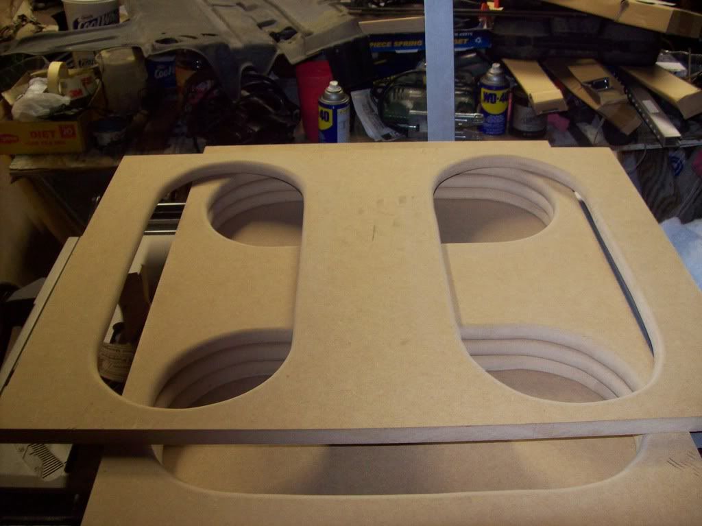

Nice Robert. I like the roundovers on the inside edges.

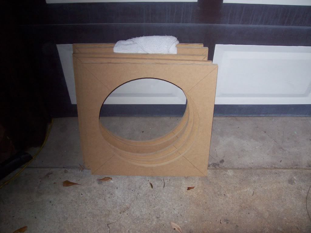

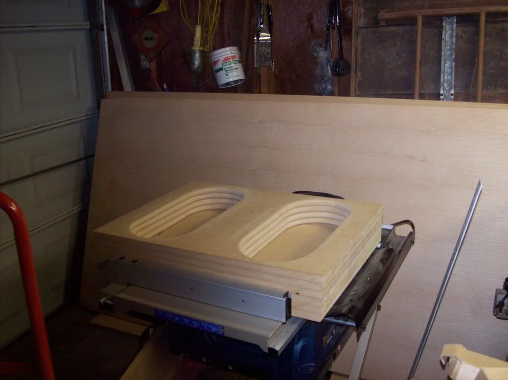

I'm getting motivated with this. Hopefully, I will get more confident with the 2.25 inch thick driver cutouts. I wanted to try the difficult horizontal braces with the funny cutout first to see if I could get decent cutouts, and, I think they are pretty acceptable. Hopefully, I will be able to do the driver cutouts after a little practice with the jig.

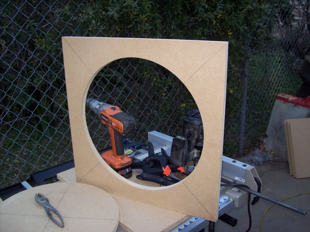

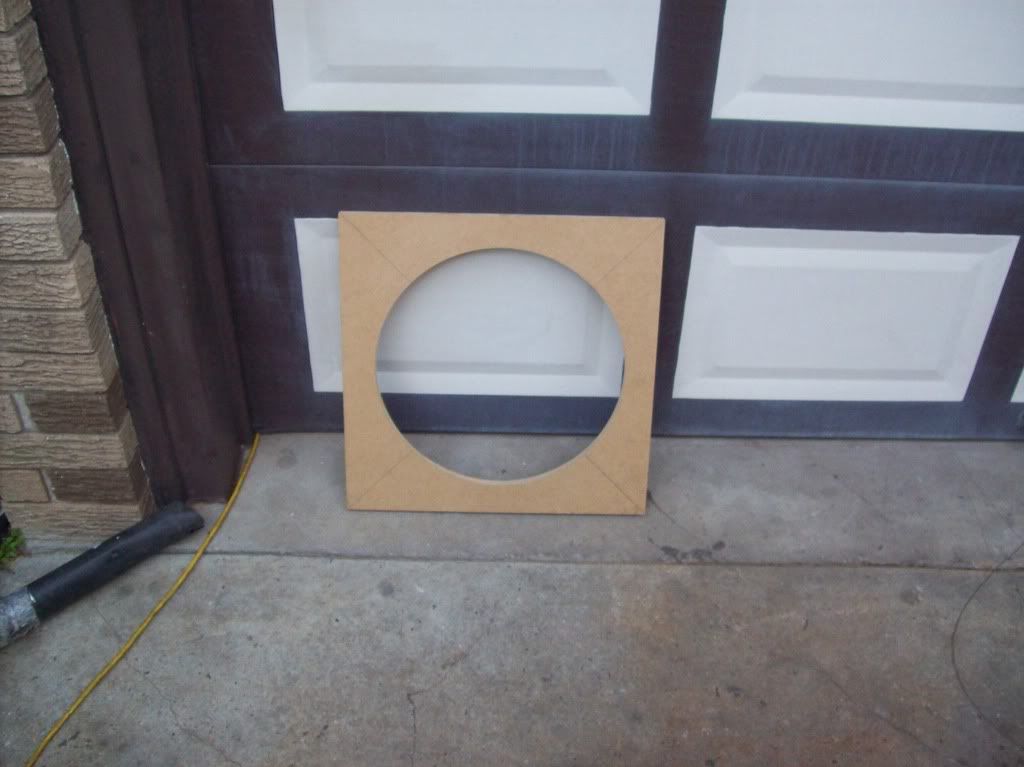

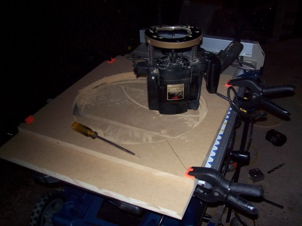

Pictures of my first attempt using the jasper router jig. I really like this thing, and if you clamp the work and the circle to be cut, this thing really works fantastic. I wish all of the tools worked so well.

five more pictures.

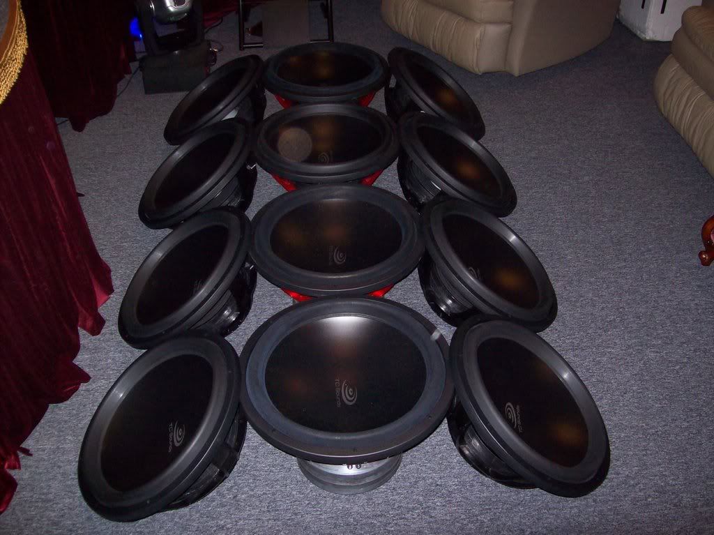

Posts: 4,421
this is like the holy grail of subwoofer pr0n, kinda like finding the ultra rare, impossible to find Jessica Alba sex tape (not that it exists) and posting stills of it for us all to drool over.

Posts: 1,404
Seriously.
I would give up alot of things for those drivers..

I am really hoping that the finished product comes out as good as that jasper jig creates cutouts. Man that is fun to do. I just bought the last 8 sheets of material for a total of 15. I do have a lot of waste do to the odd sizes of some of the panels. I really think that manufacturers build the subwoofers based on the least amount of waste involved. It would really increase the price per sub drastically if they built things like this. Not to mention the weight. Just the inner layer weighs almost 175 pounds, and I still have the second layer and the third layer of the baffles=not to mention the 200 or more pounds of drivers and passives. It is going to be a really heavy monster.

How did you do the roundovers on the cuts? They look very even so I'm guessing it's not freehand.

jasper jig for the cutout and freehand with a 1/2" roundover bit. Comes out great with that jig.

Nice freehand work. I'm using the jasper jig to cut circles as well. Thanks.

"Nice freehand work."
It's hard to go wrong, other than burning; roundover bits have a ball bearing guide.
