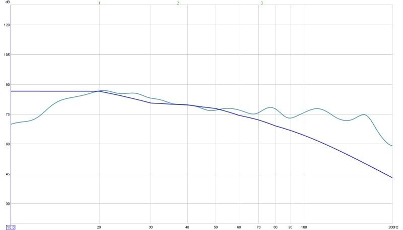

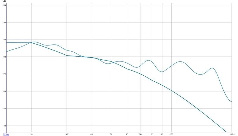

Well, I apologize for the late response but my company did a big lay off and shut down a lot of sites so I am now jobless grrr
Anyways, the BFD has made some great improvements. It is very easy to learn after reading a little. I manually configure the filters in REW and then input them by hand into the BFD.
Here's a quick graph of my post EQ with a hard knee curve added in with the mains on (I run the LFE a little hotter hence the mild drop after 80hz):
The hard knee I achieved was by going off of my hearing to see at what SPL 20 Hz sounded the same as 30 Hz, 40 Hz, etc. I took the difference as instructed in the DiY and came up with these values:
20 11.5
25 8.5
30 5.7
35 5.3
40 5.1
45 4.4
50 4.0
60 1.7
70 1.0
80 0.0
To me Wayne's approach completely makes sense and it does sound a lot better then EQ'ing to a flat response. I used 3 filters to accomplish my goal. The filters I used are:
Freq Gain BW/60
20 7 10
37.02 -9 9
71.50 -5 6
This was my first attempt. I haven't played with it anymore to lock it in more. I am more concerned with finding work. Looking at it...maybe I should reduce the last filter to maybe -2db or -3db though? As for the gains, don't worry at the levels I play these at I have a TON of amp headroom and excursion to go.
When I have time I will try to learn how to use the other functions of REW.
If anyone wants to see a specific graph I can post them I just don't know how to interpret them (such as the waterfall, RT 60, etc.). If there is something you notice I don't please do not hesitate to say something. Like my title says I am still learning everyday.

Location: Nor^Cal
Posts: 576
Here's what the graph looks like when set to Wayne's parameters (which is how I set the filters):
Looks much better through the crossover section.
-The Dave
