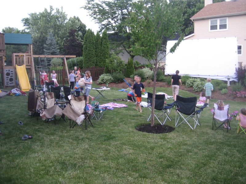

Wow - the material worked absolutely great! I had one small issue that I can correct for next time - I have a very small space between the two central 4x8 panels. The space can be seen through the 120" spandex, so I still saw a vertical line running through the image, although it wasn't a stark seam that was there before. I just need to double up across this space, and I should be good to go.
I shot some video the other night which I will post, but here is an image of the screen. I am looking for a better solution, but I am using 1 inch black binder clips to hold the material up on the screen.
