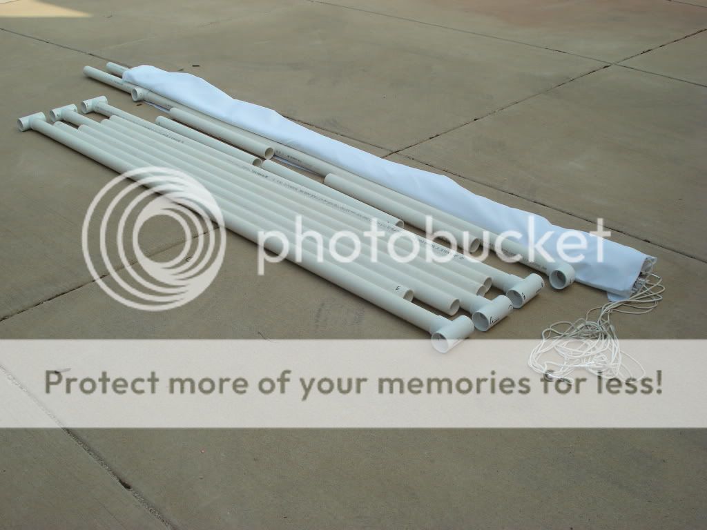

I'm all about the PVC for the frame. Cheap, easy, light, and if you make a mistake (as I did) cheap and easy to fix. So, this frame is a PVC frame. The overall frame is simple, five vertical pipes and the top and bottom horiztonal pipe. Since I have the 4x4 posts to support the frame, I didn't need much for strength, the frame is just designed to hold the fabric.
Here are some pics of the PVC frame.
First, laying out the pieces and then doing a dry fit test.
I know that some folks don't like to use power tools on PVC, but I do. Cuts through the pipe in seconds, and is a nice flush/square cut. So all my cuts are with a table saw.
In my design, I have some joints that are glued, and others that are not. So, my next step was to glue the fixed joints. During one of the joints, I had to sneeze and the fitting was set before I finished sneezing.... and it was of course set in the wrong spot.
This is why I like using PVC. A cut cut and that piece was out, a few dollars for a new fitting and all was as good as new... I marked the joints that are not glued together so they would be easy to match up during setup.

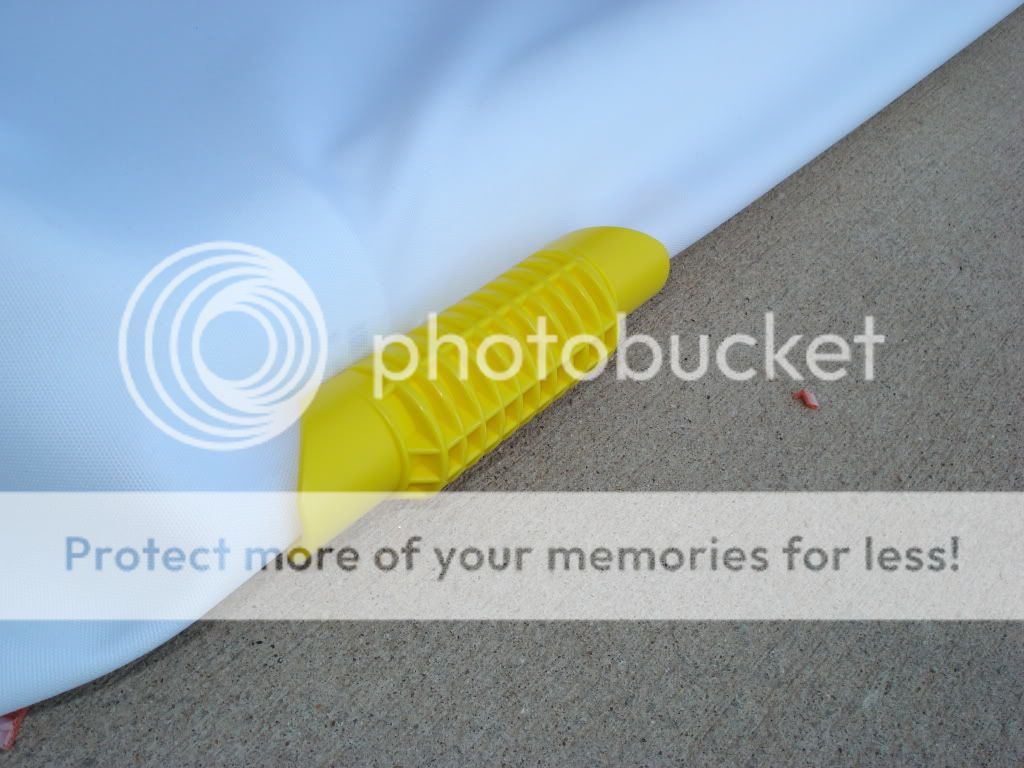

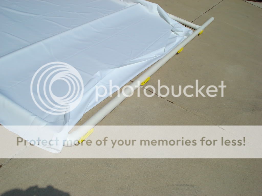

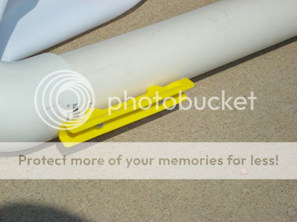

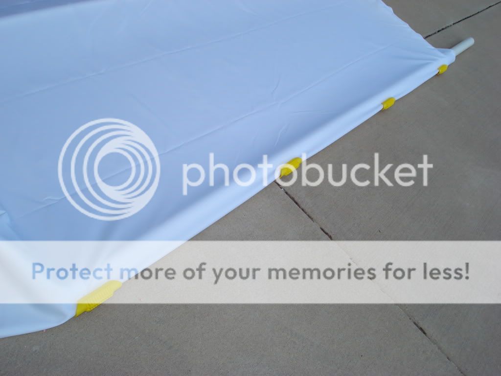

I knew that I wanted the material at least partially fixed to the frame. I found it much easier to work with my last screen because of this, so I wanted to continue that. In this design, the sides would be fixed, with the material attached to the frame.
I had used the grommets before, and then screwed through the grommet into the frame, but those other grommets were the ones you had to punch out and hammer, etc... not impossible, but I wanted to try something new. So, at Menards I found these tarp clamps.
Basically, you install the clamp, then slide the material over the clamp, and then slide the other half of the clamp over the material. They have been around a while, nothing brand new, but not sure I've seen them used this way before and thought it might work out well.
So, here is attaching the first part, called a dogbone.
I used four dogbones per side. The screen is about 9.5' feet tall, and this seemed like plenty, after use it was just fine.
Next, I slid the material over the dogbones, and slid the second half of the clamp onto both the material and dogbone. Pretty easy here, the only key is to make sure the material stays lined up, but that is pretty straightforward.
Here is a close shot of the whole thing, after install. I didn't get an angle on it, but there are two screws going through the plastic and material, into the PVC to hold it tight.
I then went and repeated this on the other side. I pulled the material nice and tight (the frame is assembled under the material while doing this part, and attached the other four clamps. It went nice and easy. Since there is a little bit of give in the material, especailly being 22 feet wide, I can pull the frame apart with just a bit of effort.
After that, the screen frame is done. So I disassembled it and got it ready to take down to the spot where we watch the movies. Basically, the horizontal pipes come apart, and the rest is fixed. Here it is fully disassembled.
