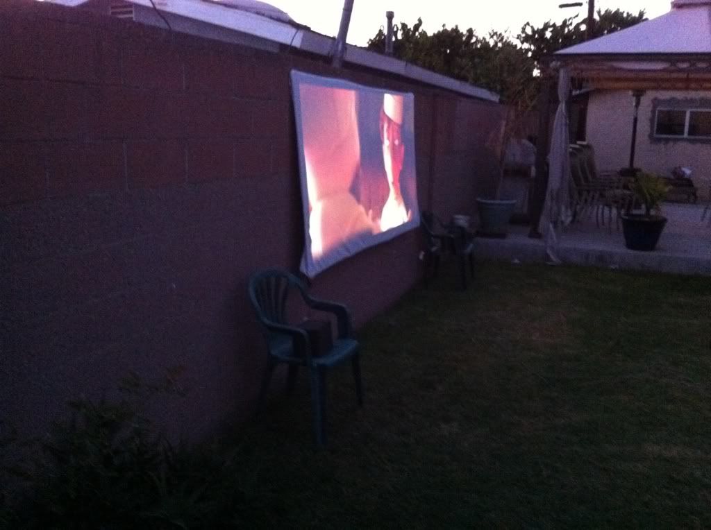

ran new tests last night. the full movie ratatouille, then small segments from various other movies.
first test last night was to see what time it gets dark enough to enjoy a movie. we thought 7pm would be good. but didnt work out like that. we started ratatouille at 7:30pm instead. dark scenes were "turrible", any scene with bright whites was somewhat enjoyable.
took this pic roughly at 8pm.
from a side angle, movie still looked great
closer view of the entirety of the setup. speakers are on green lawn chairs against wall. receiver, blu-ray player, and projector on small table.

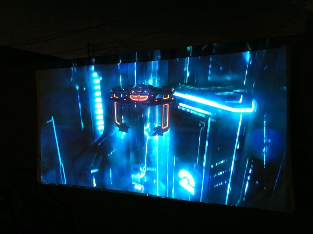

ratatouille at approx 9pm
tron legacy, approx 10pm

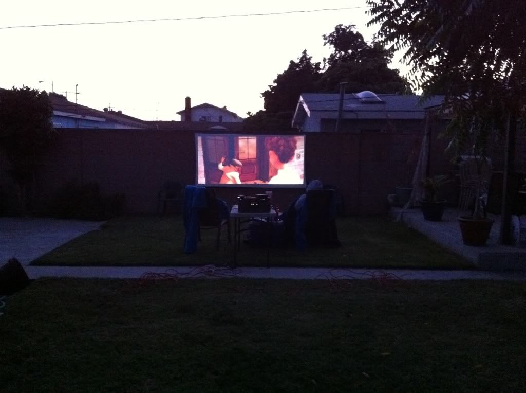

saturdays OMN #0 was a success. guest list was short. food was good. everyone enjoyed themselves.
already planning OMN #1.... for this friday :P
no kinks were noticed during #0. movies played were Cars (for the chillin's). then it was supposed to be Speed Racer, but everyone wanted Rango. began Cars at 8:30pm. finished Rango about 12:30am. there was a 15 break in between both movies to make more yummy hot chocolate.
there were none of those ads and videos and stuff i mentioned i wanted to do due to time constraints, but i now have amassed a great and varied selection of material. i was hoping i could copy all to my iphone and use imovies to wrangle something up but turns out imovie doesnt even see all these videos! tried out windows live movie maker and i want to rip my eyes out! i need some video production program recommendations. and i dont use any macs. help a brotha out!
here was the general layout of OMN #0. not to scale. it was much roomier.

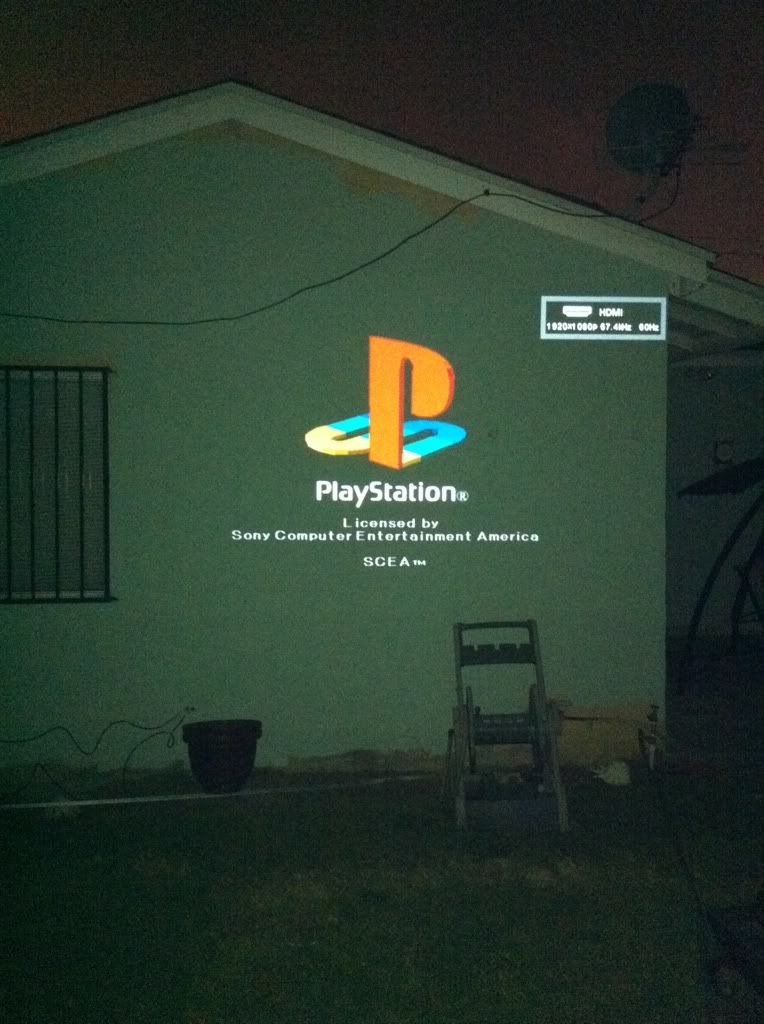

tonight i will do an experiment and project a test movie image upon the big side of our house. just to see how big an image i can get. if possible i may just order a vinyl screen from SHMO's supplier. gotta def. fix them big speakers. they'll free up the smaller speakers for rear surround duty. bonus: i found the center speaker for this setup! 5.1 is all this can do but its enough.

this was a test of Ciné-Tron BA (Big Azz) Alternative Screen Setup (A.S.S.)
the wall was recently painted a light green/blue (more green than blue). not optimal but projector had settings for different colored walls (which i didnt mess with). sorry for the small S word during the vid.

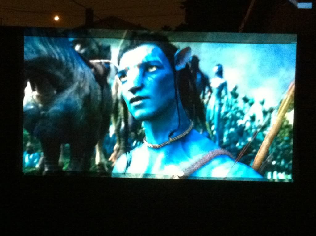

after this vid, the wife and i moved the projected image from the full width of the wall (which i didnt measure) to begin from the rightmost end of the wall to the start of the window bars. its a smaller projected image but approximately twice the size of our currently built screen size.
this was a game test
the greenish hue on the whites is obviously due to the walls color.

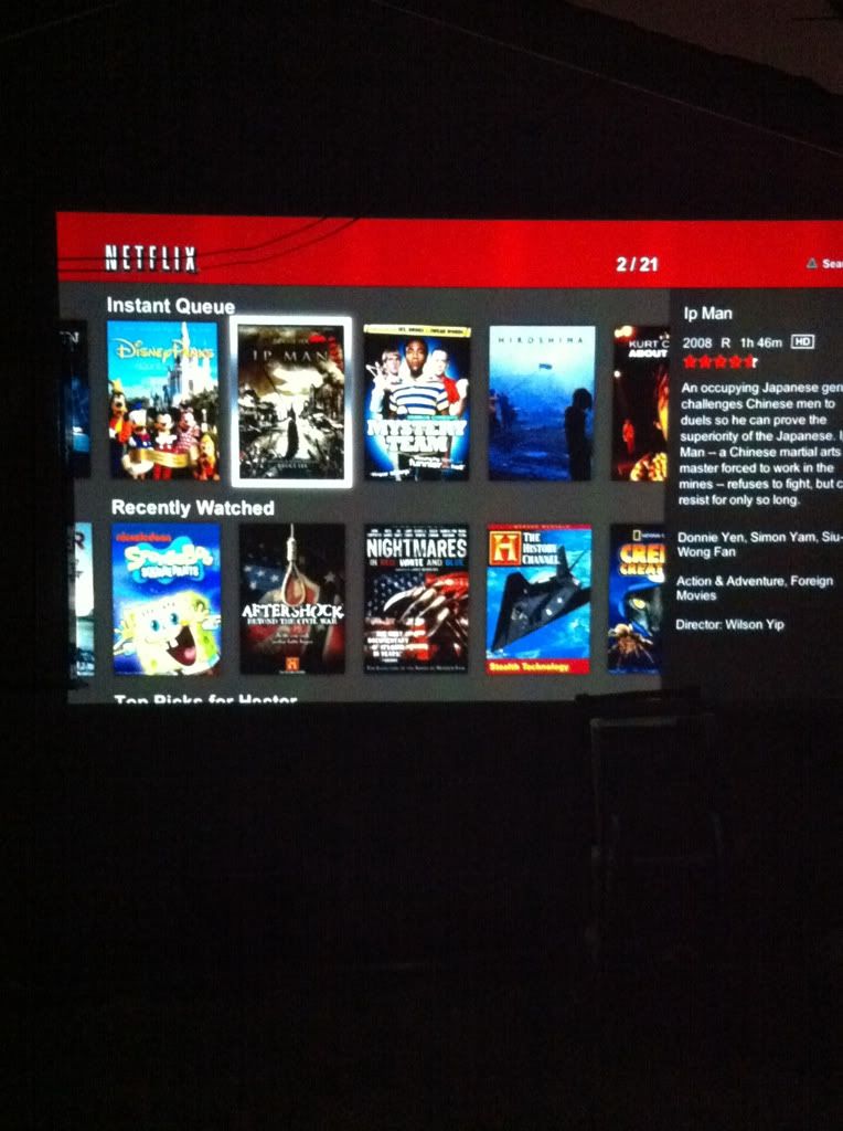

this was a wireless streaming test from my network via PS3 Media Server. 480p source material and 720p source material played back without stutter, however 1080p material would have small (very small) pauses. pausing the 1080p stream for about 10 seconds would let the material buffer for about 30 seconds. im thinking i want to hardwire outside :P
this test video was 480p source. some pixelation is definitive.

this is wireless streaming test of network sourced music streaming via PS3 Media Server through my PS3
pics
this was the basic setup. the projector has a tiny speaker and thats where i was getting the audio for all these tests. that way i didnt have to setup all the speakers and receiver and all that jazz. projector and ps3. and home pc (inside house) serving media
this was the screen/back wall. the recent painting was 100% complete (will be soon). this is the projectors in-built test screen. i went bigger with the projected image after this :P
some tom and jerry cartoon. specifically "Texas Tom", i had this episode (ripped from a self-owned DVD collection) on my PS3 almost since when i bought the PS3!
the waterboy (dvd) title screen.
netflix (via wifi). surprisingly no stuttering. the usual first seconds are blocky but the system buffers up by 5 seconds at most and image definetly improves after that... and YEAH that is Spongebob... wanna fight about it?!?! :P

this screen shows the Playstation 1 load up screen. its for FF7 (downloaded title). more importantly it shows the small area i mentioned i was projecting to. from the right most end of the back-wall to the start of the window bars (plus a messy back wall and paint job :P)
