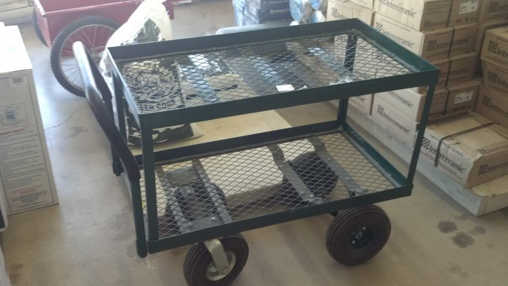

being that my space is so far from my house I think I may be better off with some sort of mobile setup.
I've found this cart
I think i might use something like that.

for OP: a mobile setup sounds cool and i also vote for checking BYT for mobile setups they already have as well. that cart would be more than enough. you still need power out there so maybe just some long extension cords? for a better look though, diggin 2 ditches would be ideal.
