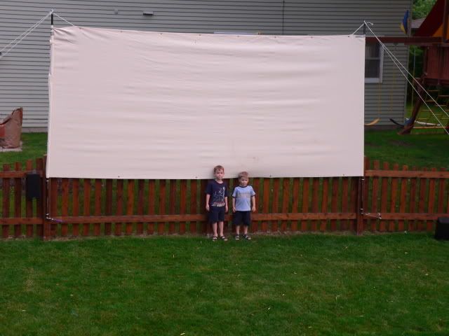

post #34 of 56 Old 07-27-2007, 07:45 PM - Thread Starter
warrenP's Avatar
Join Date: Jul 2005
Location: Now in Colorado!
Posts: 1,822
Liked: 60
OK, I'm thinking of making a new screen. I love the one I have now, but I'm thinking of going "scope" outside. My ideal is to make a screen that is 24 feet by 10 feet. I just need to figure out a good way to do that. I'm used ot the screen system I have now, it is so easy and fast...
Anyone know of a good screen setup/teardown that is big like that?
Every man dies. Not every man really lives.
warrenP is offline

post #36 of 56 Old 07-28-2007, 02:56 PM
psennett's Avatar
Join Date: Aug 2005
Location: Geneva, IL
Posts: 404
Our setup is 6' high x 15' wide, and we used 1.5" PVC pipe. Originally, we just built it and glued the screen-frame all together:
*========T========*
T========+========T
That's an * for every 90 degree fitting, a T for every T, and a + for the four-way X at the bottom center. So the legs (not shown - just 4' long pieces of PVC) were removable. The problem with this gig - storage.
I re-worked it so that all of the vertical pieces are glued solid (legs included), and the horizontal bars are removable (just pressed into place). Broken down it ends up being three 10' vertical legs, plus four 5' horizontal bars - much easier to store. Since we're just using coated celtic cloth, wrapped around and cinched up tight on the backside, that gives horizontal stability to it. The legs and whole thing just slip over three 1" pieces of metal conduit pipe, pounded into the ground.
Pictures here.
What I don't know is how that would work at the bigger scale you're suggesting. I suppose I'd start with using larger PVC, like 2", and maybe increasing the verticals to four or more. Not sure if you'd need another horizontal crossmember, or if the larger PVC would be sufficient to maintain rigidity.
Patrick
Wow, did the basement really take four years to build out?  It seems like fifteen minutes.... under water!

WarrenP: I just went through your theater build--very clever for your screen. It looks very light and appears to store quite easily.
Right now, my screen is a very heavy canvas stretched between two very heavy steel poles that are attached to my backyard fence, then stretched taut with guide-lines (this picture is actually bit outdated, because I now use bungee balls along the bottom to tighten the screen up even more.
But man is the screen heavy, and very difficult to do by myself.
I am toying with an idea to use 4x8 sheets of foam insulation from Home Depot ($13 a sheet)--it's pretty dense foam with sheeting on each side (one side is silvery, but I think would cause some hotspotting because of its sheen). But anyway, it's pretty stable for foam sheets, and if I could figure out an easy and light way to frame it, I could easily make the screen 4 of these sheets side by side (they could easily be paintable with a primer for the screen material). There would be a seam between the four panel, but I think I could probably minimize that somehow (tape over the seam???)
I have noticed, however, that imperfections in the screen rarely show up on the movie at fully dark. My screen right now is heavily wrinkled and stained and none of this shows up during a movie. I wonder if any seams would...?
One other idea--instead of taping the seams, how about a cloth flap that is adhered to one of the panel and then lies flat against the other panel covering the seam (or use velcro??)
But anyway, WarrenP--since these are 4x8 sheets, I don't think you could use them for 23.5x10...But you could easily do 19x8 (use 5 panels, and even paint a 1 foot black border on the left and right...)

I am looking at a series of patch cords to make the garage extravaganza work. USB extenders for the Wii microphones for my girls, 50' RCA cables for the audio, spare power brick, spare Wii video cable, Component to VGA breakout cable, coupler, maybe a miniPhono to RCA adapter, Blu-Ray player, couple of HDMI patch cords and a spare Wii sensor bar. The idea is to have everything behind the screen (well not BEHIND it, that would create shadows) so that the driveway is free from obstruction, except for the band instruments in DriveWii mode.
Other than the anticipated harassment from the HOA, I think the neighbors will love it. It's a great use for my old JBL speakers. I might take the Klipsch speakers off the wall in the garage and actually set up surround sound if this takes off. Won't be hard.
Haven't decided if I am going to get the front projection screen material as well or not. That would make backyard theater more realistic. However, sun and wind in my area would require waiting until after dark and a lot more tethering to secure the screen.
Anyone use the Da-Lite fast-fold screens? Tips? Thoughts?
