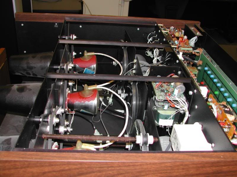

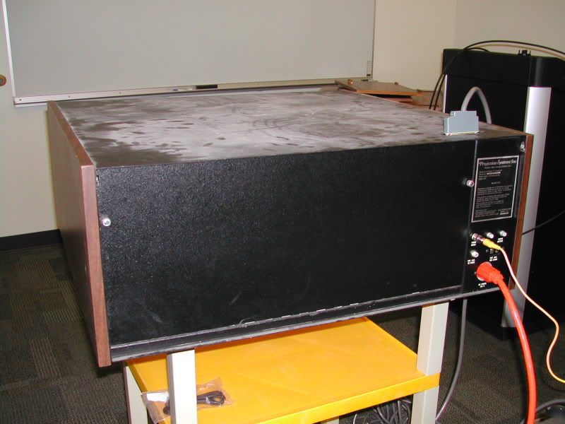

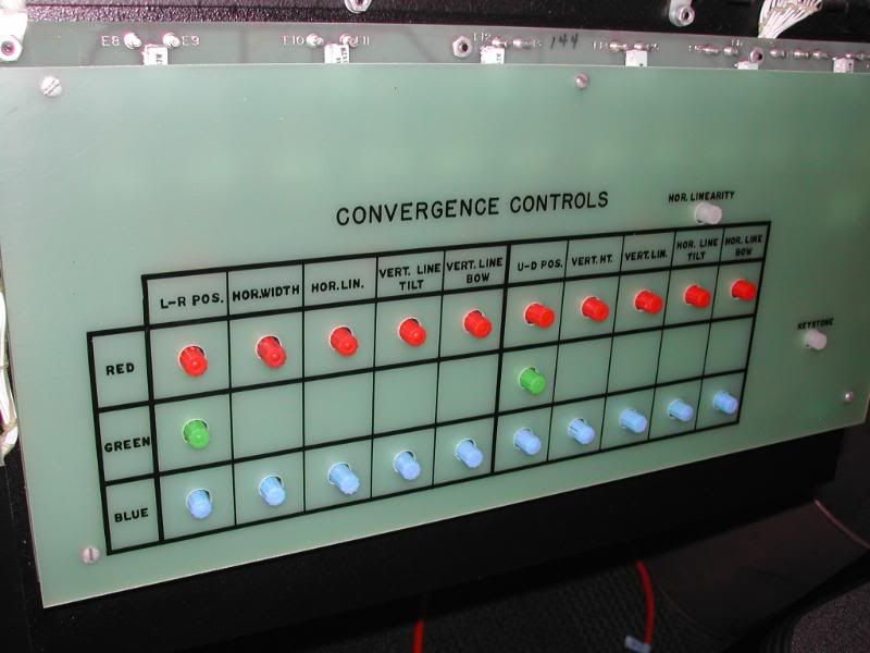

Ok here are some pics...

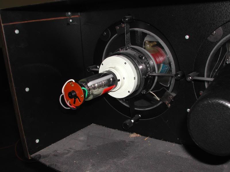

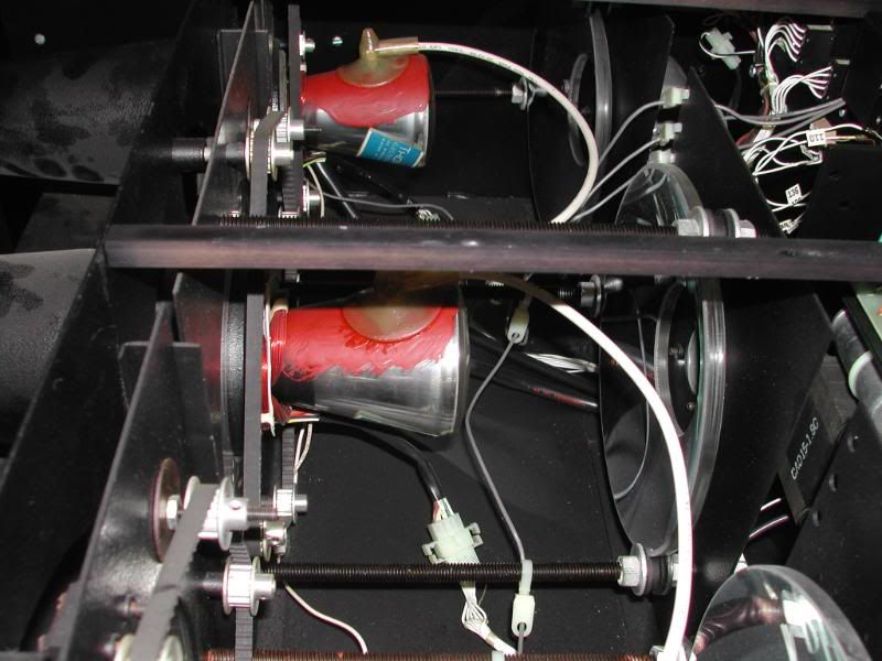

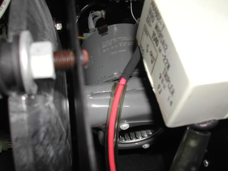

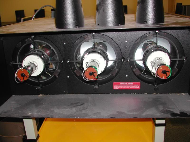

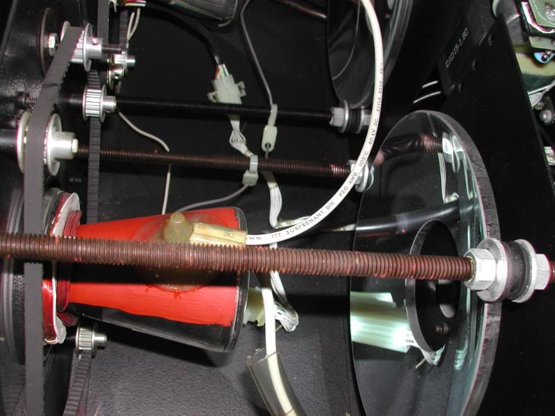

One crazy thing I noticed were the vortex fans behind the tubes... They said Dayton on them which I'm guessing was the same company as Dayton Superchargers back then.

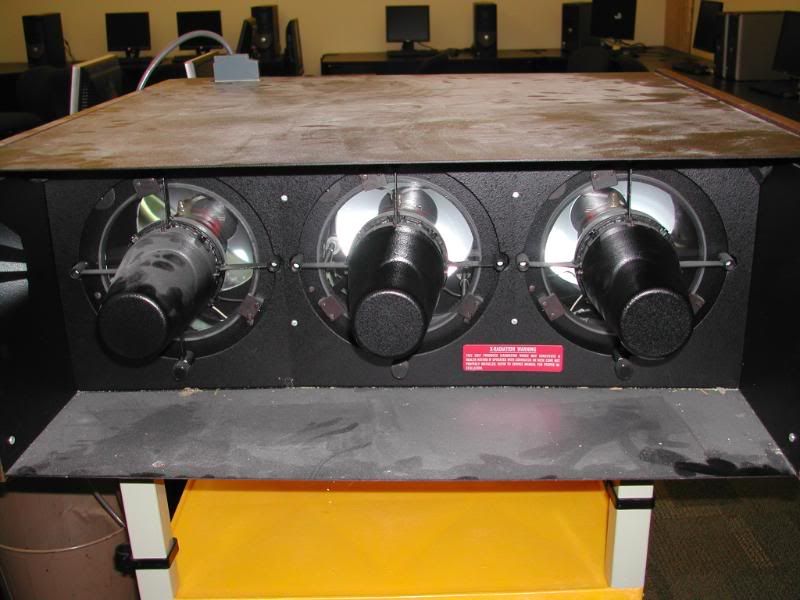

It looks like Schmidt Reflective Optics. Target and Mirror. Similar to the early Advent and later the Kloss Novabeam. More efficient use of the very little light that was available from early crts.
Use of a refractive Lens in front of a tube came later in the Advent line and continued on until the recent demise of crt projection systems. Interestingly the later Advents were made by Electrohome, a Canadian manufacturer

WOW now that is something else. Way cool! Tiny air cooled crt's mounted in schmidt cassegrain lenses. Does it power on?

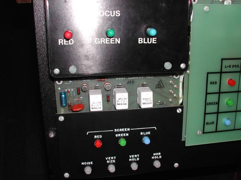

Yes it powers on and the left tube fires up and if you look into the mirror you can see scribbles just like a tv thats not on a good channel. But it makes a loud humming noise like it's picking up some major interference! The remote is way cool though. Has about 20 feet of cable so you could sit waay in the back when it worked correctly.

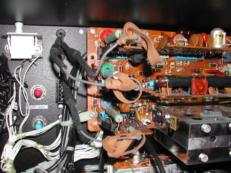

What on earth are all those belts and pulleys for?

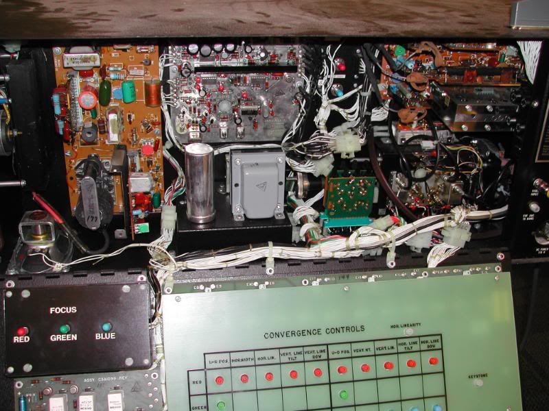

Well I'm not sure what would be the problem with this thing as it makes an annoying buzzing sound and only one lamp seems to fire up. It would probably be more of a hassle to get this thing running correctly. Could be for sale if anyone is interested or needs some parts haha...

Make sure the three video leads are connected to the video amplifiers (the ones with the rubber bands on them). Also open the flip-down door on the back of the remote unit, and make sure all three tube switches are in the on position. The buzzing could be a defective speaker, or a bad capacitor in the audio section.

The buzzing your describing is most likely bad electrolytic caps in the power supply. You really shouldn't run it until some work is done to restore it. Bad power supply caps will let tons of 60hz AC into all the circuits and could do damage. Electrolytic caps all loose thier value and should almost universally be replaced everywhere when doing a restore of this vintage and older.
Its in truly awesome shape and can 100% be restored into working condition with some nice tender loving care.

You might also wanna be a bit careful as it might have some x-ray output up close to the front of the tube faces. There appears to be little, if any, shielding.

...Those controls are awesome!
Like I said they look like the template for a Star Trek prop.
You should treat it with that TLC mox is talking about and get it back to its glory days!
