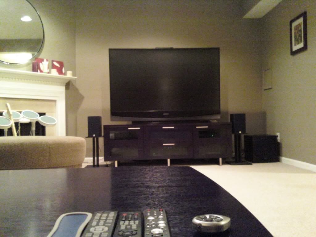

I was thinking about getting a motorized screen that lowers down in front of my mitsubishi. Do you see any issues with that?
My two main concerns with a CRT PJ are 1. I am unclear on how to run my gear into it. 2. what type of calibration will I need to do and will I be able to do it.

All of my gear is in a BDI Avion 8527, which i want to keep. So the screen will have to be above it. I am in a townhouse so I don't have a huge area to work with. I would be mounting the projector on the ceiling about 15 feet from the screen.

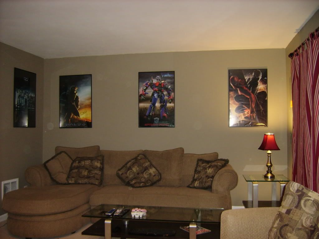

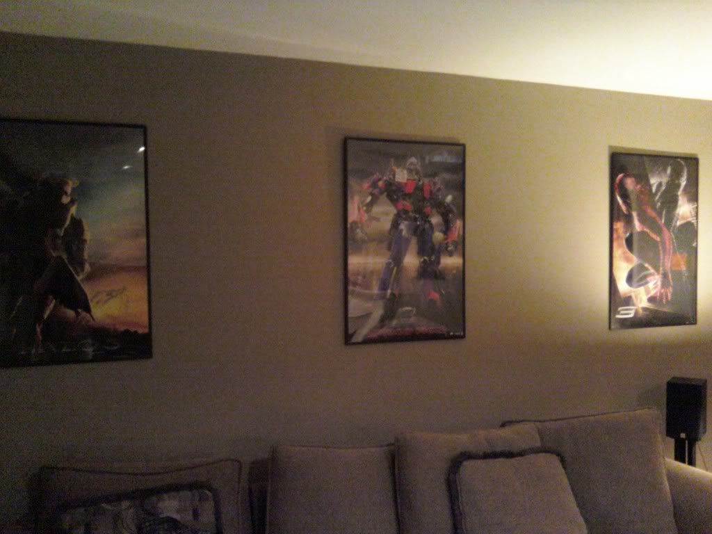

Here are some pics (the last picture is why my budget is $1000, fair trade in my opinion):

nice little place, but...... 15 feet is too far back for that room you'd have a 16 foot wide screen for most CRT's.
First ho high are those ceilings? you have to consider where the PJ will come down into the room, a Marquee 8500/9500 are 16 inches tall so add another 3-5 inches for the mount or superstutt and your at the 20 inch range down from the ceiling.
Second the throw distance is about 1.2 x screen width approximately, but the best way to place it is to get the screen size you want and set the PJ on the floor first on a cart and max out the size on the tube face then move the PJ till it fills the screen, this is your mounting position on the ceiling. So you have to make sure it wont bump your head. Barco Pj's are not as tall
and Ampros shortest hight wise for an 8 inch and larger tube size is what i would get(tube size not the ampro but they are nice but hard to find).
Dwin's are the smallest but are only 7 inch tubes and I would not go larger than 80 inch wide for a screen.

Thats awesome. I routinely monitor craigslist for them. People always want outrageous prices for ****** model though. I hope I come across one like that.
I plan on putting it in the same room as my 65" mitsu and want to have a pull down screen in front of it. I am still trying to figure out how to do this, but I want to have a switch to somehow change the out put from my TV setup to the projector. I havent found a good way to do that yet.
Ah, well, sir, I feel like a, like a slice of butter... melting on top of a big-ol' pile of flapjacks... yeah.
