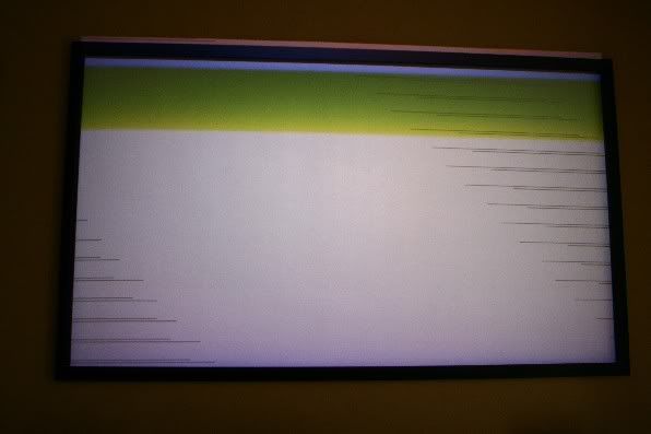

anyone seen this happened before???
watching movies halfway and black lines just appeared... the picture above is gotten when i used the internal test signal generator to produce as white screen so that the lines can be clearly seen.

post #102 of 134 Old 11-06-2006, 06:33 PM
cmjohnson's Avatar
Join Date: Nov 2003
Location: Sharply focused on sharper focus.
Posts: 6,030
Quoted: 18 Post(s)
First guess..sync issue. Source or PJ? Can't tell from here.

this problem is intermittent... it'll go away once i restart the projector.

wow, that's scary. The first thing I thought of when I saw that is SPOT BURN. You can actually burn lines like those into your $10K tubes by displaying a deflection failure like the one in your pic.
I would not run that set unless you can figure out what's wrong. A new LVPS is priority one, then go from there. Problems with the AC power from your apartment comes to mind as another possibility based on another thread here.
draganm, you mean, you've seen such lines before??? Well if this happens again, do I have to take any special precautions in turning off the projector?

hi.. i'm so sorry that i've not reply to this thread for a long time... just realised that its not right of me to update the fix...
Too be honest, I'm also not exactly sure what's the fix... I basically ordered 2 HVPS and 1 LVPS from 1egor2. The 2 HVPS failed after a couple of hrs but the LVPS was working fine. SO I tried swopping around and discovered that when I used the LVPS from 1egor2 with my original HVPS, most of my previous problems were gone...
However after a while, the problem with the horizontal lines which HK-Steve is experiencing popped up again. I solved it by pulling out the CLM chips and cleaning the contacts then plug them back in...
After a month of running steadily, the V1 started acting up with the horizontal lines and this time round, i took out the CLM board and removed the 2 daughter boards and cleaned the contacts and the problem disappeared again... now crossing my fingers that everything is fine.
whowillbe is offline

With that many intermittent problems I would get a spare fully working low hour Marquee 8500 and swap all the boards one at a time one after another giving the time between each swap for the projector to possibly develop the problems until you have no more problems with it.
If that doesn't do the trick I would do the board swap the other way around swapping the Vidikron boards into the 8500.
