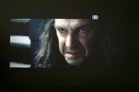

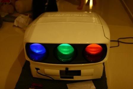

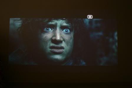

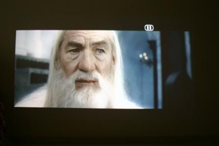

some shots of the projector.
whowillbe is offline
post #29 of 134 Old 09-17-2006, 11:08 PM
ChrisWiggles's Avatar
Location: Seattle
Posts: 20,735
Where are you located?
You need to have someone help you set this up. Otherwise, brew some pots of coffee and read through Guy Kuo's holy focus guide multiple times. And all the stuff on Tim's site. And Curt's site.
ChrisWiggles is offline
post #30 of 134 Old 09-18-2006, 12:03 AM - Thread Starter
whowillbe's Avatar
Posts: 73
hi Chris...
It looked bad on the photo is it??? I'm playing it off the wall... my installer will be installing the projector for me over the weekend. hopefully by then it'll look better.
