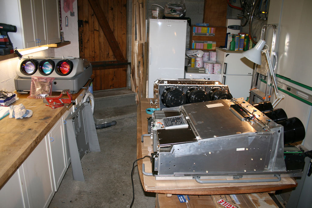

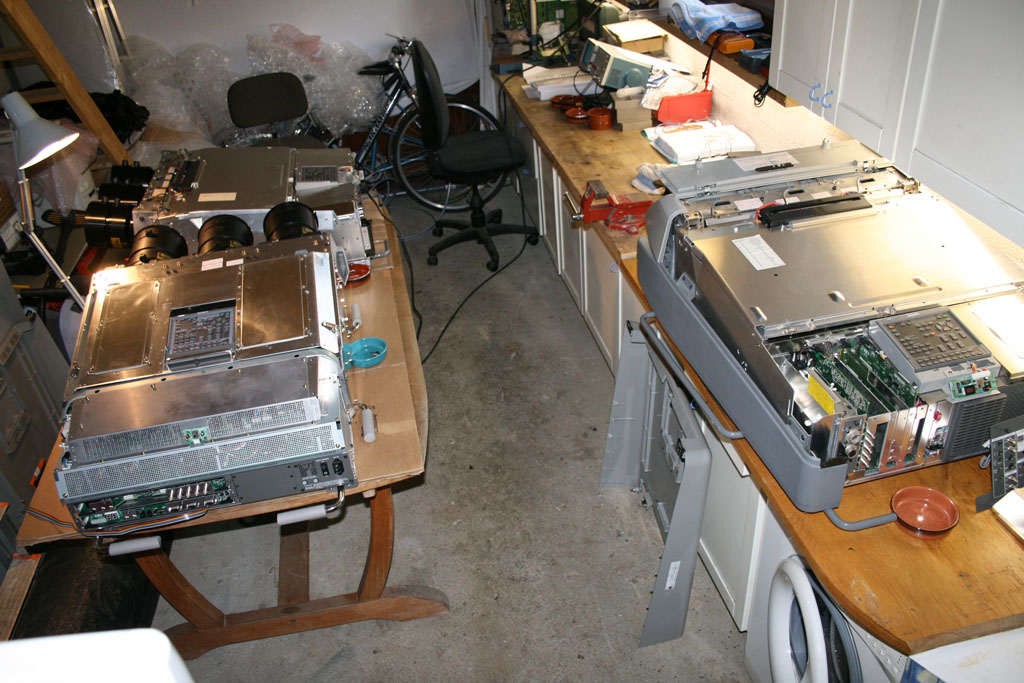

Hello,
I've bought this Curt's G90 defective unit some time ago and did not found time to investigate it until now...
Yesterday, spent some couple of hours to swapp boards between my first 'working' G90 unit and this defective one.
I've also soldered some probing wires on the YA I²C communication links to probe all I²C lines linked to DD/DE/DF and BA boards (D-SCL, [DLD0-DLD3], [DSDA0-DSDA2] and [M1-M5] with D-Reset signal). I found that, when a failure occurs, the D-SCL signal is fading toward 0V without any reason.... Looks like a I²C bus loading problem because of a defective receiver OR a defective local power on receiver...
To investigate if it's a I²C bus loading issue, I tried to swap all DD/DE/DF boards with the one from my first unit to see if it solve the issue or not : Nothing has changed on the unit behaviour. Then, It's not these boards so not the buses loadings conditions...
Since Curt said that both YA and BA boards were checked OK by someone else, I didn't swapped those two boards yet but after checking all the PSU sections and found nothing wrong, I was wondering if is was not worth trying to swap those YA/BA boards as well, just to re-check
Then I made it yesterday and then the unit started to work fine
Found also that the green tube bad G1/G2 bias (ABL ?) I had was due to the BA board (this failure disappeared with my working BA board)
- Then, I must conclude that the I²C buses failure is relevant to YA board ONLY.
- The Green tube overdrive issue is only relevant to BA board .
I will try to change IC13 (74HCT541 SOIC20 chip) I²C bus buffer on YA board and probe the Green channel after IC404 (LM1283) device since the green overdrive is present with internal tests patterns on BA board.
Curt, did you noticed that green tube was overdriven when you've investigate the unit ?
Later
John

Hello,
Here is my update on this G90 servicing :
Found BA board Green Bias issue !
Spent some time on probing BA (4/12 schematic) RGB BKG CONTROL section to compare analog signals between Green (defective) and Red/Blue (OK). Found that BKG-G output signal was too low (1.32V) instead of ~3V.
- Tried to change IC601 (MUX) and IC604 (Current to voltage converter) : no fix .
- Spent one hour with removed BA board on impedance probing around IC601 vs IC600 and IC602 : found that IC601 pin#1 impedance vs +12V rail was 10K higher than the two others chips
- I then usoldered R603 (100K 0.5% SMD0805) and check it with ohmmeter : found it opened
- Tried a new 100K SMD0805 resistor in replacement, plugged back BA board on G90 and fire : works fine now
BA board failure solved
I never saw such open resistor like this on board in my all EE life
Let's repair the YA then !
John

Yes, but sorry newbieDAN, I also have two others G70 to repair as well !
See my workshop state (some pics for Frank ):
Cur't original G90 under servicing and my brother's G70 unit (that have D board failure), then another friend's G70 that do have a C block incompatibility with unit B board
So, I should say that my workshop is almost full of sets waiting for repair
John
Home theater enthusiast for over 20 years !
My dedicated HT room !
