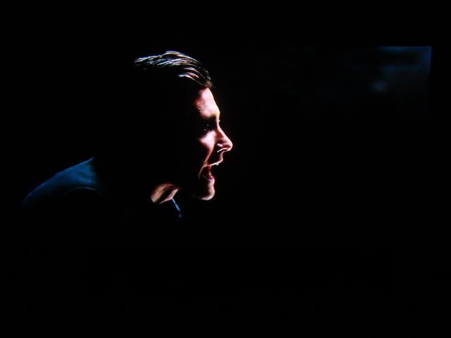

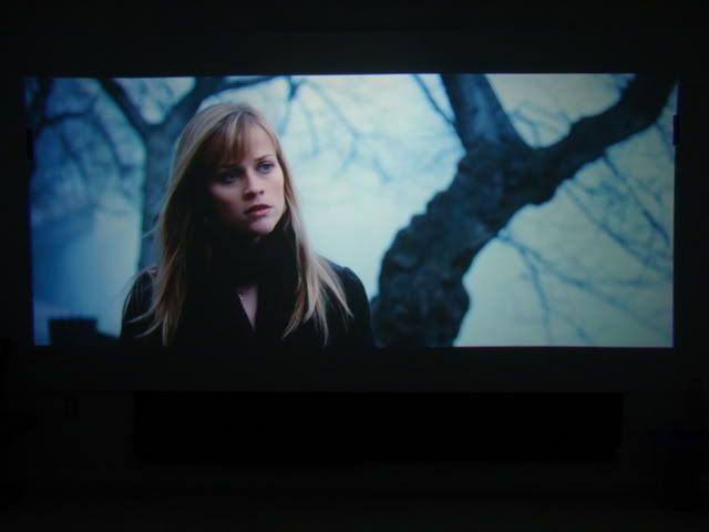

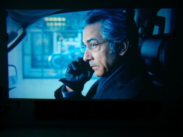

Just getting around to trying this thing out. I'm using a Wilsonart Designer White screen to test with. Here are a few shots with a rough setup. Picture settings were 35 for contrast and 60 for brightness when I turned it on and have not changed those settings.

Is the screen small? 35 contrast is very low.

The screen is 100" wide by 56" high. I tried bumping up the contrast and while it looked better in some cases, I kind of preferred the overall look the way it is. Shadow detail was better and looked more film-like. Once I get the projector mounted and converged correctly I may play around with the picture settings more. I might also need to try a different transcoder as I think the one I have is crushing blacks a bit.

Wow,
That looks good; I really need to pick up some of that DW and some HD-144's for my Quee

Thanks! I'm not the best at taking screenshots by any means and I have a long way to go in setting up this projector. However, I could see an instant improvement with this Wilsonart fomica screen over the plain blackout cloth screen I was using before.

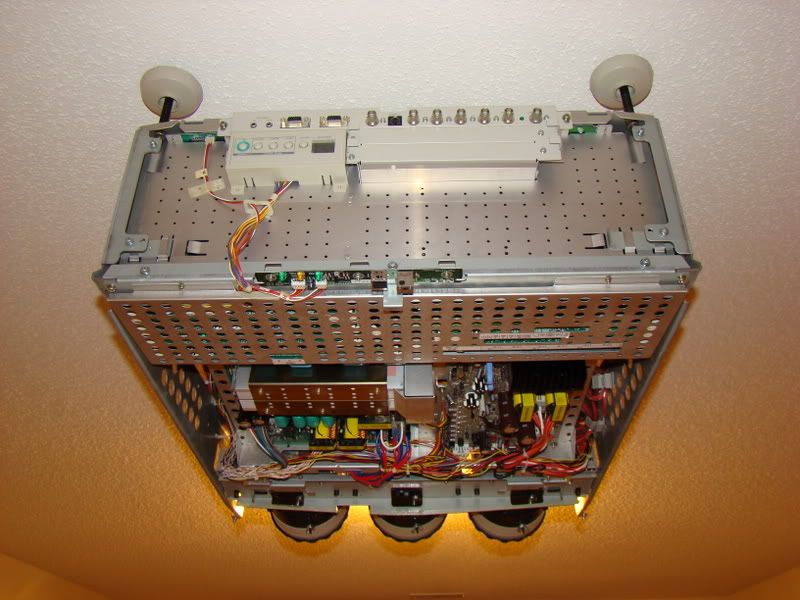

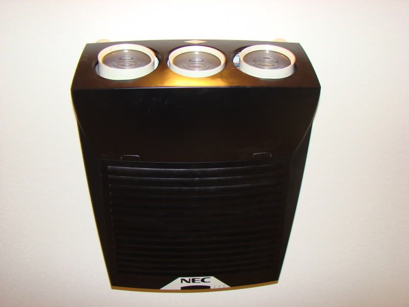

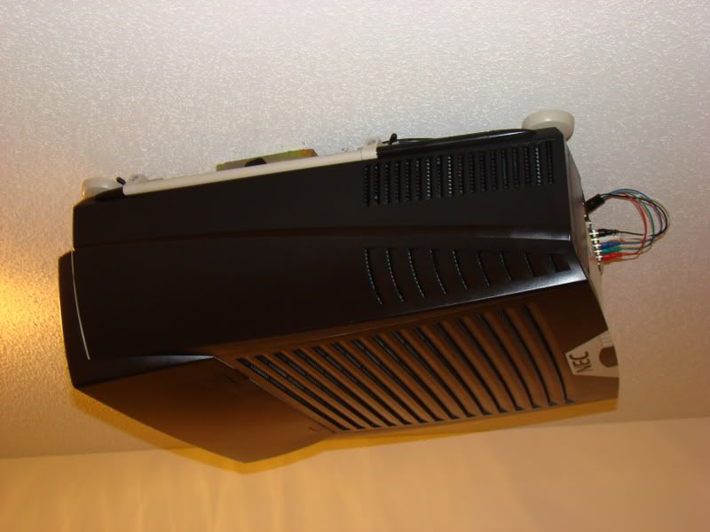

Well, the projector is now mounted and resting 7' above the floor. What a chore that was! Me, my dad and another guy got it lifted up and set on the bracket which is supported by two five foot pieces of Unistrut laying perpendicular to the rafters in the attic. Here are a few shots of what it looks like after having to do convergence over yet again.
dropzone7 is offline

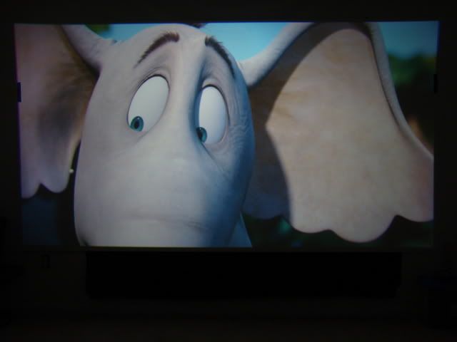

Here is one before I figured out how to use my camera. As you can see, everything is over exposed so you can see the inside of the room. The tape on the screen show the borders of what the final screen will be (61x108). There will be black curtains covering all of the walls and that light fixture will come down and be replaced by recessed lighting. Still lots of work to do...

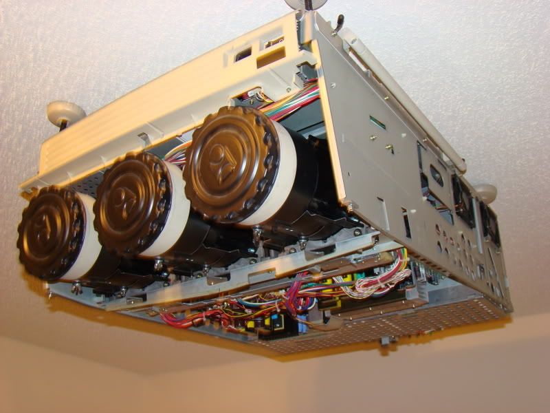

The beast on the ceiling.
The messy room with my makeshift screen masking falling off the wall. This area will get some much needed attention in the next week or so. I have a window behind the screen that I have to fill in with something to support the middle of the screen. I still may need to raise the screen up a bit more as well.

It's so...
Naked
Looking Good,
Erik
RGB
CRT Forever
Fellenz is offline

I guess you mean the projector. Yeah, it's showing all of it's juicy guts at the moment because I painted the case black. It was that ugly computer beige color and was just screaming for a paint job. I have more pictures to post of how this thing is mounted. I was making it out to be so much more complicated that it needed to be but in the end all it needed was brute force and some steel.

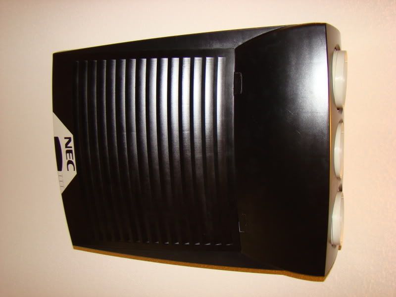

Not much going on right now so I thought I would put the projector covers back on after my dad painted them. They have been sitting around for a few months and I figured it was time to see what they look like on. I noticed a while back that I forgot to take off the small louver piece near the front so that will be getting paint as well. We taped off the areas that have information about the projector so you can still see some of the old case color. I will remove the feet from the projector and may consider darkening the lens rings somehow. I think it came out pretty well. Much better than the ugly computer beige color.

Call me crazy, but I think the white on the lenses actually looks cool.

Yeah, I guess it does create some contrast. Maybe I will leave those as is.

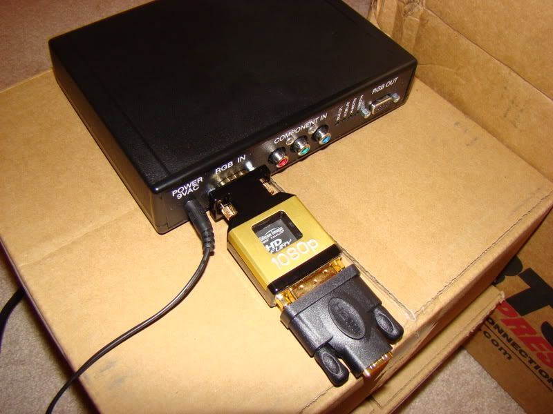

In other news...here is my Crescendo Systems transcoder with the HD Fury attached to it.
and my new Onkyo TX-SR705 receiver which does not want to play nice with the HD Fury.

If I could just get this receiver to output the HDMI sources through the HD-Fury I would be set. I just ordered a Monoprice HDMI switcher to put between the receiver and the Fury because a few people have had success doing that. Fingers crossed.
