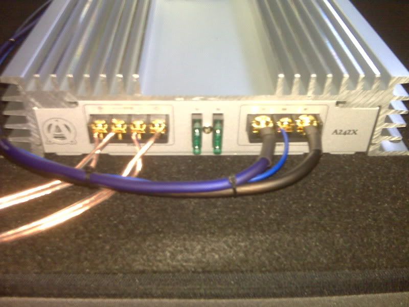

Is there a formula or something to figure what the right levels to set the knobs to? When i got it back from installation, it kept cuttin off on me, so i have been trying to find the best settings blindly...
I have 2 Kenwood W2511 10" w/ Ample amp, details for both:
Kenwood W2511 speakers: Product MPN
MPN: KFC-W2511
Key Features
Car Speaker Type: Component
Elements: 1-Way
Car Speaker Function: Subwoofer
Size: 10" x 10"
Nominal Power Handling: 300 Watt RMS
Technical Features
Peak Power Handling: 1000 Watt
Frequency Response: 30 Hz - 1 kHz
Sensitivity: 90 dB
Impedance: 4 ohm (Dual Coil)
Components
Woofer Material: Poly / Plastic
Surround Material: Rubber
Mounting
Enclosure: Non-Enclosed
Top Mounting Depth: 5.63 In.
Bottom Mounting Depth: 5.88 In.
Mounting Diameter / Length: 9.06 In.
Miscellaneous
UPC: 019048170538
Product ID: 40461977
A242X:
Dual Channel, 300 W x 2, S/N Ratio: 90 dB
Released 2 years ago
Amplifier Type Dual Channel
MPN A242X
RMS Power at 2 Ohms 300 W x 2
RMS Power at 4 Ohms 200 W x 2
Signal to Noise Ratio 90 dB
UPC 693012004267

I tried posting in the other thread you have but for some reason it wouldn't let me so I found you here. Pretty much I generally set the crossover for customers' subs at 100Hz (depends on their speaker setup) but for myself I never have it above 90hz and sometimes have set it as low as 75-80 hz. Other than messing up your sound stage by being able to localize where the bass is coming from having a high crossover point for your subs isn't bad. It won't hurt your subs or amplifier that you are using with your subs. The pictures you provided tells me two things 1.) it looks like a fairly clean setup 2.) it looks like they wired your subs in stereo, which isn't a bad thing, but I never wire subs on an amp in stereo. It shouldn't change anything (especially if your headunit has a subwoofer RCA pre-out) it's just something I never do. Also, that blue wire is your power wire and the black one is your ground. I can't tell what gauge they are though. It looks like 8 awg, but it could honestly be as big as 4 awg or as small as 10awg the way those pics were took.
After seeing the install (or part of it) I'd say there's either a problem with the amp itself (defective) or there is a wiring problem in the subwoofer box and with out pulling out the subs and taking some pics I couldn't be sure where the problem is. So my advice is to take it back to the shop that installed it. The install doesn't look bad and most reputable shops have lifetime warranty on their labor so it should be free to atleast figure out what the problem is. If you bought the equipment from them then they will also replace it under the warranty (if the stuff is still under a warranty) and you won't be charged for that either. If you didn't buy the equipment from them they can atleast let you know what they think is wrong and you can go from there.
I used to run a store that was located in the ghetto and we had a couple of installers with featured installs in Lowrider and other national magazines so don't count these guys out yet.
Good luck

Barring something really wired incorrectly, I would play your stereo like you normally do. When/if it shuts off, go back and feel the amp. Is it smoking hot? If it is read below.
So you are running 2 dvc subs (each coil is 4 ohms) to your amp. Each sub is wired so that your amp is seeing a 2 ohm load stereo.
This is how I am reading the current wiring set up from the info you have given...
Looks like you have the max bass boost set with gain set at 3/4 from what I can tell.
My guess is that you are just asking for a bit to much out of your amp. Not knowing what you have the head unit bass control and level set at. When you add an EQ boost to the signal, you are asking the amp to work X times harder.
Since most low frequencies are recorded mono wiring stereo for sub bass is ok.
I agree with Natedog, the wiring looks adequate from the pics but could be possibly undersized. Just can't tell.
Crossover frequency is really a setting that is dictated by your system. You can set anywhere. The smaller speakers you have up front, the higher you will want the crossover as the subs will be required to help with midbass reproduction. Lowering the crossover just cuts midbass out of the sub (in my opinion as it should be)
Localization of the sub is often incorrectly diagnosed as to high of a crossover. It is most of the time due to panel vibration caused by the resonance of the panels. Also believe it or not, even the seat you sit on can cause localization of the subs when the seat back vibrates to a bass note, hard to fight how our bodies perceive,react to and localize sound.

Nate, you're absolutely right they hooked it into my stereo, everything is stock (i just got the car mid February).
It doesn't get hot, just warm.
If i remember right, he said 8 gauge wire...
I set the dB to where i think is 90 because i re-read this part:
Technical Features
Sensitivity: 90 dB
and realized lol. I had it up probably 120, and the Hz was about 100 mark (hard to tell with no numbered markings). Now the Hz is @ around double that when i turned em during lunch and on the way home they cut off once because i turned the volume up 1 degree, restarted the car with volume lower and then turned down the dB a scosche. Also my bass volume remote knob to the amp is up all the way. It did bring out the bass like i want it more with the Hz doubled. Since it says it can take up to 1 kHz under 90 dB, should i max it at it's 250?
I was told it's not crossed over, so it should be hitting @4 ohms, and crossed is @2 ohms? What is the difference of the 2? I read what you said how it takes the mids out, which my stock speakers handle fine, but if i can get the settings right the way it's already hooked up, i'm cool.
I do have the Bass Boost set to 12 dB. Should i set it to 6, or 0 dB?
Appreciate it guys

First thing. Set bass boost to 0. I know you lose some bass. But unless you don't mind the amp shutting off and possibly having to replace it due to premature failure, keep it at zero
2. That bass control knob is most likely a remote gain control. And you have it maxed out. Also a bad thing, see reaon above. the gain control is not a volume knob. An amp makes a finite, specific amount of power. Cleanly.
The misunderstanding is turning up the gain makes the amp put out more power. wrong.
you are feeding the amplifier a signal (input signal). from 0volts to lets say 4 volts. The gain allows you to match the input signal to a specific output. So when the gain is all the way down, you may never get full power out of the amp. and when the gain is all the way up you get full power out of the amp with the volume knob of the head unit at 1/2. Which may seem cool but then you are really into a song and you turn the volume knob to 3/4. Now you are clipping the amp. asking it to produce more power than it can. Things heat up, stsart sounding bad but with subs, you may not hear the bad sound. etc...
I am still guessing that if you turn the gain down to half. and leave the bass control alone, all will be fine. If you get pissy with the output, its time to consider a mono sub amp for those subs. and really get some thump out of them!! Use the amp you got now for the full range speakers.

LOL i was told it was the bass volume! Damn glad i came here, and i can verify.
I turned the gain remote down to half, on the amp i tuned the Hz to around 100, and the Gain i like how it sounds on the higher end..

Without seeing your entire setup, its hard to tell entirely what is wrong or advise with 100% certainty I am right.
As for more bass, is your enclosure sealed or ported?
considering you are running this thing from the factory head unit and in a stereo configuration, I am thinking you might try what Natedog recommended.
Since your subs are dvc 4 ohms, series wire each sub to be an 8 ohm load and then parallel wire them to amp for a 4 ohm mono load. See if you get an increase in bass. You shouldn't, but stranger things have happened!
