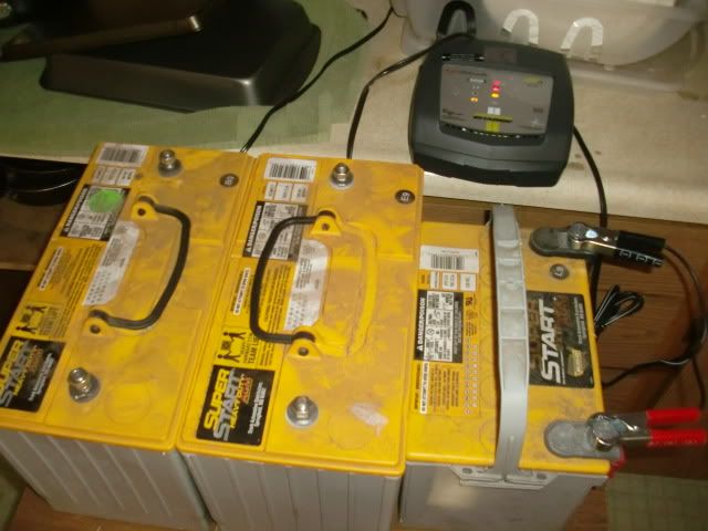

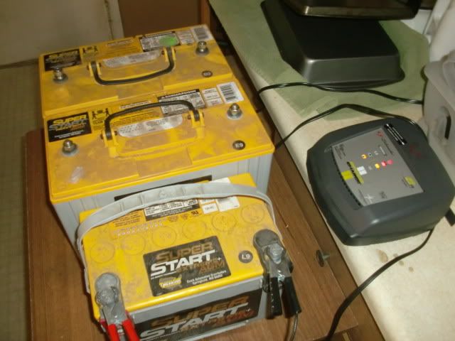

pulled all three batts and brought them in, charger is on the starter batt, it kicks in for a few mins, then off for a few, I'll keep checking with the DMM...hope I'm getting somewhere!

so theres a little trick to getting completyely discharged AGMs to start taking a charge. The charger has 2 ways of shutting off, sometimes as soon as it starts charging the cooling fan gets louder and louder till it clicks and stops charging for a bit..then it kicks back in for a while and shuts off again, other times it thinks/says the battery has a full charge then you have to disconnect then reconnect until it kicks off again, process repeat. Once the battery gets a small charge then the process stops or becomes much less frequent and then it takes over a day to get over a 12V charge. So far I brought 1 battery back to life, the 2nd large 100aH is now starting to take charge...hasn't kicked off for a while. Tomorrow I will try to get the little starter battery going again.

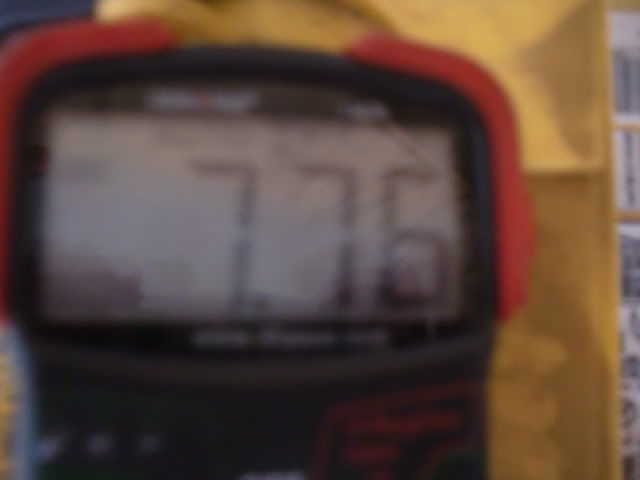

Was that 7.76 volts that you measured? If so that battery was beyond dead. You certainly can bring lead acid batteries back to life especially if the internal structures are still fine, but I have never seen one at 7 volts. In my experience even you bring it back it may not have the same capacity as before. Depending on how much time or passion you have, it's less trouble to replace it.
I also suggest checking the acid levels. Open up those six top screws and add distilled water if it's low. Don't add anything else. No salt, no sulphuric acid. Just distilled water.

thank you! Theyre all charged, its running again, but like you said...do they hold as much as they did? prolly not
