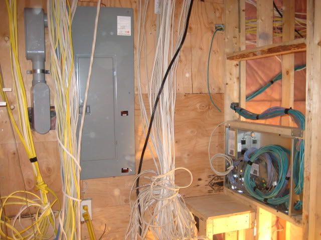

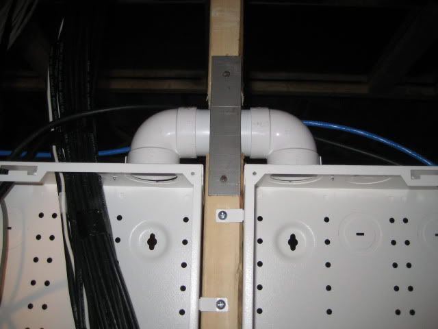

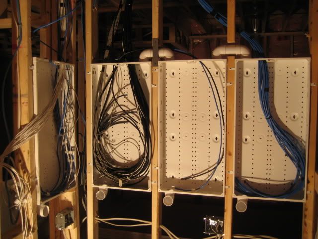

Structured wiring panel eye-candy!!!
Below are access loops i made so i can pull wires in the future from panel to panel.
Openings for power to plug into nearby outlets as well as battery backup plug-in.

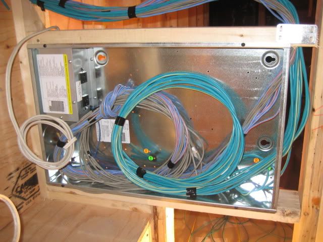

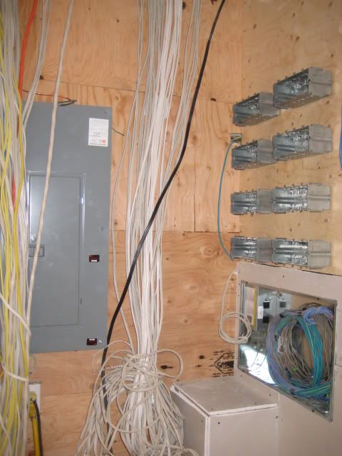

Lutron Homeworks 4 panel
Other side of electrical closet. Note that I have not yet mounted the 8 wallbox power module boxes. They will be housed directly above the lutron panel.
note too that i need to install 2 more subpanels. 1 for lighting, and 1 for theater/music.

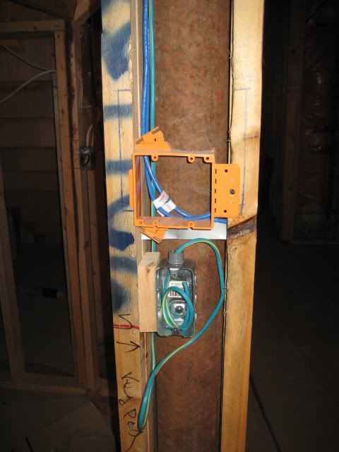

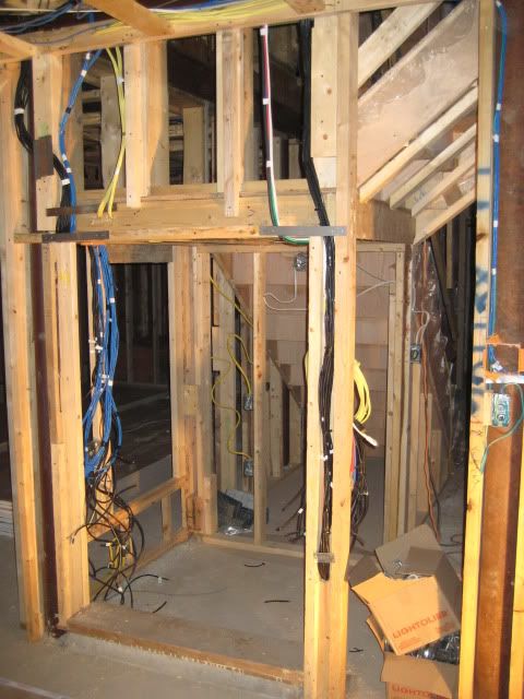

rough-in bracket for russound keypad (on top) and lutron keypad (on bottom).

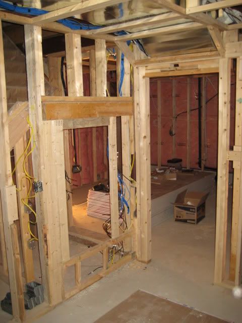

the equipment closet for ht and music control is located under the stairs with a door access. here is a pic of it in its raw state.
and finally, this is the view of the closet from my office. the opening will also house my 2 channel music stuff and will all be completely hidden under the stairs.

Awesome!
I like how the Lutron HW KP is centered below the Russound KP. Nice touch.
Any conduit, basement/crawl -> attic? wiring closet -> display/projector? Makes it easier to 'upgrade' hdmi.
Print the pic showing the wiring closet door opening, and hand it to the guy who is installing/constructing the door. He'll be more careful with his nailer.

thanks! yes, i did run a conduit from the attic to the electrical closet for future runs. no conduit from pj to equipment closet. there would have been too many 90 degree bends that it would have been near impossible to fish anything later on. i did however run 2 hmi cables and a component from pj to equip. closet. i just drywalled the theater this weekend to realize i forgot to run cat3 from the pj to equip. closet for ir control. so, i fished some in (good thing the other side of the theater was not drywalled yet), and i did a quick patch.
good idea about the wiring behind the door. don't want any screws going into the wiring!

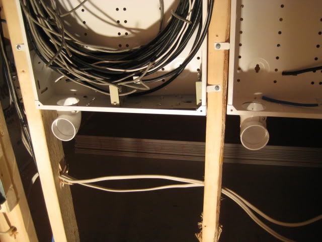

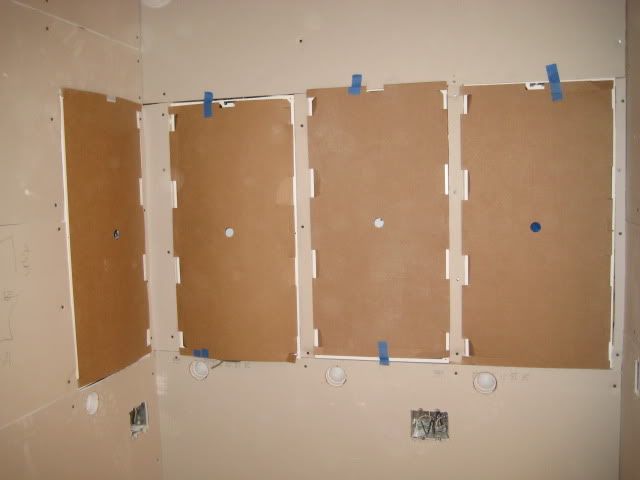

structured panels all drywalled
lutron panel with wallbox power module boxes

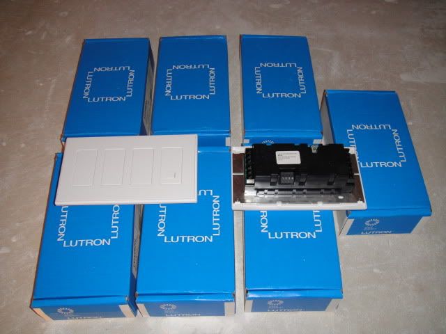

pics of the wallbox power modules
Anthony A. is offline

these things are a breeze to wire. i had my electrician wire me the subpanels and i hooked up the modules. took me less than 2 hrs to do all of them. pics to follow.
