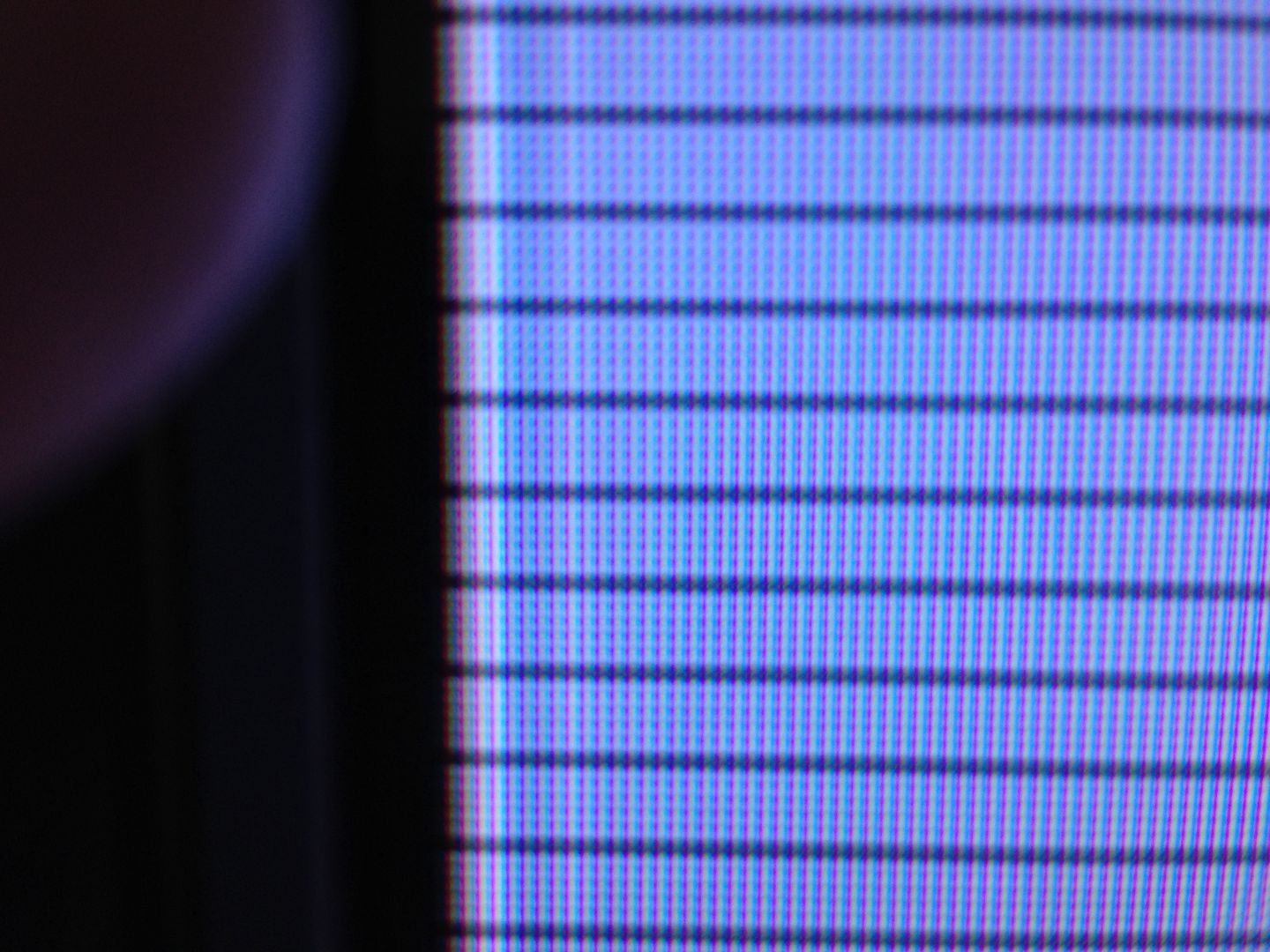

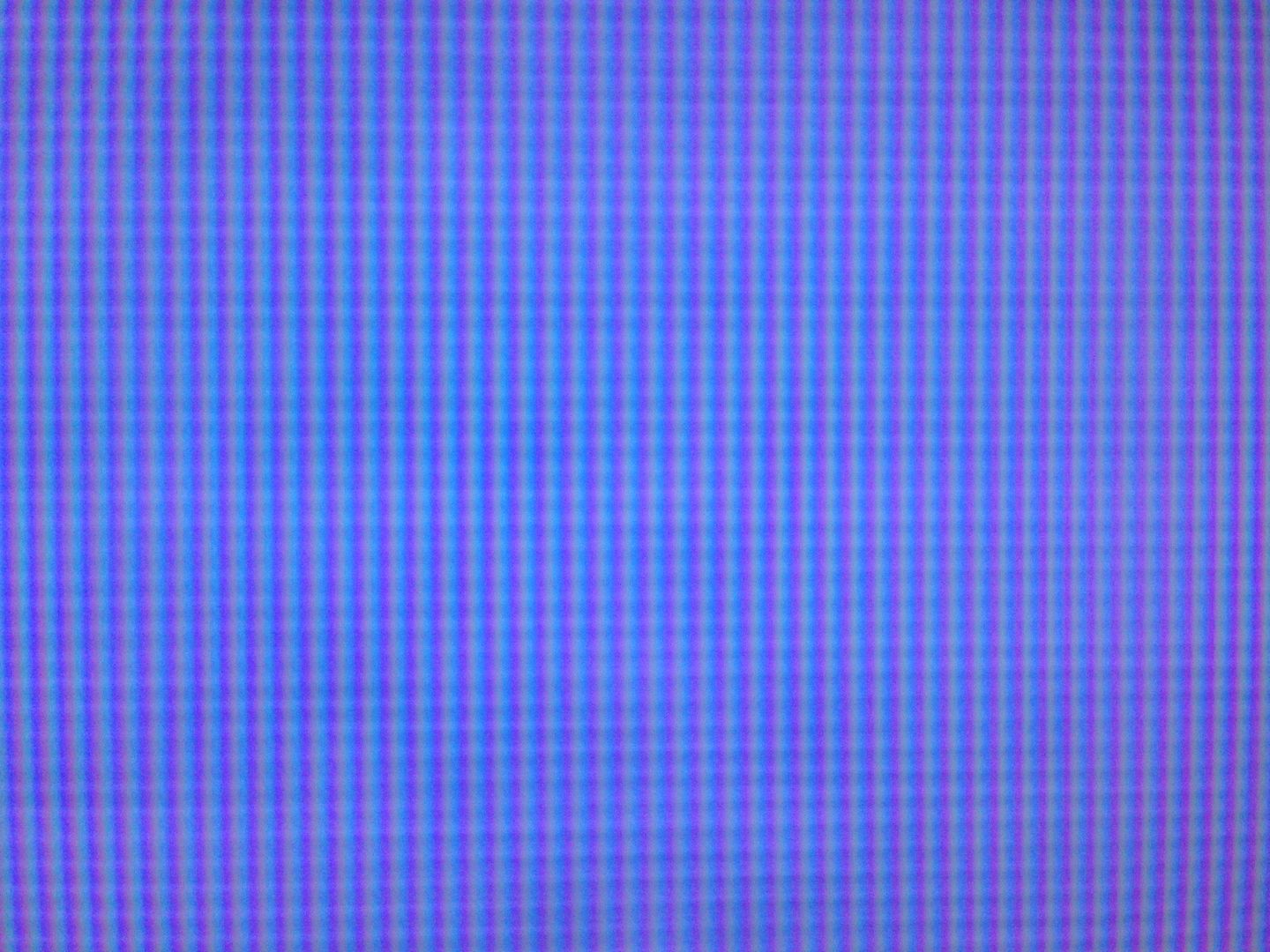

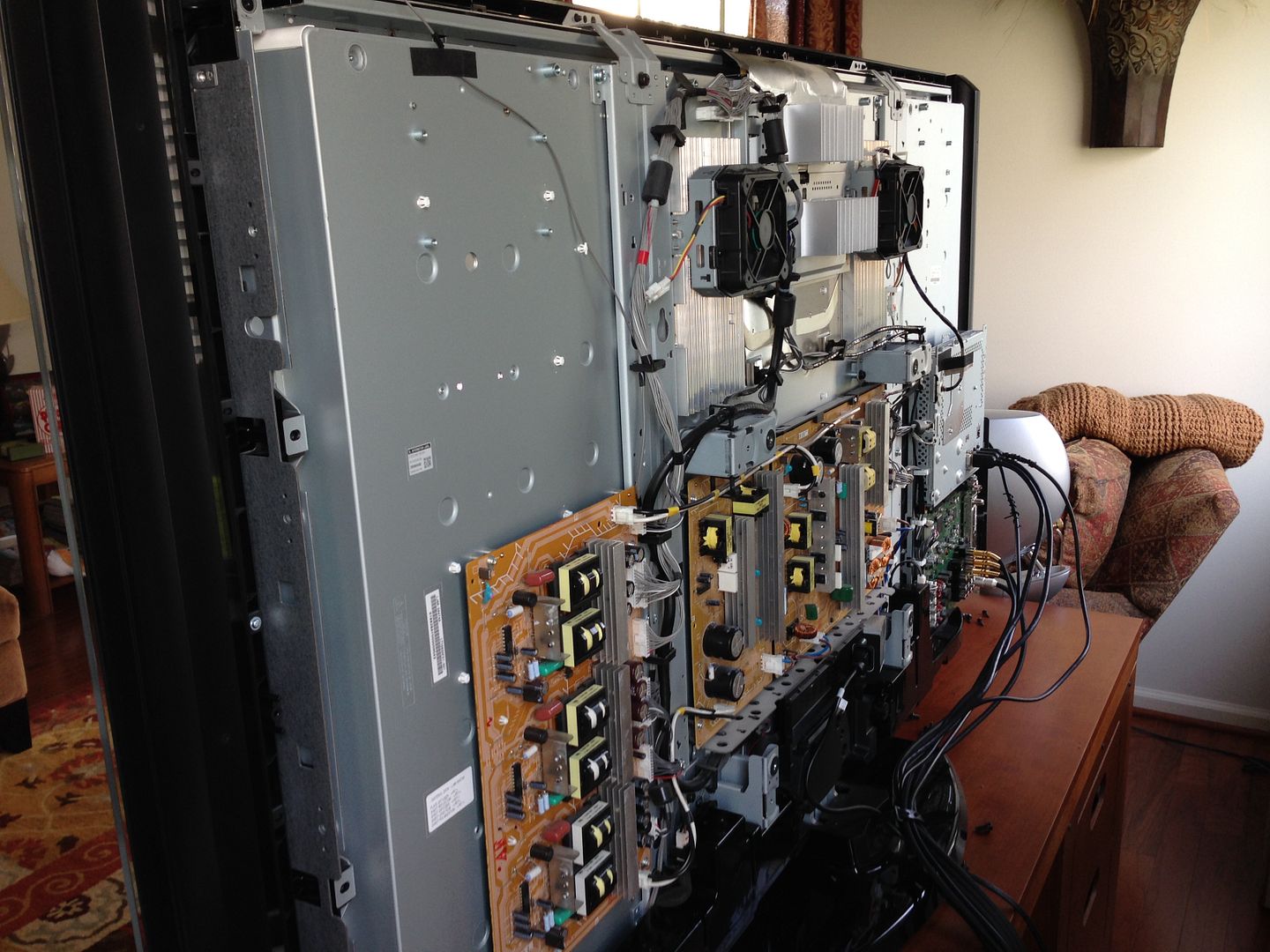

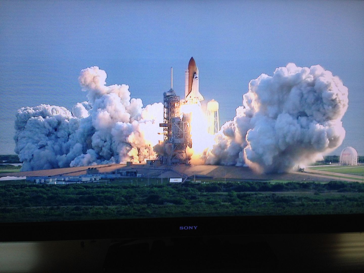

Every 6th line dark to left normal to right
Here are a few photos:
Space shuttle launch illustrating how every 6th line is dark on the left and progressively returns to normal moving from left to right.
Close-up of left side of screen.
Close-up of right side of screen.

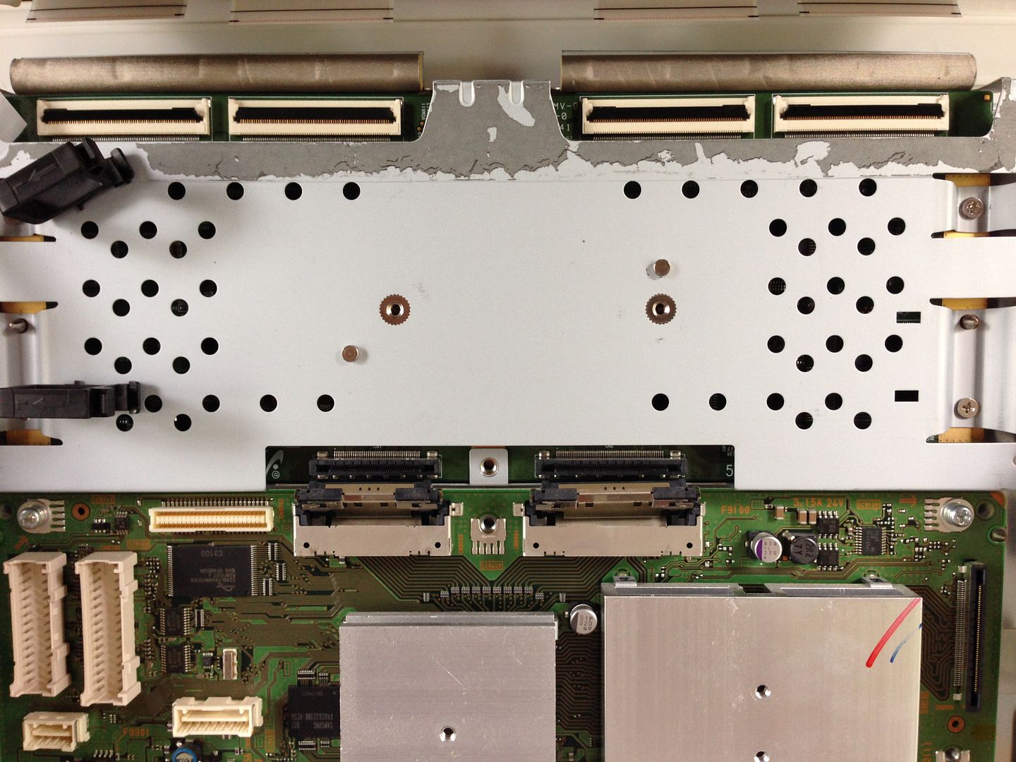

View of TV with rear cover removed. Notice the two heat sinks at the top middle. The top one is attached to the TCON board and the bottom one is attached to the CB1 board.
Close-up of the TCON and CB1 boards. Notice that the top lip of the CB1 shield overlaps the TCON shield. For that reason, the CB1 board must be removed first. Also, notice what looks like foil attached to the top of the TCON shield. It must be removed VERY carefully.

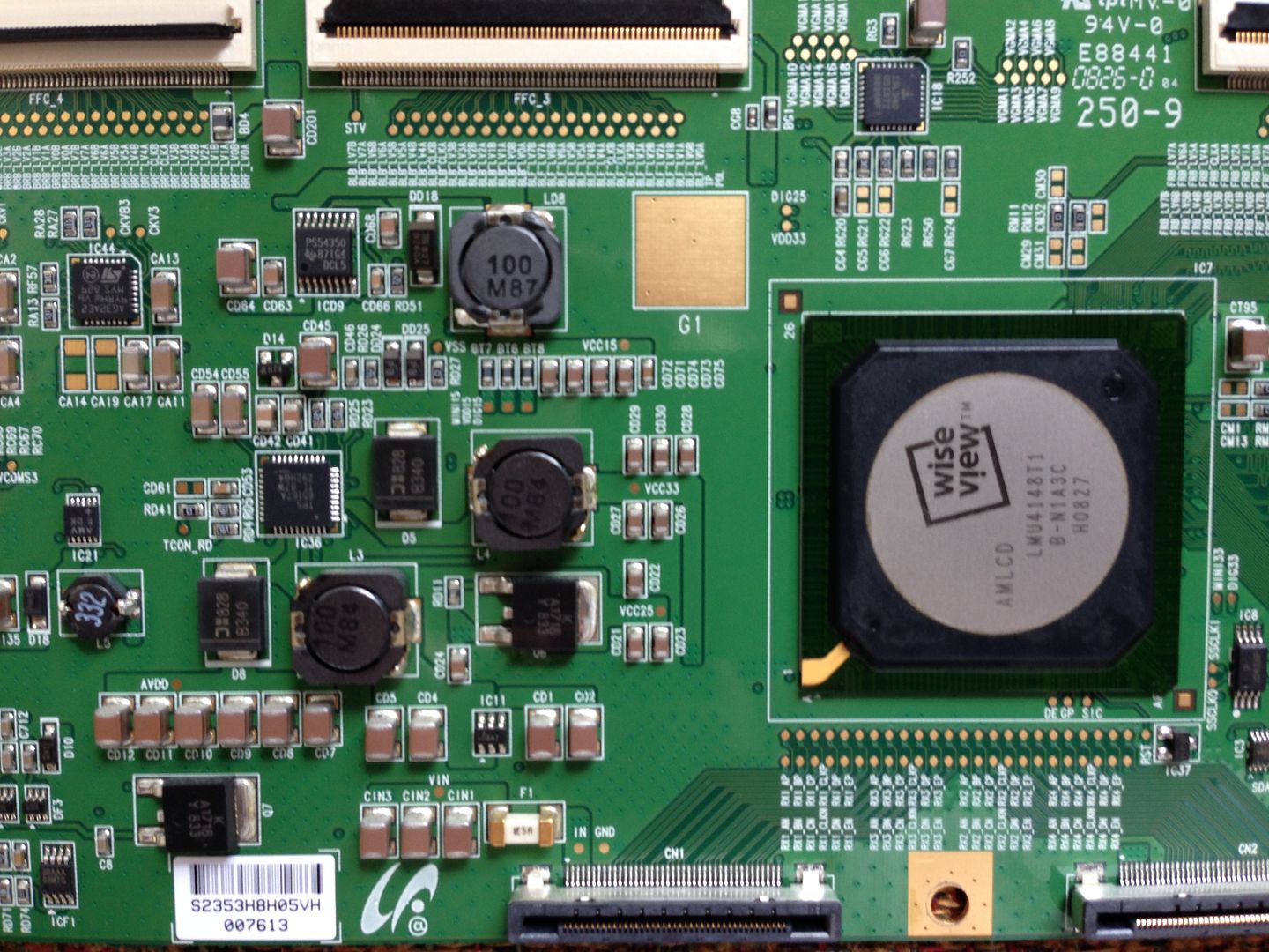

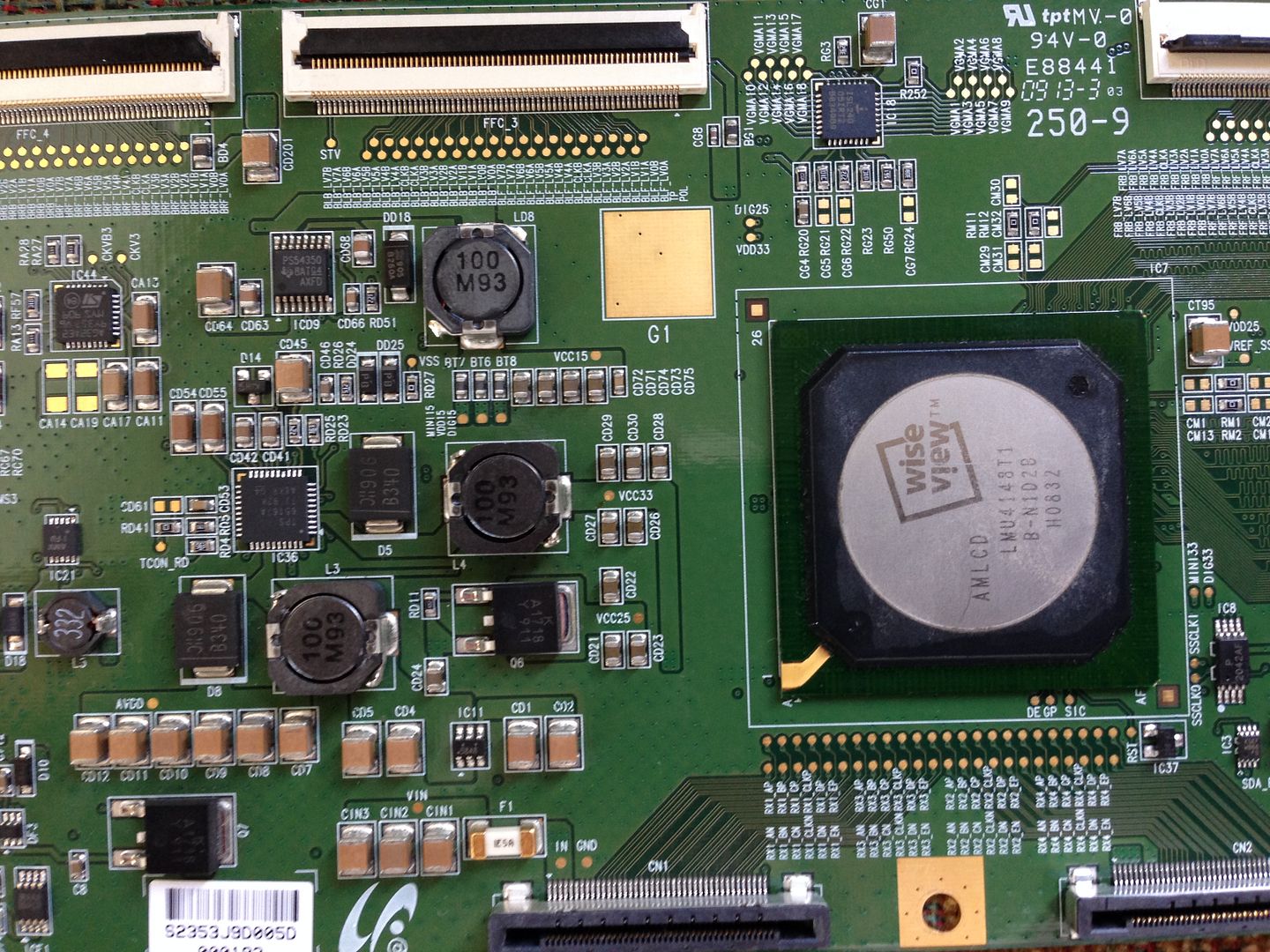

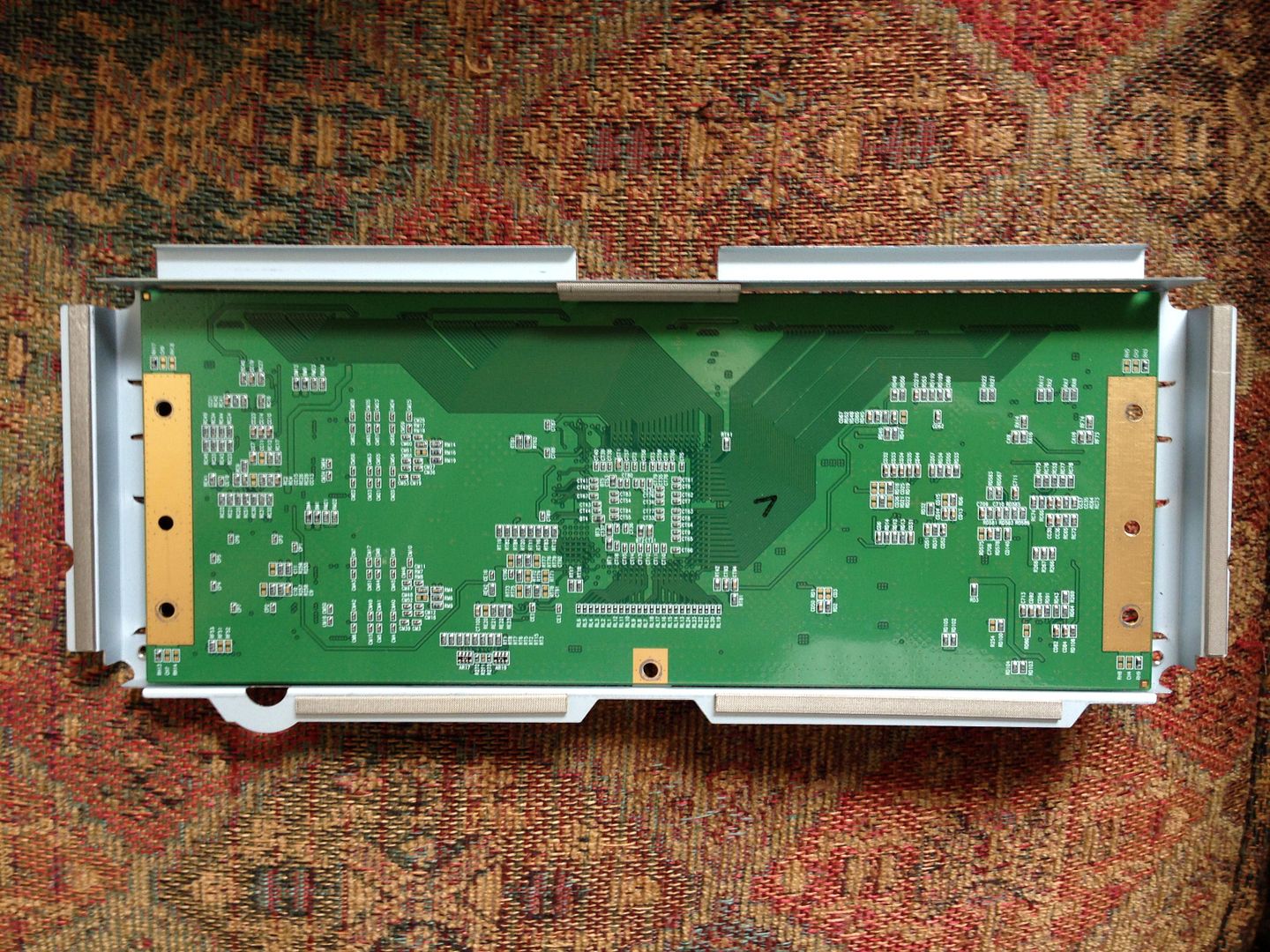

Replacing the Sony XBR8 TCON board
The photo below shows the TCON board cover at the top and the CB1 board below it. If you look closely, you will see that the ribbon cables from the panel to the top of the TCON board and the two cables from the CB1 board to the bottom of the TCON board have been disconnected. It was apparent how to remove these cables after inspecting the new TCON board. Each ribbon cable connector has a black horizontal locking bar across it. You just pull the locking bar towards you with a finger nail and lift the ribbon cable up and out of the connector. The two connectors at the bottom of the TCON board pull out and swing down to get them out of the way. Thus, there is no need to remove the CB1 board, only it's shield.
The photo below shows what comes off in your hands when you remove the five screws that attach the TCON shield to the chassis. This was a big surprise. The TCON board drops out of the shield for easy replacement.
After swapping out the old TCON card for the new one and re-installing the removed parts, I plugged in the set and turned it on. To my dismay, the power relay clicked once, the Sony logo lit, the power relay clicked again and the Sony logo dimmed. There never was a picture. I re-installed the original TCON board and the set works as it did before. I took photos of the old and new boards while I had them both out to see what part numbers appeared.
Photo of the original board. The part number is on the small white tag at the lower left. It begins with S2353H.
Photo of the replacement board. The part number on it begins with S2353J.
Based on the information above, I conclude that I purchased the wrong TCON card. If you go to www.tristatemodule.com and search for kdl55xbr8, you will find the following two TCON cards listed:
LJ94-02353H Sony TV Module, T-Con board, 550HH6LV0.7,
KDL-55XBR8
Board #: 550HH6LV0.7
Part #: LJ94-02353H
LJ94-02353J Sony TV Module, T-Con board, 550HHC6LV0.7,
KDL-55XBR8
Board #: 550HHC6LV0.7
Part #: LJ94-02353J
I ordered the replacement TCON board based on the first seven characters of the board number that I could see on the original board without removing it from the shield, 550HHC6. I concluded that I needed the second card, since the first seven characters of the board number for the first board are 550HH6L, not 550HHC6. The original and replacement boards do have the same board number, 550HHC6LV0.7; however, they have different part numbers. The part number on the original board contains 2350H as does the Tri-State part number for the first board. Thus, I conclude that I ordered the wrong board. I placed an order for the first board yesterday. Oddly enough, it cost less, $55.60 + $11.49 shipping. I have the first card boxed up to ship back Monday. Unfortunately, I will have to pay a 20% restocking fee for my mistake.
I received the new TCON board yesterday and installed it today. The board works, but does not correct the subject issue. I have a CB1 board on order now, part number A1557695A. Let's keep our fingers crossed that it corrects the issue.
jehill is offline

Quoted: 45 Post(s)
Liked: 6
I received the replacement CB1 board today and installed it. Unfortunately, it didn't correct the subject problem. I talked to the Tri-State tech again. He is convinced that the panel is bad. Apparently, the problem is caused by a board physically inside the panel assembly. This is bad news. It looks like I will have to live with the problem until I decide to replace my KDL55XBR8.
It turns out that I miss-answered a question that the tech asked me before he suggested that I replace the TCON board. He asked if the on screen menu was effected and I incorrectly answered no, suggesting that the problem didn't appear when the on screen menu was up. The tech wanted to conduct some tests on my set to confirm that the panel is bad, but I wasn't home. I will call him again next week and run through the tests.
jehill is offline
Put that TV in the basement, bedroom, guestroom, or recycle bin... whichever one where the lines bother you the least, vow to never go flagship again at such a premium, buy the 65" Samsung 7150 for $2k or less, and resume quality TV viewing, gaming, etc. I did exactly that about 2 weeks ago, and I haven't looked back! I'll go 4K when the XBR4 dies, more 4K content is available, or price is lower. Good luck! Not meaning to sound snarky, but no regrets on the new move thus far. I have 25,000 plus hours on the XBR8, which was flawless until a few months ago. I was irritated at first, but no real complaints now...just probably won't go flagship again at such a differential premium.
