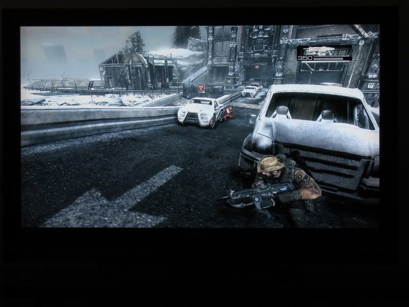

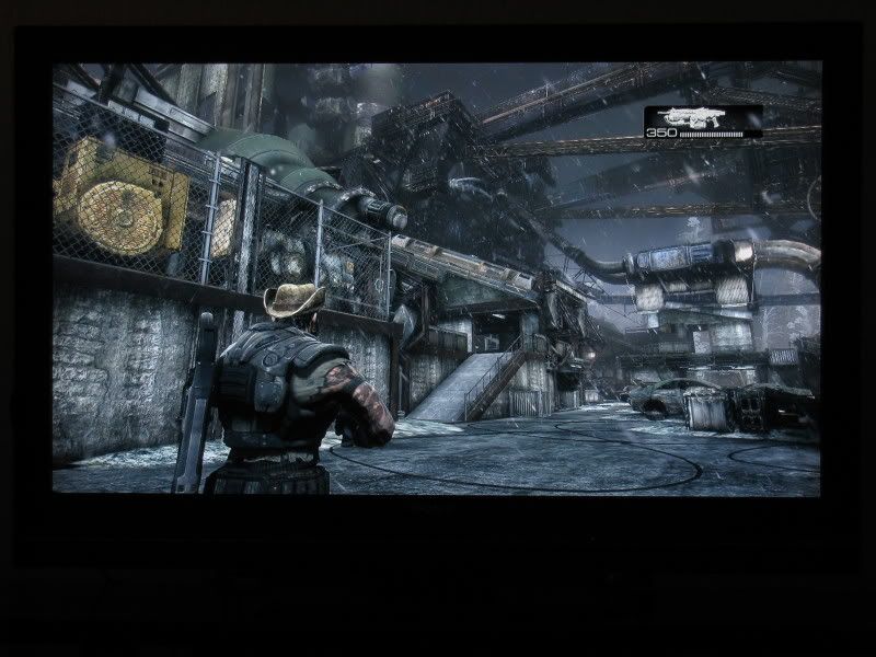

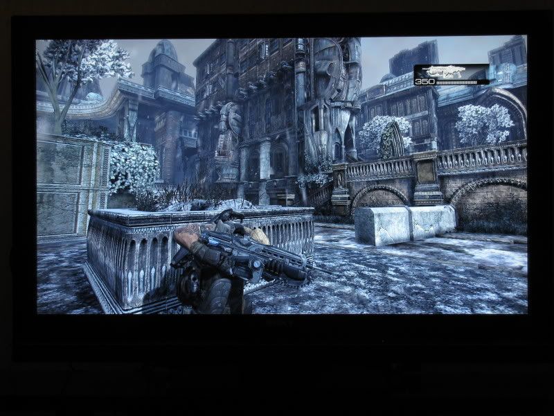

My daughter plays a game with dark jungles and dark dungeons, as soon as she enters a dark location in the game the screen stays normal for few seconds and then dims to a level where you can’t see much detail and as soon as she enters a scene with some brightness, the TV almost instantly returns to normal brightness. It seriously interferes with game play and game mode does not help.
