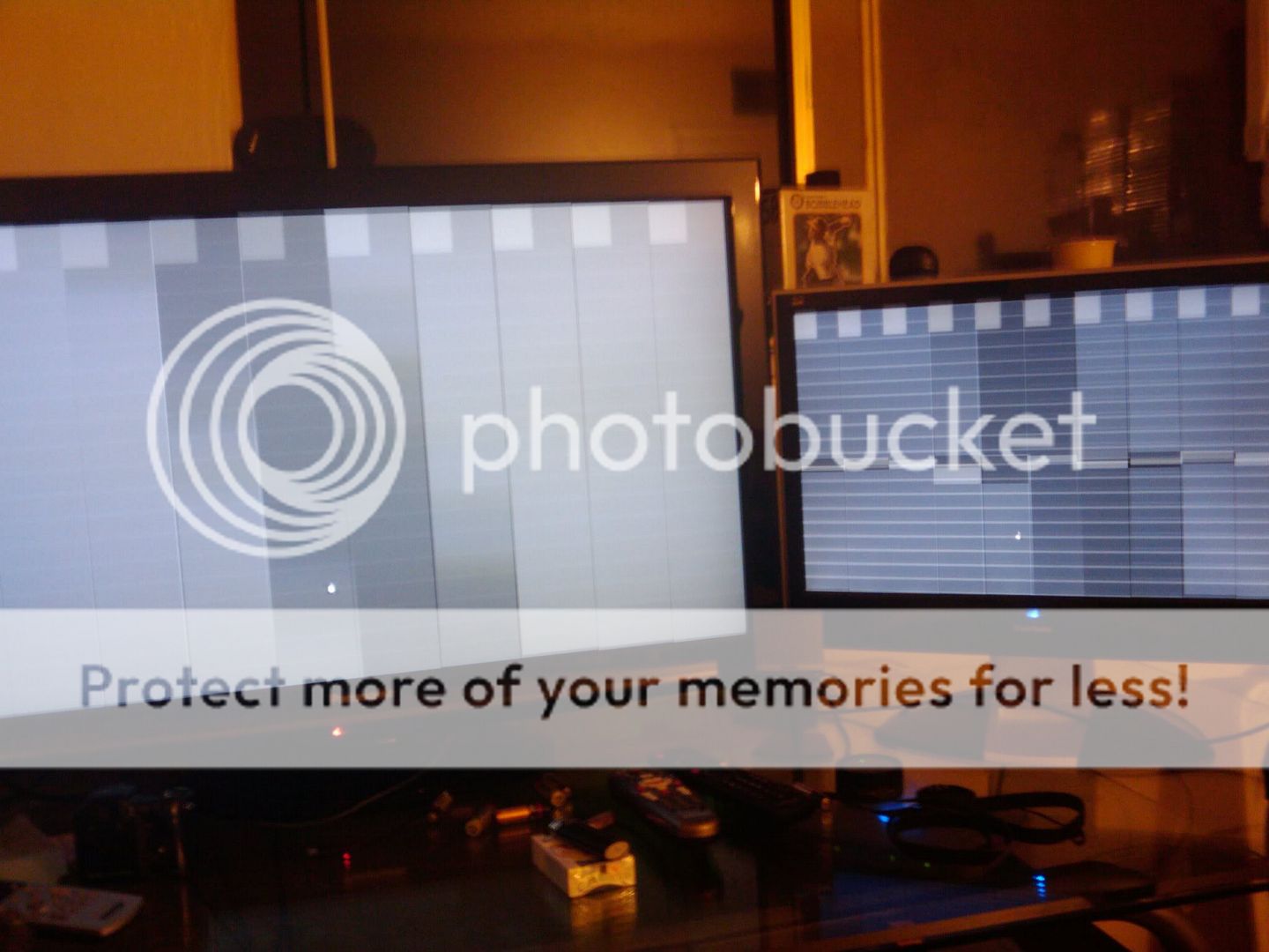

I made a lag tester that is easier to use and more accurate than the number based timers:
http://lcdlagtester.googlepages.com/
Someone else independently made a very similar tool:
http://www.hardforum.com/showthread.php?t=1423433
Each bar represents 16.7 ms of lag (1 frame). It takes about that much time for a black pixel to turn white, so a lot of the Lag reported on the counter based tests are just because of contamination between two different frames.
LCDs refresh from top to bottom, so the solid white bars look like a gradient as they turn on.

When doing tests I would recommend testing your video card to make sure the ports output synchronously. On one of my machines, with an 8800GTS, one port lags behind the other by about one frame.
Just rerun the test and switch which monitor goes to each video port.

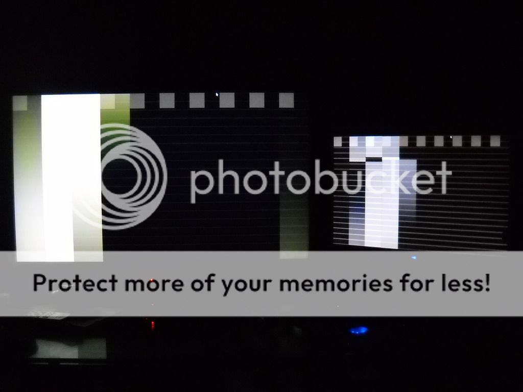

I made my lag tester quite a long time ago, and it didn't seem to be working correctly when I tested it today. I recompiled it with the newest version of Processing. It is now working on 3 Windows PCs I tested it with.
Don't use it if you are sensitive to flashing lights.
http://LCDLagTester.googlepages.com/
These were taken with a compact digicam. I have a DSLR, but it isn't really needed for the test.
My monitors seem to have a slightly different refesh rate, as the monitor on the left has a tear that slowly moves down the screen. It still covers exactly the same amount of area per column, though.
jensend is offline

Ok, first of all, the monitor I'm using is a very old AOpen F2705 17" monitor which I believe is a TN panel. The highest resolution that both monitors support is 1280x1024. My LH90 is set to ISF/Expert 1 with Local Dimming ON. You can't adjust the shutter speed on my SD780IS, but I set the ISO to 1600 (I heard you should set this as high as possible). A lower ISO setting made readings unreadable. I took 3 pics that were the easiest to read.
So I got 31-32ms (edit: actually, the first shot looks like it would be 27ms). Local Dimming being ON might have caused a tad bit more lag.

not bad, yeah shut off local dimming and retest.
also turn on game mode if you have one or if there is a picture mode called game or PC set it to that.
you want to disable as much pre-processing your TV does as possible to get the best results

ok so i got my hands on a low end nikon that unfortunately you cannot control the shutter speed on.
i could only manage to get it to auto detect a shutter speed of 1/30, its not ideal but heres one of the better shots i pulled off.
shutter speed definitely effects how good this test comes out and any other test because when this same nikon auto set shutter speeds of 1/15 or 1/8 i saw blurred photos much like the one i posted from my cell phone camera
this photo shows that my TV is about 1 frame behind the TN LCD monitor, its likely behind 1 frame because my PC monitor is only capable of 1680 x 1050 so my video card is scaling the output to my Panasonic to 1080p resulting in lag.

The LH90 does have a game mode, but I already moved the monitor away and I'm too lazy to move it back right now. Plus Canada is playing Slovakia in Olympic hockey. :P
I wanted to test the settings I would use when I play games. The AOpen F2705 is so old (it doesn't even have DVI!) I doubt it has much (if any) input lag. So yeah, 31-32ms of lag with local dimming on and not using game mode is quite good IMO. A noticeable improvement over my old A650.
