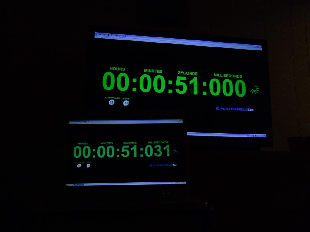

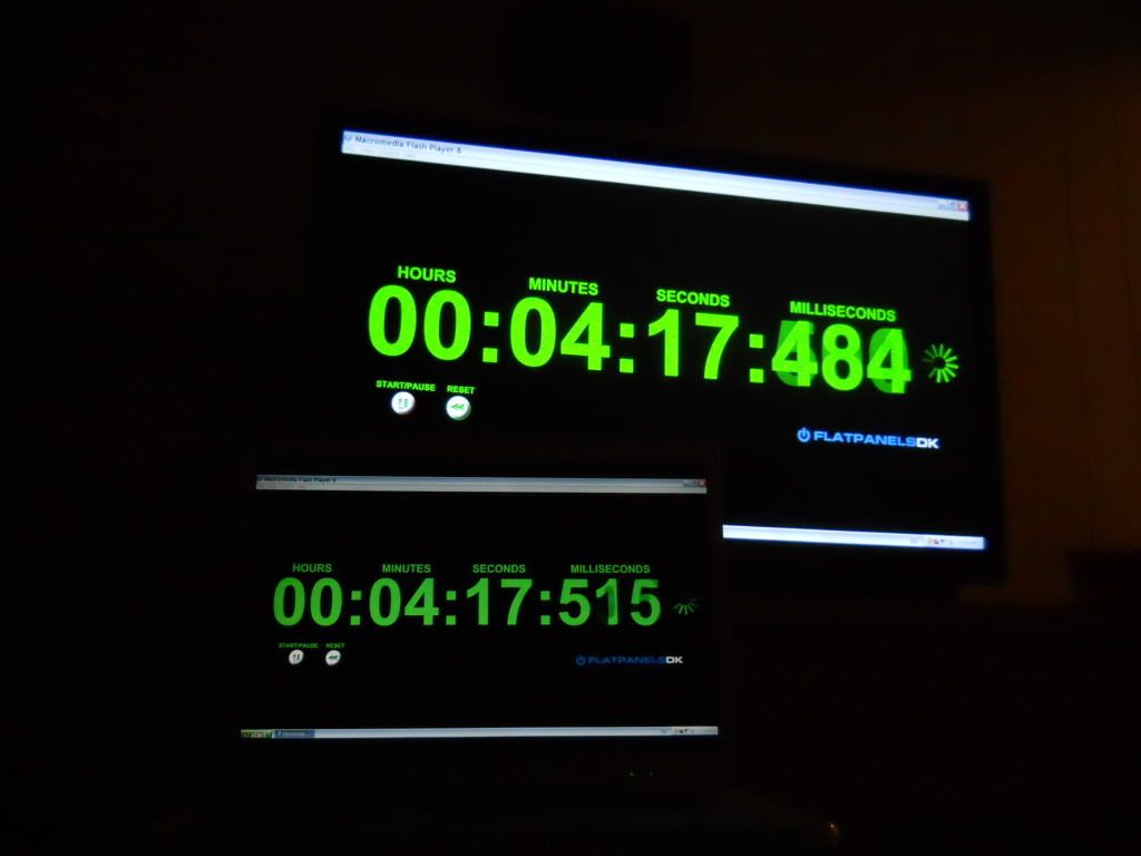

Stop Watch In Game Mode:
You can see the 500 start to come through below on the tv, and the 500 leaving on the laptop, things like this make it a little trickier to read. Result below is 15ms.
Stop Watch In Standard Mode:
SMTT in Game mode:
Method: I used my laptop in clone mode using a DVI to HDMI cable going into HDMI 4 on the side of the TV. That input is also labled "PC".
The shutter speed used to take the pictures was 1/125. I did figure out after I took the pictures how to make the camera's shutter speed go up to 1/200 which is a lot faster. I feel I need to do the SMTT again using that 1/200 shutter speed for better accuracy, but its too late and I need to sleep. I'm not doing the stopwatch again as 1/125 I'm sure is fast enough for an inaccurate program like that.
Summary of Results:
The stop watch in game mode shows 0 to 1 frame of input lag. 0-16ms
The stop watch in standard mode shows two frames of lag around 32ms.
The SMTT shows anywhere form 15-19ms of input lag very consistently. Remember to read the SMTT you take the highest number on each display and compare them. Also It can be hard to read some of the numbers. SMTT is fast enough that pixel response time plays a part in trying to read it. I took the highest number that started to come through, where the old one might not necessarily be gone yet.
I will try to do the SMTT again using 1/200 shutter speed.
Note: Using the clone method can be off because the laptop display might add a little bit of lag, making the two results closer together. Even so, these numbers will still give you a good idea.
Note 2: The TV (American VIERA TC-L42E30) is updated with the latest firmware v1.20. After putting the input on Game Mode, the TV was shut off and turned back on. The stopwatch program an installed .exe from http://tft.vanity.dk/. The smtt high accuracy stopwatch was from http://translate.google.com/translat...&ie=iso-8859-1 cost 5 Euros
Edit: oops I just realised I cut the tops off some of my SMTT pictures, I will try to do that test again for sure now.

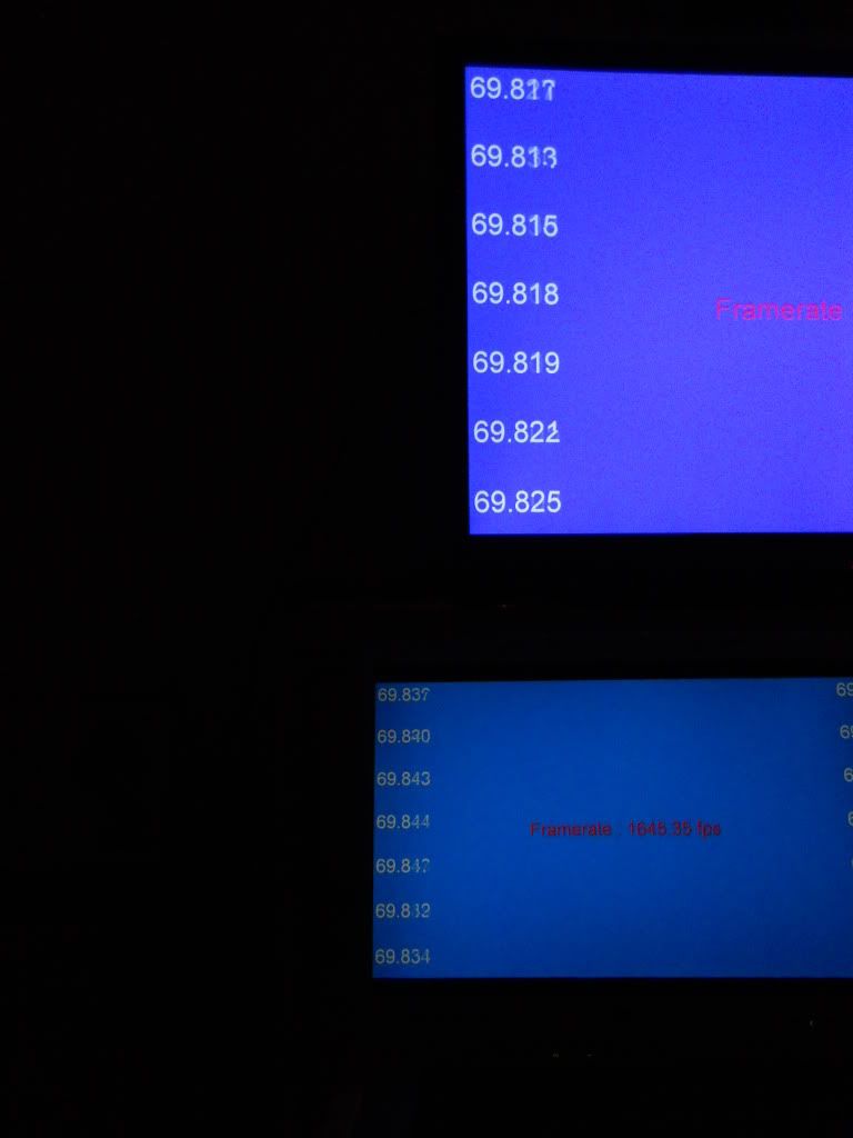

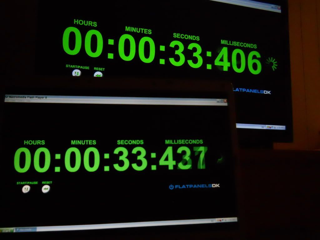

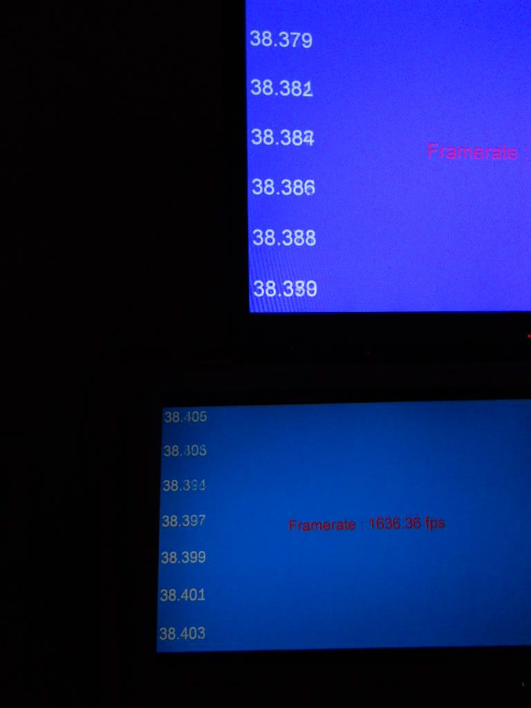

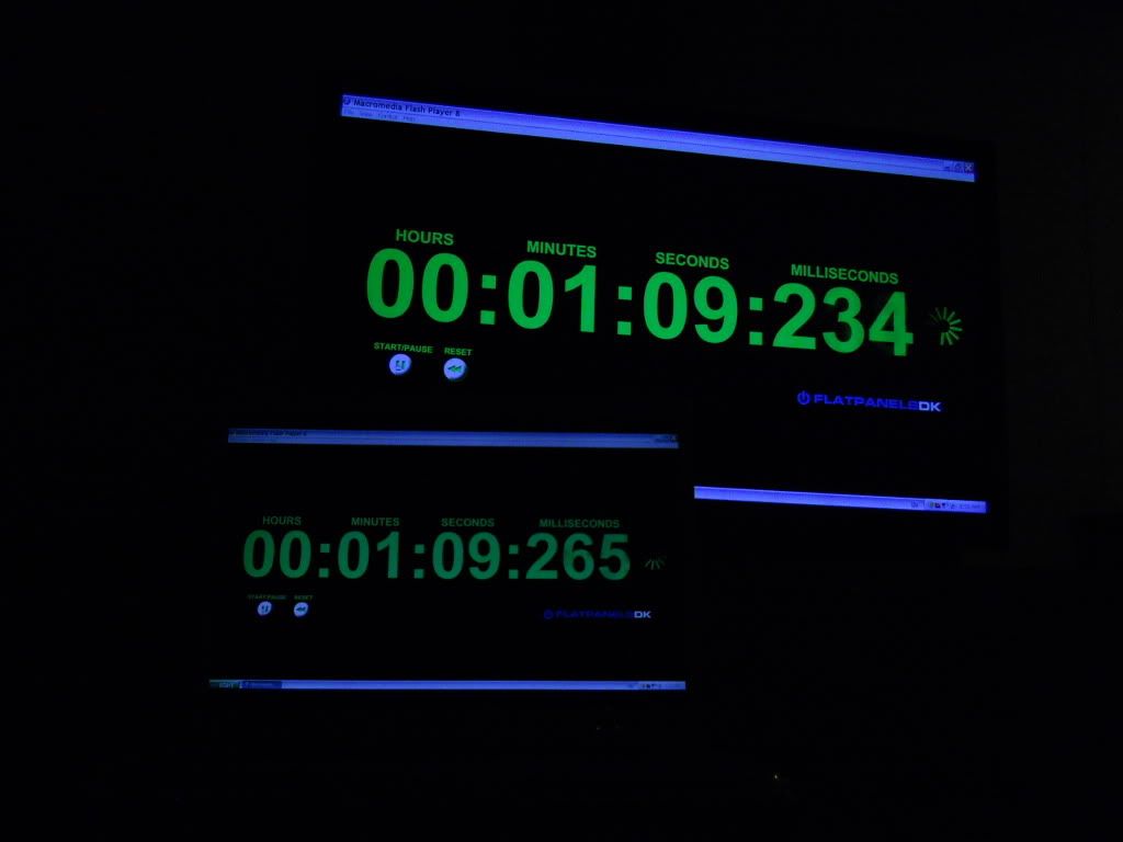

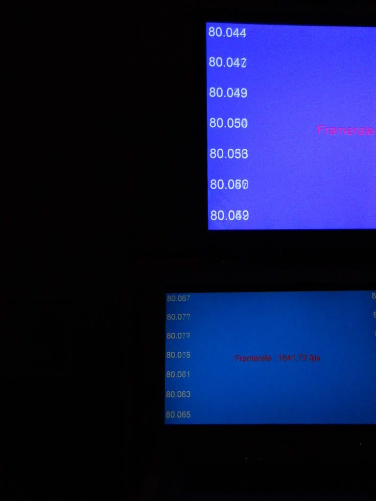

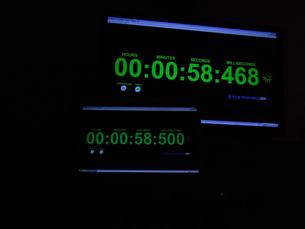

My friend brought over his high speed camera, and I got some concrete input lag results for the Panasonic Viera TC-L42E30. His camera has a shutter speed of up to 1/4000 but I believe we used 1/2000 for most of the pics. The comparison monitor used is the Samsung XL2370 which has been rated as having 0-8ms input lag by digitalversus. The lag on this Panasonic HDTV is very low and averaged to about 1.5 frames of lag, about 25ms as compared to the computer monitor. There were several instances of 0-10ms input lag, and just a few instances of 40ms input lag which could easily be the result of 2 consecutive 20ms updates by the stopwatch and so still be in the 2frames range. What this means to me is that the TV normally has only 1-2 frames of lag, but can appear to have 3 frames of lag on a rare occassion if caught by a highspeed camera while the tv or monitor is midscan. The TV may have a maximum input lag of 3 frames if the comparison monitor occasionally has 1 frame of lag. If we are to assume an 8ms lag on the computer monitor, that puts the Panasonic Vierra TC-L42E30 right at 33ms on average, which is 2 frames of lag on a 60hz television. That is very good! I used 3 different stopwatches. The primary one I used, with the green color is the one designed to test input lag by flatpanelsdk and it appears to update itself every 10-20ms depending on the frame (either 10ms or 20ms increments), whereas the second stopwatch seems to only update in 33ms increments. The final stopwatch only seems to update every 58ms, and is therefore too inaccurate.
These tests were performed in game mode. I did not test non-game mode.
Uploaded with ImageShack.us
This is the primary stopwatch I used, and appears to update itself in 10ms or 20ms increments. The most common delay I found was 20ms according to this stopwatch, with 10ms being the second most common. This first picture is taken with 1/200 shutter speed and so is better lit, the following pictures were taken at 1/2000 shutter speed and so they are darker and you can occasionally see the monitor in the process of scanning (half the screen looks dark).

The above image shows a 60ms input lag, however you can see that the hdtv was in the process of scanning in to 40ms, which means this lag still represents about 2 frames of lag
This stopwatch appears to only have 33ms increments, with occasional 34 ms increments.

This is the poor stopwatch, which either shows 0ms delays or 58ms delays.
Overall I took about 50 photos, primarily using the most accurate stopwatch which is the one in green, which appears to update every 10ms-20ms. The most common input lag seen by far was 20ms, the highest seen was 40ms although there was one outlier of 60ms which was in the process of updating itself, and the minimum input lag was 0ms. Overall I rate this TV as having somewhere in the range of 1-2 frames of input lag on average, making it exceptionally fast for an hdtv.
what is the lag of the laptop display?
i tested a 55" xbr55hx929 and came in at about 28-30ms of lag in game mode so its about the same as panny nice

Looks like the laptop display has around 1 frame of lag.
