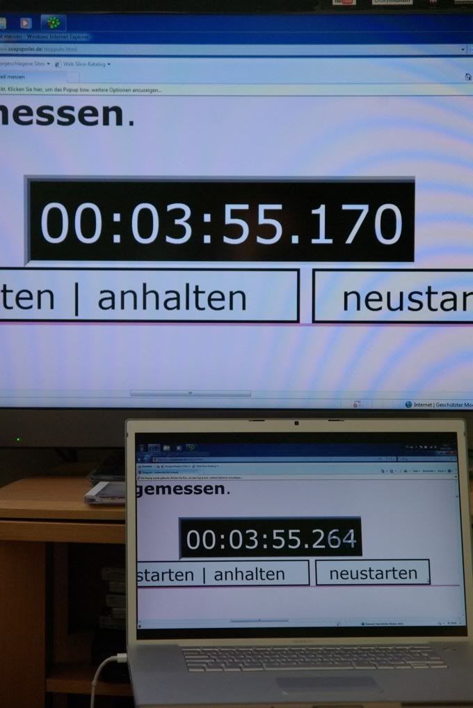

There are some input lag tests that have been done on the EX500, tho I don't know how accurate these might be, since they were made with a laptop...
Here's the video:
http://www.youtube.com/watch?v=yy4p7yTpZ9w
Here's a picture:
How can those number, especially with a laptop, could be so high? I just puzzles me!
Here's the video:
Here's a picture:
well i will tell you this about the accuracy of input lag tests, if it is inaccurate it is more than likely showing the TV to be faster than it actually is
in fact i can almost guarantee you it is.
you have two factors at work that will effect your readings as long as you only keep the lowest score ones you can make out (thus nullifying flash based timer and sync issues between the display, something that SMTT fixes for you and why i recommend it)
#1 the input and pixel lag of the control display will reduce the reading you come up with on the TV because if the control LCD has 5ms input lag (pretty common for a cheap LCD monitor actually) and about 5 ms pixel response time (also very common with cheap LCD's) then you can almost always add 10 ms to lag tests performed with a laptop or LCD monitor sometimes as much as 30ms though if you have a laggy VA PC monitor or a TN panel that has overdrive (RTC) that you cannot disable in its menus (most can disable it now because of input lag)
#2 port delay of the video card used to test, this is less common most Nvidia and ATI cards have little to no delay between their output ports when in clone mode provided they are at the same resolution (video card is not upscaling say 1680 x 1050 to 1080p, this happens a lot though in tests even ones i've done with my 8800GT) however at least Nvidia's scalier is so fast that doing this appears to only make the TV appear slower by around 5ms at most so its not a real big issue.
however there have been a couple instances where a person has found that their video card delays one of the outputs by exactly one frame or 16.6ms and if the TV happens to be connected to this port it looks 1 whole frame slower than it is, if its the other way around then the TV appears to be 1 frame faster than it is. this is easy to test for with a PC by swapping ports and doing the same test and comparing the results. with a laptop its still possible to check it as well as the LCD in the laptop for input lag by doing an input lag test on it vs a CRT monitor

Well, that's pretty much what I thought. The laptop itself probably lags a little, so there is a chance that the EX500 input lag might be above 100ms... ugh!
Here's the video:
That looks like the same 2008 MacBook Pro I used for some of my tests. I measured it at less than one frame behind a CRT, probably more like .5. This was before I started using SMTT, so it's not a precise value, but it's enough to make me think it's reasonable for use as a benchmark display.
I have to say that 100ms is appalling for a "game" mode, but it matches my impression from some in-store testing of another Sony 120Hz set (V5100.) I don't have hard numbers, but it was slow in game mode, slower in 120Hz mode, and the motion smoothing didn't even work right -- it made Rock Band lyrics stutter and jump.
His other video of Counter Strike really shows how high lag can mess up your game. When he moves side to side quickly, you can see that he's sometimes facing in the opposite direction from what's shown on the TV.
wondras is offline
