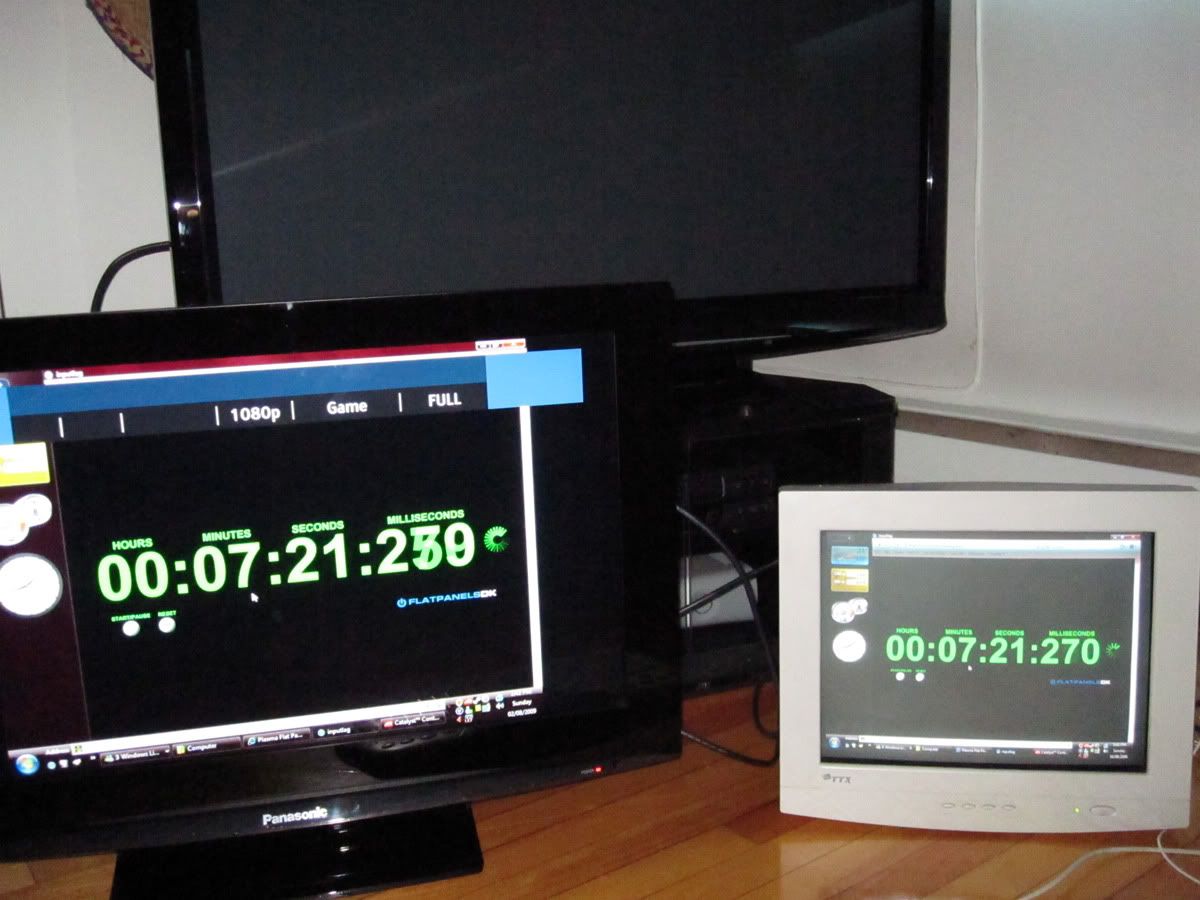

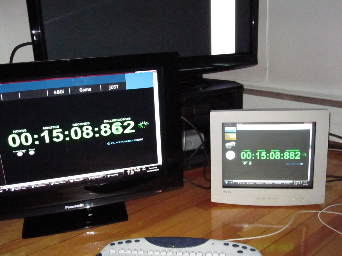

Originally Posted by Frito View Post
Panasonic 32" LZ800 HDMI (unknown resolution looks like 720P in photos)
That pic is actually in 480i
Here some better picture quality
1080P standard
1080P game mode
480i
youtube video for confirmation under both resolution vs real time.
I hope there's enough reference. The LZ800 is a 1080P panel.
Mr Deap is offline

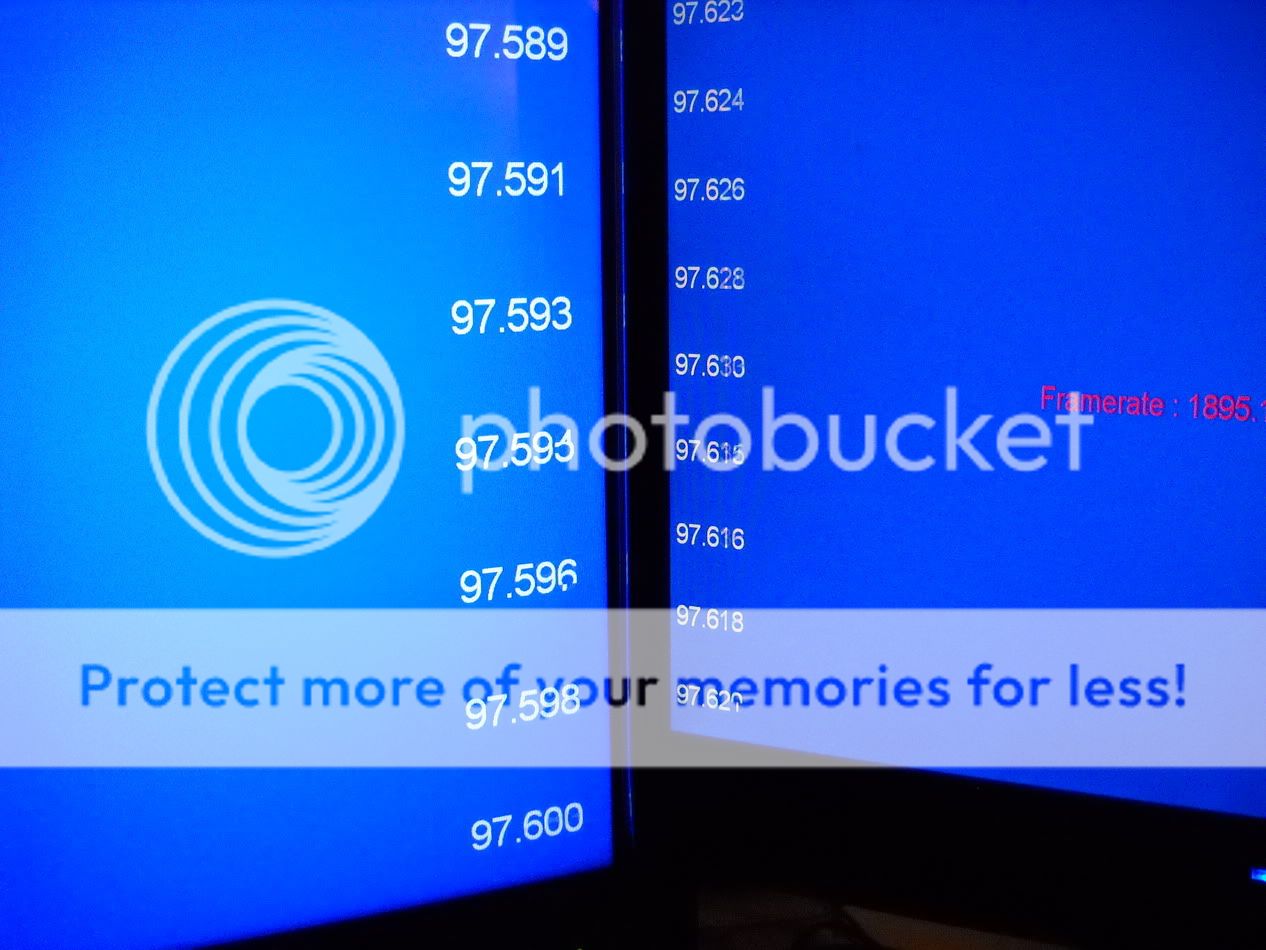

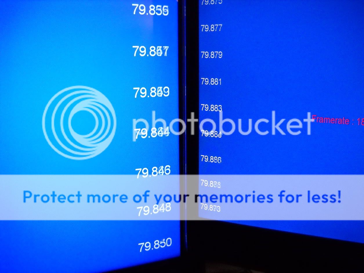

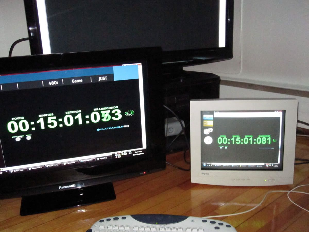

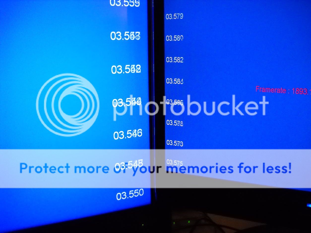

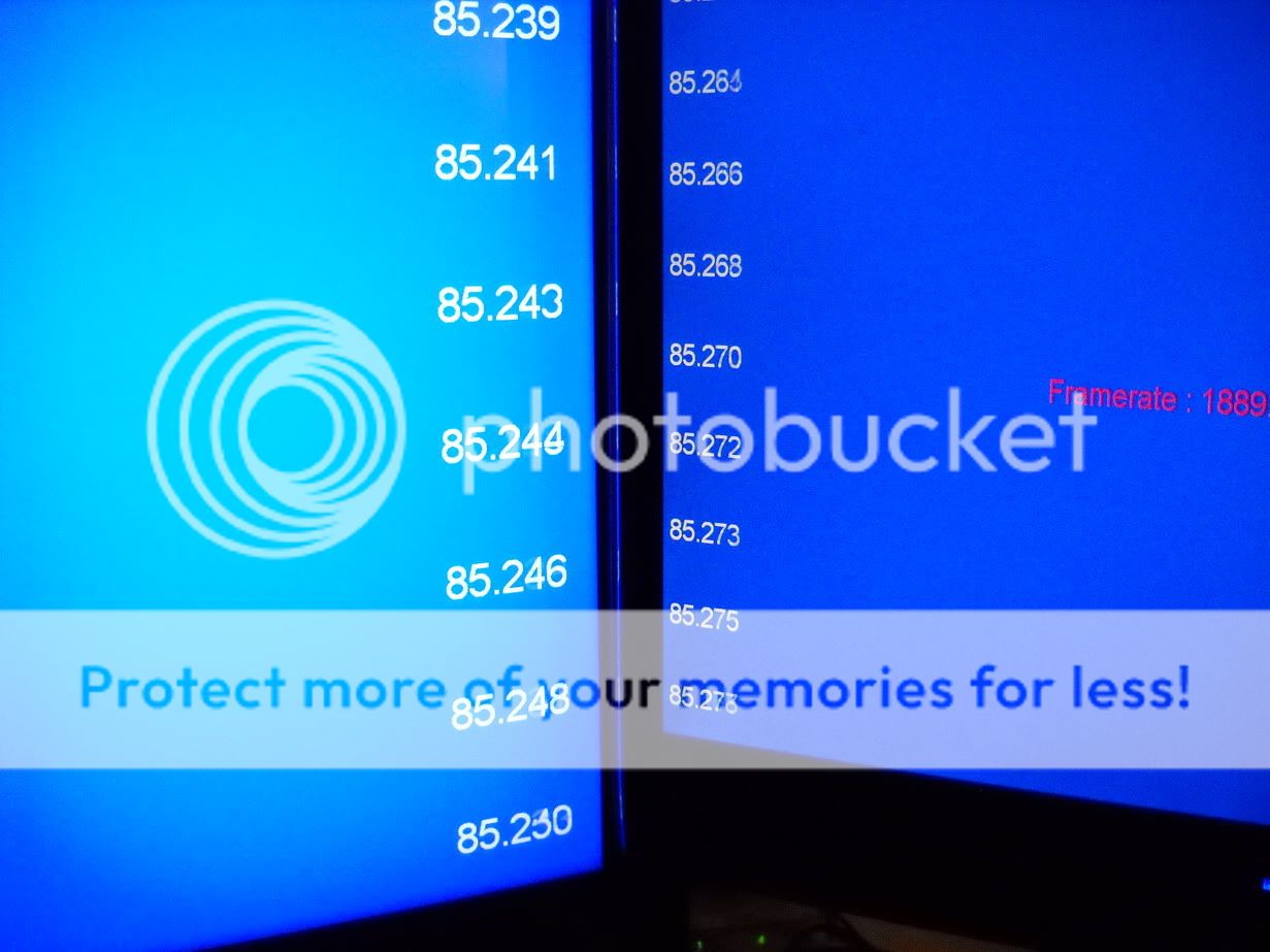

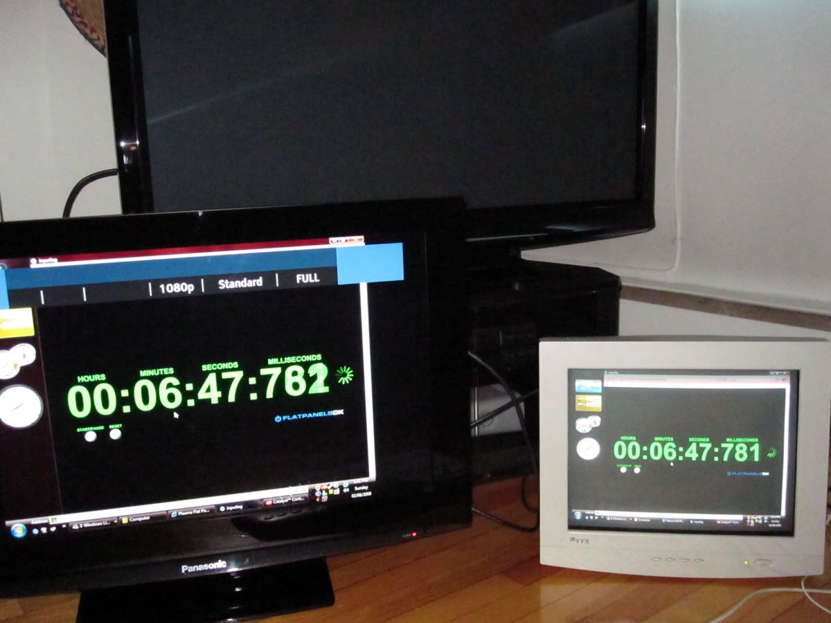

cross posting HidefLoans test post from the Panasonic 32 S1 thread
Originally Posted by hidefLoans View Post
I ran some new input lag tests:
the TC-L32S1 is running at native res, while the CRT is too, but the whole desktop does not fit in its max res so only a portion of the cloned screen is visible on the CRT.
Game Mode:
Best result 0 ms, Worst Result 32ms
Standard Mode (motion focus off):
Best result 0 ms, Worst Result 32 ms
The most usual result is 16ms for both modes.
Some results from Game Mode:
Some results from Standard Mode:
Other findings on usign this tv as a monitor:
Darker colored text works ok, however lighter colored text just does not look very sharp on this TV, no matter what setting. I still have not ventured into changing service menu values to see if this can be improved more than I have with the menu settings. Lowering saturation is the only way to somewhat improve fuzzy red text, but you can't entirly fix the problem. With small text I noticed a pale orange, muddy pink, oversaturated green, blue, and light blue text colors. Basically, almost every small light colored font will not look good with the TV, and I think this is probably a problem with the size of the pixels more than anything else. It is a TV not meant to work as monitor.
For games it is very very good. Motion Focus on this set is backlight scanning at a normal 60hz refresh rate. It only helps with slight slow movements across the screen, as fast movements will still produce more visible regular LCD blurring. Since it adds a slight flicker to the image, it can only be used while objects are moving on the screen (gaming, video), otherwise this flicker is bothersome when using an operating system.
I might give it a couple weeks before deciding if I will keep it, as for now I don't think it can really replace a regular monitor as a pc display. The muddy or blurry small colored text thing does bother me, and I don't think any 32 inch TV is going to be good in displaying small colored text unless you sit at least 4 feet away from it to combat the blurry effect (but not the muddy color effect).
I know this Set is pretty much the only good low input lag 32 inch tv at the moment. I feel like the size is nice, but I could do ok with something a little smaller, maybe around 26 inches. An actual pc monitor but still 1080p native. We'll see. For the moment I'll keep trying it out, because it is awesome for games, just not the best monitor for pc work.

MOST panny LCD's use IPS panels are very fast, i've yet to see a panny LCD that was laggy so they are a good choice
as I could not find a 37" S1 locally (sears let me down by saying they had 3 in stock but did not) I found myself at a best buy last night trying to decide between a Panny 42" C12 that appeared to be a VA screen to me (pixel structure was a V shape turned sideways IPS are I shaped pixels, you can see this if you look at the screen very closely with your eyes
so i was like damn, well i've always heard Toshiba had low lag in game mode (30ms) range and it was down to that 42" panny or a Toshiba 40" xv645u
I was almost set on the panny just based on its a panny and it should be nearly lag free but i could not help but notice that the toshiba had a better picture (yes i took them both out of store modes etc.) and the toshiba was 120hz to boot at the same price point of 700 so it was a tough decision but i decided to gamble on the toshy figuring at worst its going to lag like my Sony 32XBR6 it was replacing and at best it would be faster plus i was gaining 120hz and 8" of screen
mind you this is a PC monitor/bedroom TV and I am sitting 2-3 feet from it when at the desk so even going as big as a 40" is pushing it a bit but there are just no good choices in the 37" size that local stores carry
anyways without further a due the next post is my results from doing a quick input lag test on the Toshiba
If you're a gamer or interested in using an LCD TV as a primary monitor take a look at my thread on Input Lag

Toshiba 40xv645u 120hz
1080p Game mode on VS Viewsonic 22" TN panel (tested and has negligible input lag of a few ms at most)
27ms input lag on Average
out of 11 pictures
Best 20ms
Worst 34ms
not bad!!! a definate improvement over my Sony 32XBR6 that averaged 47ms and never got below 32ms ever in many more tests
and now for the photos
there are more but that should be plenty you can visit my photobucket if you would like to see the rest
overall i'm extremely happy with the Toshiba 40xv645u, picture quality is at least on par with the 32xbr6 if not better in other areas and use as a PC monitor is in fact better, almost no adjustment is needed for the desktop and all text even REDS! are sharp and clear
this Toshiba is definitely a winner for gamers, its not lag free but you can get the best of both worlds in having a decent 120hz set for movies and TV along with good response speed for gaming. a pretty good compromise considering that the majority of 120hz sets out today will be 1.5x to 2x more laggy than this display in game modes from what i've seen and read
frito is offline
