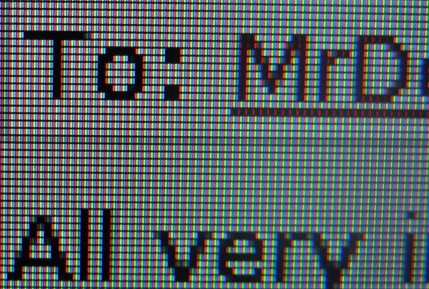

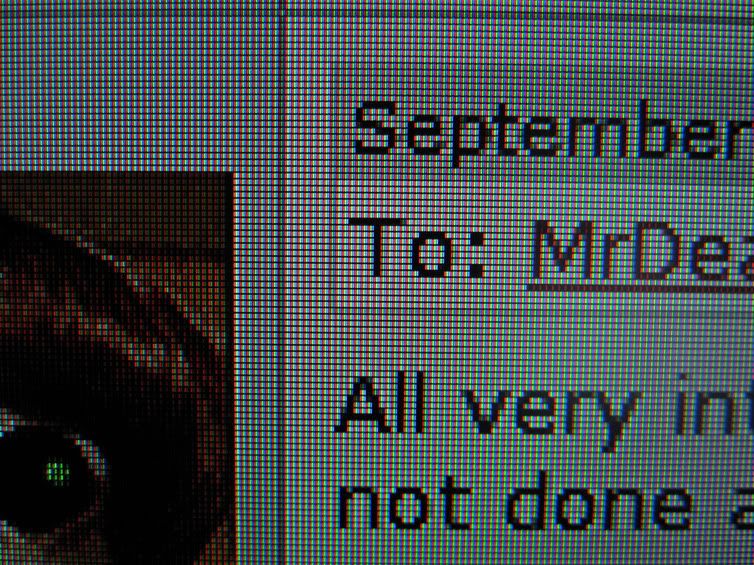

Originally Posted by wondras View Post
I just got back from another trip to BB, this time armed with an XBox to do some more lag testing, and a camera to check out the pixels on the L42U12. I *think* we have another panel lottery on our hands...
This is the L42U12:
For comparison, this is a Toshiba 46XV645U:
It clearly show that the U12 is not a IPS alpha.
That how it should look actually look.
My LZ800 is glossy. It's easier to see the form of the pixel.
Originally Posted by frito View Post
Yeah the Toshiba is clearly a VA panel, i own that TV i know it is for sure
the 42U12 photo is clearly an IPS panel but not an IPS-Pro panel as used in the 32" and 37" S1's
it looks like an LG Display IPS panel they have the slight v shape
http://www.ips-alpha.co.jp/en/technology/ips.html
That's pretty much how it is. Not all Panasonic LCD are actually IPS alpha. It's better to bring a digital cam & actually take a picture of the pixel to make sure.
Though IPS alpha panel can be seen from very far, because it's like night & day in comparison to usual IPS panel.
Mr Deap is offline
post #184 of 4393 Old 02-16-2010, 12:16 PM
wondras's Avatar
Posts: 146
Definitely -- there are no IPS-Alpha panels larger than 37" at this time. S-IPS is still pretty good, except for the black levels.
Thanks for the pic that shows what an Alpha looks like. Thats some pretty small text you have there! Definitely 1:1 pixel mapping, too.
wondras is offline

I guess this means the short answer to the input lag question is: find a set with an IPS panel. IPS-Alpha is better than S-IPS, but both are much better than the various forms of VA panels that are used in most sets. The price you pay is poor black levels.
The specific sets I've seen mentioned so far are:
Panasonic
TC-L32S1, L37S1, L32X1
These all use IPS-Alpha panels, and have the lowest lag available.
TC-L37X1
Not IPS-Alpha (probably S-IPS), but still low lag
TC-L42U12 (Best Buy Exclusive)
Some of these use S-IPS panels, and some VA. The IPS sets have low lag, the VA sets don't. You can look closely at the pixel structure to see which panel a particular set has.
LG
37LH20 - I bought one in January, which has an S-IPS panel. Decently low lag, maybe not quite as good as the Panasonics.
37LH30 - early production units are S-IPS with low lag, current units are VA with high lag.
Various other LH-series sets - Unknown, and probably vary between production runs.
I don't know of any other specific brands/models that have IPS panels. "IPS Alpha Technology Limited" is a joint venture of Hitachi, Toshiba and Matsu****a (Panasonic), so they will probably show up in some Hitachi and Toshiba sets soon if they haven't already.
Of course, these are all 2009 models, which are disappearing fast. (Best Buy discontinued the L37X1, and Sears won't even accept orders for the L37S1 in my area.) The L37S1 is one of the best in this bunch, and I don't see anything in the currently announced Panasonic 2010 lineup that matches it closely.
Good luck, folks!
More great info, and yet, very troubling for me lol! I didn't realize that the tv I'm looking at is a BB exclusive. I hate buying large items at BB. More so the one closest to me. It's usually a big hassle because a lot of their employees are not even close to being half way trained primates! I'm not real hip on the "panel lottery" idea either.
Even if I could distinguish the pixel structure on the floor model, need to read back through this thread to figger out how, there is no guarantee that I will get an IPS panel in the set I'm buying. I really don't want to go smaller than a 40" or 42" set either.
Black levels are not a huge concern for me. I am by no means extremely picky about some of the things that most would flip about on here. I thought my old Westinghouse 720p set had a really good picture, and my current Sharp Aquos 720p is really good to, so just about anything is a step up from those 2.
All signs point to this being only S-IPS, I speculated it may be VA when i saw it at best buy because i seen a V shape to the pixels and viewing angles were similar to the Toshiba 40xv645u but i'm pretty sure i made the wrong assumption
it has decently low lag for a LCD TV at 15-30ms putting it in the range with the other S-IPS 60hz TV's from panasonic and LG
the higher end LG's as well as some Vizios and some Toshbias 650U's definitely use LG's S-IPS panels, this is often evidenced by the screen size of 47" which to date has only been made by them
input lag on these TV's is often in the sony/samsung range of 45-60ms and i attribute this to them using more aggressive RTC on the panels in order to accommodate for 120hz, because it makes no point in advertising a panel as 120hz if they pixels cannot change state fast enough to actually achieve that update speed as well as just plain having more image processing built in that may or may not be reverse able but not enough owners of these TV's have come forward with test results on them either so its mostly speculation on my part
If you're a gamer or interested in using an LCD TV as a primary monitor take a look at my thread on Input Lag
This post by sharky974 casts serious doubt on the consistency of the L42U12. I'm basing a fair amount of my conclusions on manual Rock Band calibration tests, so I believe his auto-calibration tests show that his set was somehow different. The panel seems the most likely change.
It's maddening -- the panel type has a huge impact on many aspects of performance, so this is just one more way the consumer is getting hosed. It seems they shouldn't be able to hide behind a "specifications subject to change without notice" disclaimer. Should they really be allowed to change between the time you read the outdated specs and click "Add to cart," and when it shows up at your door?
I wish I knew of a good way to draw more attention to this issue. I felt forced to deal with local retail stores because of this, which I really wasn't happy about. Still, all's well that ends well, and I think I did come out of this pretty well. It's kind of sad, though, that my "best" choice was one of the cheapest name brand 720p sets available. At least "cheap" was in the equation.
Anyone want to take a guess at what type of panel this is?

It's not a multi domain VA panel that is for sure, the V is the opposite direction of LG panels I've seen macro photos of so i'm not sure unless the camera/photo is turned upside down
The camera was taken in the correct orientation. If it makes any difference, I captured an input lag at around 12-14 ms.
