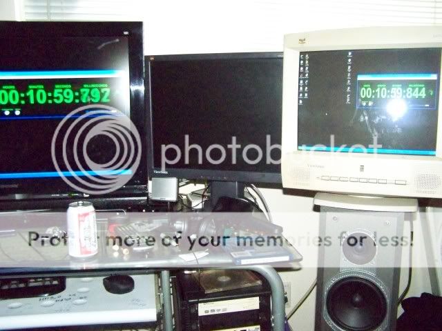

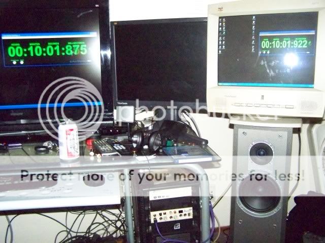

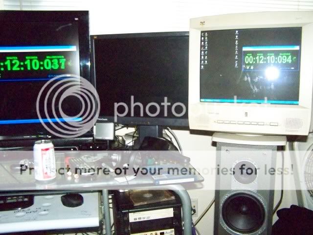

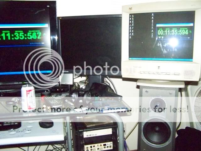

notes: was tested vs a CRT monitor with an average of 14ms delay of picture with many displaying 0 ms delay, one of the best gaming TV's today for sure, the smooth motion feature appears to just be a scanning backlight and does not impact input lag but appears to show some visible flicker. Tested by hidefLoans
LINK TO PHOTOS

notes: this is my new main PC monitor, text is not perfect 100% of the time. these Panny TV's have a strange problem with displaying red and blue text ONLY on dark/black backgrounds, text otherwise is very good once you get the picture settings set right and running cleartype tuner in windows helps some more as well. optimal Sharpness on these Panasonic's is 0-10 at most, the sharpness setting adds edge enhancement at anything over 0. Tested by Myself
LINK TO PHOTOS

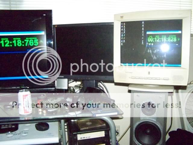

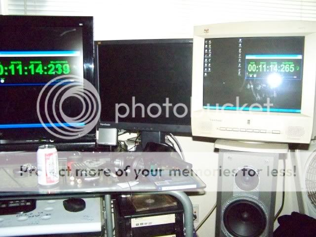

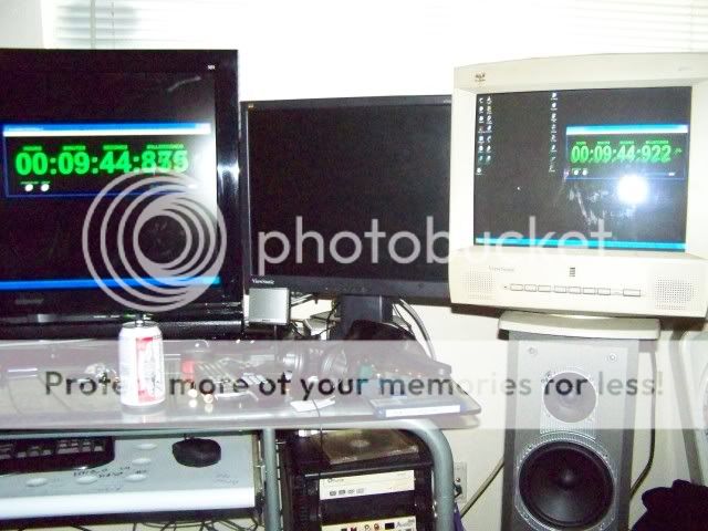

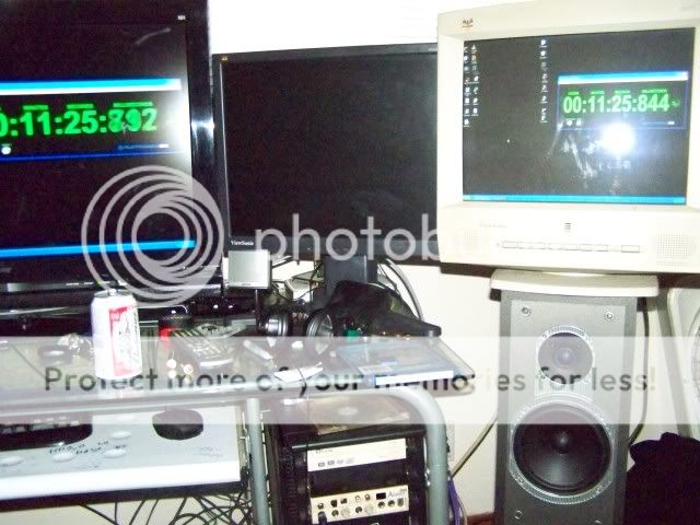

Sony 32XBR6 (jan 09 build 205r FW) vs viewsonic 17" CRT monitor
1080p HDMI input on all tests
Photo mode (game mode is disabled in this mode)
Video mode W/ Game mode ON
Video mode W/ Game mode OFF

Guys can you please post a summary of what your pictures show so that my brain doesn't have to do the math. This means you Frito
So something like:
Sony 32XBR6
Photo Mode (game mode disabled) : 30ms lag
Viche is offline
post #9 of 4399 Old 03-21-2009, 10:57 AM - Thread Starter
frito's Avatar
Join Date: Mar 2009
Location: east SF bay area, ca
Posts: 3,396
So something like:
Sony 32XBR6
I did its in the first post.

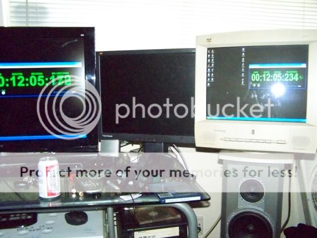

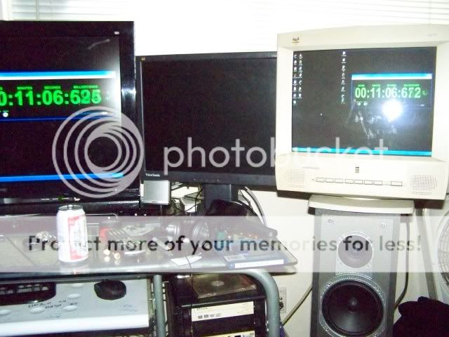

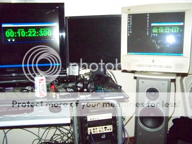

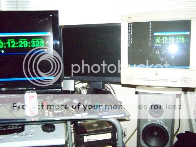

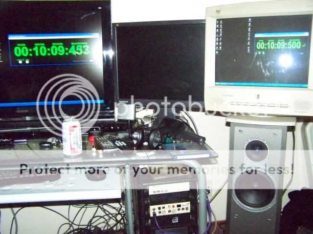

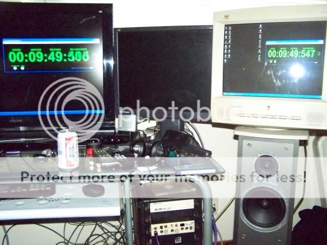

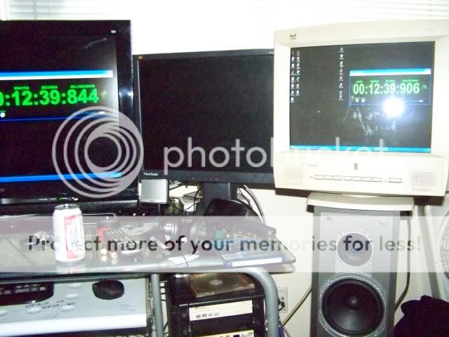

2nd round of tests on my 32xbr6
VGA @ 1280x1024 (couldn't get my video card to output anything higher on clone mode output with both displays being VGA, oddly I can get it to when tv is connected via HDMI though )
720P via Component in game mode
480i via Svideo in game mode
One thing i have found that is odd is i constantly keep coming up with 47ms lag on many inputs more than one time!!
another thing to note is that alot of shots its very hard to determine what the numbers read on my TV screen, I can often go with a higher number and get a better speed number or go with the lower number and get a higher lag number
a good example is my shots in VGA the first 2 photos could be read as either a 47ms lag or 32 ms lag and then the other 3 are 32,31,32 respectively
I will post my averages in the top post of the thread, and i will be using the HIGHEST lag numbers i could read to figure in the averages

haha you guys ready for this, I just came up with a thought why not run multiple timers on my PC and see if they all jive results wise in each picture?
here are my figures running 3 timers at the same time for each picture
47
47
36lol
46
31 lol
26 rofl!
47
47
27 rofl
47
16 omgwtf!!
47
46
31 lol
47
the average of these figures is 39.2ms
compared to my previous average at this same mode in last test of just 5 readings that was 47ms!
and heres the pics
Clearly this method is flawed, though it does give you an idea of the input lag of a display a person can easily, by taking enough pictures, easily sway the figures of their sets lag by hand picking only images showing the best results, course i think we all knew that already
I think a better timer program that counts time in a linear fashion would be more accurate one that would count like this
001
002
003
004
005
etc.
I think that would provide more accurate and reliable readings.
next though i think i will see if i can find a timer app that maybe works more consistently than this one apparently does!
any ideas?
oh and that cursed 47 !!! i keep seeing it in my tests esp at HD resolutions without game mode on anyways up too late and getting silly here trying to figure out better ways to do this

The problem with running multiple timers at once is that they're all vying for CPU attention. Think of it this way, all the timers ask the computer to update them every millisecond -- the CPU probably can't, considering it's got 3 timers to pay attention to, plus whatever stuff is running in the background, so maybe it skips one...
I guess what people should do when running these timers is increase the priority level to attempt to make the timers more consistent, though there's only so much you can do .
I wonder if we need to start listing computer specs with these tests as well .
Actually, here's an idea for a timer -- why not make a 60 fps video that just has a timer? Sort of like the videos at http://www.mediacollege.com/downloads/video/timecode/ but at 60 fps instead of 30... and you'd just have to make sure the media player isn't dropping any frames.
clicq is offline

here is the first program from http://www.stopwatch-timer.com/
I ran 2 instances of it one set at 1000 sub second mode (milliseconds) and one at 0-60 per frame mode.
and here is the other web based timer program, this one is sort of neat because you can change the number and background colors to get easier to read numbers consistently
my dumb flash was gettin in the way some of the time on these and it was really late last night so i might re-do my test with this timer idk
but anyways both programs vary just like the app we have been using for awhile, give me a few min to figure out the results and ill edit this post with them
ok, here they are, the 2nd set I really need to re-do that timer seems to be the most consistant but i got some real blurry pics + the flash messing it all up so I will re-do them later but here are the results
Stopwatch App
MS F
31 3
74 3
16 1
47 3
16 3
http://www.lagom.nl/lcd-test/respons...ponse_time_gif
MS F
28 2
53 3
42 2 blurry - had to do some guessing
42 3 blurry - had to do some guessing
22 2
1-2 last photo flash obscured the millisecond reading and frame reading showed both numbers on tv lol
