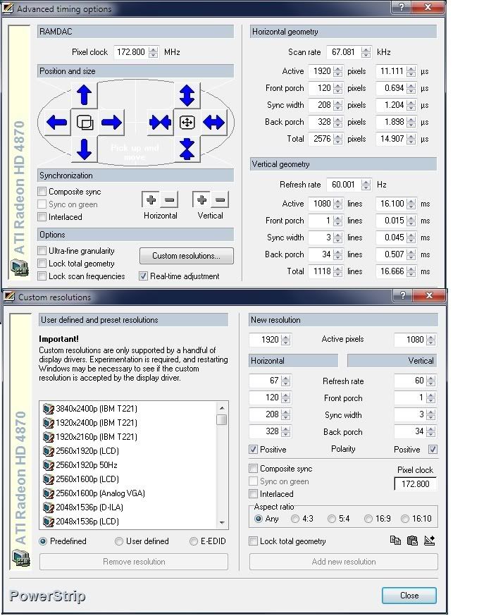

I've had this HDTV for over a year now and I use it as my monitor in crystal clear pixel for pixel 1920x1080@60 Hz WITH THE VGA INPUT. The HDMI display is not bad @ 1366x768 but if you want the real deal this is what you have to do:
Let me preface this with I've have ran into ALOT of things I didn't understand but the use of Google and determination prevailed.
At the time when I first bought this HDTV I was using an Nvidia 7800GT. Nowhere was I given the option to set my TV to that resolution so I came across a little program called Powerstrip thanks to Google. I used it to create a custom monitor driver (.inf file) with 1920x1080 as my perfered resolution. I updated the driver and like magic it worked.
Then I upgraded a month or so later to an ATI Radeon 4870 and I was like, "OMFG! F@#$ ATI! IT WON'T DISPLAY ON MY TV!" After I calmed down I started researching what I could do and my research lead me to the program I already had. Powerstrip.
Once again I used Powerstrip but this time I needed to create a custom resolution and video timings with it. For some reason ATI cards don't like to "try and figure out" what timings your TV likes. You will simply have to "play with" the timings until you're picture is pixel per pixel in perfect clarity. I then had Powerstrip load with Windows and would start with those settings. I would however have to use the auto adjust setting in the TV menu UNLESS I turned on the TV after Windows and Powerstrip fully loaded.
Last BUT NOT LEAST.... I just bought a new ATI card. The 5850. I didn't think that Powerstrip would not support the 5xxx series BUT IT DOES NOT! DON'T PANIC! THERE IS A WAY TO GET 1920x1080 PIXEL FOR PIXEL. Sorry I'm excited because after almost a week of having this new card and trying to figure out how I was going to get it to work with my TV I found the solution:
1. I put back in my old Radeon 4870. I did not need to uninstall CCC as the versions are the same.
2. I started the Powerstrip application and opened the custom resolution/timings settings I had that worked with the 4870.
3. I recorded all the settings such as pixel clock, front porch, back porch, etc..
4. After that I plugged the data into a "video timing calculator" (just Google for a link) to make a modeline used in the creation of a monitor driver.
5. I then input the modeline in another free program by EnTech called MonInfo to make a new .inf for my TV (install via windows device manager.)
6. Finally I restarted and like magic my TV was displaying true 1920x1080@60Hz.
Here is a screenshot of my custom timings. I'm assuming they would be the same for everyone using this TV but you might want to do the above just to make sure. I will list my modeline as well for the lazy that just want to plug it into MonInfo.
The Modeline is: "1920x1080" 172.800 1920 2040 2248 2576 1080 1081 1084 1118 +hsync +vsync
I hope this helps. It was really hard for me to find all this on my own but I think I've made it easy for everyone now. Just do a tiny bit of reading and Google what you need to. It's not really as hard as it seems and you're going to have one hell of a picture. This TV was well worth the $500 I spent on it. Just remember you must use the VGA input on the TV not HDMI. HDMI 1080p has TERRIBLE contrast and text is just really hard to read because of it. Use your component video for XBOX/PS3.
