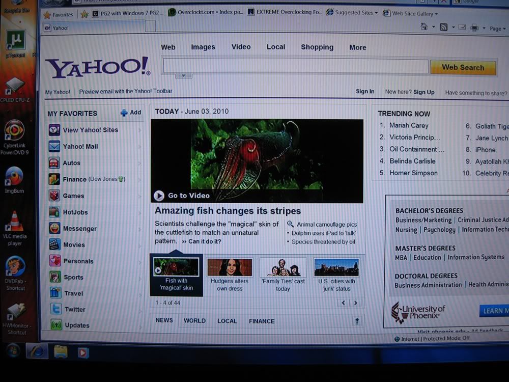

And finally, some 1080P Blu-Ray of Avatar (from HTPC via HDMI). Also a shot of web browsing.
Mode - Standard
Backlight - 7
Contrast - 95
Brightness - 47
DC - High
Gamma - -1
Everything else default, accept AMP off.
