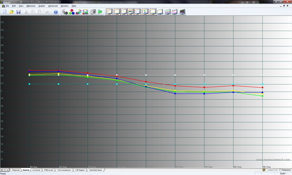

I have an EyeOne LT and took some measurements of my Samsung ln60c630 FB01 panel. I only made a few modifications from the default movie settings. I am pretty impressed with the results considering few adjustments were made.
Backlight 8
Brightness 44
Contrast 90
Gamma +2
Noise filter Off
Mpeg Filter Off.
AMP Clear
I am not really looking to get things perfect but I was wondering if anyone could tell me how to get Gamma corrected as that is what I am mainly concerned with. I used the guide below and I dont seem to see anything pointing how to fix gamma, it really only focuses on Grey scale. Any pointers on how to get Gamma corrected???
Guide I used to get started:
http://www.curtpalme.com/forum/viewtopic.php?t=10457
Here are the readings I got using Color HCFR:

Hey guys, I wrote a little guide on how I calibrated my LN46C630 with my DTP94 colorimeter. You can find it here.
I'll post my settings when I get home, too.
Backlight 8
Brightness 44
Contrast 90
Gamma +2
Noise filter Off
Mpeg Filter Off.
AMP Clear
as for how to adjust the gamma curve
as you already used, the Gamma setting is one
contrast setting has some affect on it
where you center the WB settings does too (the WB offsets also work with the brightness setting in that if you shifted the WB offsets away from center averaged you'd need to then adjust the brightness setting)
then you can also use the 10pt WB controls you might say bump level 1 from say 1 0 -1 to 9 8 7 and then that would maybe make gamma at 10% go from 2.4 to 2.2 etc.
skibum5000 is offline

I would just like to add a word of caution to anyone who is using these advanced calibration settings that others have come up with.
I have a ln60c630 (FB01 Panel) and took a grayscale measurement using skibum5000's settings and using default movie mode with only some basic eyeballed changes and the settings on the default movie mode turned out better.
I am no way am saying that skibum5000's settings are invalid or misleading or that he doesn't know what he is doing. I think that skibums5000's contributions to this forum and this thread are awesome, and that he definitely knows what he is doing. I just want to warn those out there that are plugging these settings or anyone else's specific calibration settings in that their default movie mode may be a better option for them.
I think its good for others that have calibrated to share their settings to compare notes and tips for calibration, however I can't recommend changing some of the more advanced settings.
