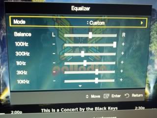

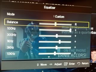

Is this thread for owners of UNxxD5300 owners too?
The picture on the UN22D5300 is outstanding using a Directv HR24 via HDMI.
Mode: Standard
Backlight: 8
Contrast: 80
Brightness: 45
Sharpness: 25
The sound on my new UN22D5300 is horrible.
I bought this tv after I returned a 19" Vizio that had sound so annoying_ I couldn't take it. There was no equalizer on the Vizio tv.
I've tried the presets and still the sound is too small and tinty.
This setting seems to give me results I can bear.
or
I even looked into the Service Menu, there is a "Sound" setting, but it doesn't look to be of help.
I have previous experience in the Service Menu area from my Samsung HL61A750.
EDIT: nothing adjustment wise works in the menu, sound is annoying on this tv too.
Any suggestions for a soundbar?
