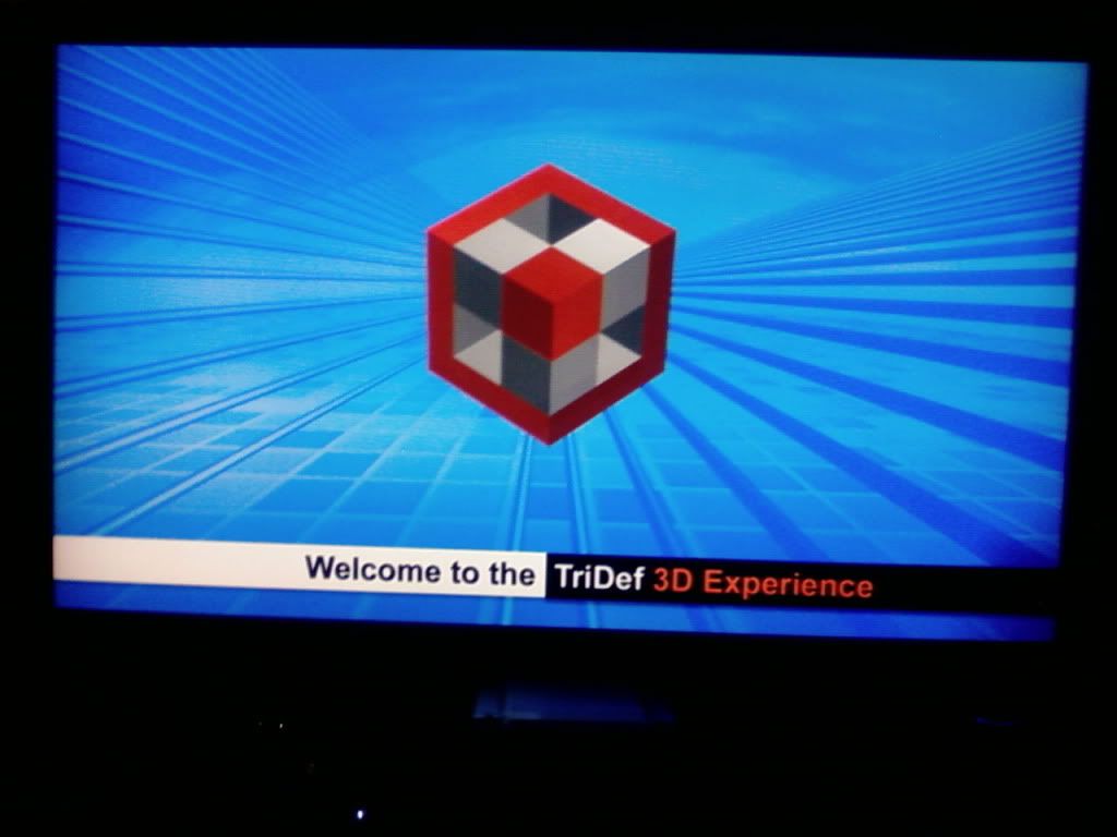

Right!
I've just learnt far more than I ever wanted to know about monitor INF's
Re your original post Butmuncher, if I'd actually read the beginning of the thread properly I'd have seen the part referring to the inf creation of the dat file from the EDID. As it was, I skipped over that bit and subsequently missed it, thus was likening the EDID fix to something akin to a firmware flash
Ok, so between yours and SkyGuy3d's posts, I now have my very own modified extension killing LG LW450U EDID inf update installed and confirmed by trying to run AMD HD3d (which now reports "please connect a compatable display". Done and dusted there. I've also generated an "original", just in case.
Now, what I've noticed from a preliminary is that there are some differences in image quality. Still trying to ascertain "what" exactly, except to say that it "appears" to be somewhat sharper. Mind, I'm sitting 3m back from a 42" tele but it seems to be visually more crisp, which leads me to believe I had more of a ghosting issue than I thought, but that I was actually looking at the wrong issue I'm seeing most profoundly....
Which is where SkyGuy3d's question comes in... I think what I'm seeing is what you referred to as the greyscale ghosting now. Essentially if taking something like Borderlands and staring at a lamp post, I've got the lamp post in 3d, but then about an inch either side I've got a grey ghost of it. That said, there's a red light on top of said lamp post which mirrors itself in red too either side.... In short, I'm seeing 3 of everything, with the middle being bold and the 2 either side almost as a watermark, for want of a better description.
Now is this a convergance issue or something to do with interlacing? The problem doesn't seem to be quite as apparent on iZ3d drivers, and was non-existent with HD3D.
Just to throw it out there, if I run TriDef's 3d Experience in interlaced, the spinning cube and the icons are seriously messed up, compared to HD3d. But then I could easily put that down to that particular app not being properly aligned.
For the record I managed to get the underscan issue resolved too (before updating the INF) - I'd already aligned the 1080p24 image, but I hadn't bothered with the 720p24. Did that and it worked fine.
Hi,
lets see if we can sort this out. Is it possible you can take a picture of the tridef experience cube loading up through one of your 3d glasses lenses and post it somewhere like mediafire or a host of your chioce, i would really like to see whats messed up and this can only be done by way of picture from phone/camera.

Ah, i never used hdmi 1.4 again afterward i just presumed rolling back the driver would have 1.4 working again, my mistake and sorry for any issues this has caused, it's easily fixable though as you just make a inf from moninfo using the " realtime " option under " displays " which is the windows on the left in moninfo.
I have took 2 pictures myself, 1 is with teh edid fix and 1 is without, as you can see the edid fix gives a nice crisp ghostless image where as with teh original edid you can see teh box is messed up, is this what you see, the messed up image?
Pictures was took using a crappy phone and i took the pics through the left lense of the glasses.
without fix
with fix

Err... Yeah.... Shortly after I made that last post, I looked closer at moninfo - mainly as I was going to go into the registry and find the element to delete manually.... at which point i saw the realtime, active etc catagories... *cough*
So! It now says "Extension Block: None"
Ignore my previous rants about that bit....
Monitor
Model name............... LG TV
Windows description...... LGE LG TV (GSM0001 EDID Override) LG TV
Manufacturer............. LGE
Plug and Play ID......... GSM0001
Serial number............ n/a
Manufacture date......... 2011, ISO week 1
Filter driver............ Monitor, EDID Override
EDID revision............ 1.3
Input signal type........ Digital
Color bit depth.......... Undefined
Display type............. RGB color
Screen size.............. 160 x 90 mm (7.2 in)
Power management......... Not supported
Extension blocs.......... None
DDC/CI................... n/a
HOWEVER. I'm still getting that god-awful ghosting.
So with that in mind, these are my settings:
Catalyst 11.7: All @ default, with the exception of underscan moved to 0 to fill screen.
Resolution is 1920*1080p 60
TV Settings are running with HDMI 1 labeled as PC, otherwise Picture is set to Standard, Aspect ratio is at 16:9 because just scan isn't available for PC (but then shouldn't be...), and nothing else has been changed.
TriDef is running as Standard Display Types, Line Interlaced (Reversed)
Am I just being thick here, or am I missing something completely?
It's entirely possible I'm being thick....
Subv3rse is offline

Hmmm,
By the looks of it you have done everything correctly.
I do'nt think your being thick, maybe there is something else going on as that edid looks fine to me, i've tried numerous edids from other 3dtv's/monitors and all have the colorbug and the same edids with the extension bloc deleted work with no colorbug.
It's a possibilty that you have a different problem to me hence why the fix does'nt work for you but for the life of me i could'nt say if that is true or not.
For tridef i use interlaced, reverse interlaced for me has the 3d the wrong way round, you could fix this with the left right toggle on controller but that can't be done as the tv is in native 3d mode.
In tridef under displays>manufactuers can you try the hyundia it corp .
When i first found the edid fix it was by accident and i'd done the fix a few weeks before i'd managed to even realise i had working interlaced.
But....
i'd read somewhere about hyndais interlaced monitors so i tried hyundai and i had working interlaced, i then zoomed onto iz3d and tryed interleaved and had the colorbug still, i then went back to tridef and tried interlaced and that had colorbug too so as it was the only interlaced that worked was hyundai's.
This led me to believe that hyundais iterlaced was different to the other types.
But...
I formatted and re-installed windows 7 and no longer had any type of working interlaced, this led me on the path of what i had done to have working hyundai interlaced, after a lot of messing i remembered about i'd messd with the edid so i retraced my steps and done the edid trick and had working interlaced.
Somehow then i had working interlaced with hyundai, standard interlaced with tridef and interleaved with iz3d.
You never know the hyundai option may work for you as it did for me and i can't explain whty it did and the others did'nt.
The fix came from the following website but it does state that its for nvidia drivers and its relating to linux, i have windows 7 and nvidia gtx470.
