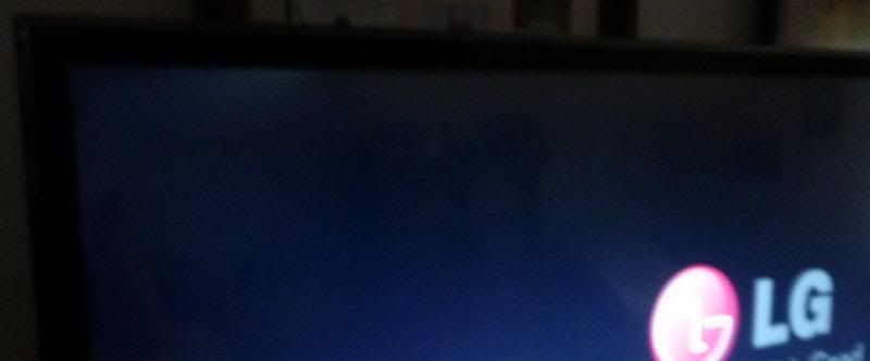

Is this an uniformity issue I should be concerned about - its only along the top edge of the screen (its hard to get a shot of it, can't use a flash and my camera was having trouble focusing in the dark)? Noticed it about a week ago. Its only visible on the startup screen - more noticeable if the TV has been off a long time. Its hard to see with light in the room and its impossible to see on test patterns. It almost looks like what happens when you press hard on a LCD while its on.

Mine has that too. As you say, it's only visible on the startup screen where local dimming is forced off and in other cases where you turn local dimming off. Since I don't plan to use the TV without local dimming, I wasn't too worried about it. Having said that, it is a obviously a flaw and it's unfortunate that issues like that are present with what's meant to be LG's flagship panel.
My set has it as well, I freaked out at first when I first saw it but have yet to see it during normal watching/black scenes.
I will say, after a few hours of watching, this set is, compared to my old Sammy LED HLT, much better! 'texture' to materials...I can't put my finger on it yet but I had noticed this on current gen sets compared to my 5 year old set, more depth...even uncalibrated it's better (new tech) compared to the old set. Very pleased and can't wait to get it calibrated!
I freaked too, I have it in the lower left hand corner and in the top middle of my screen. Full black I can see it, but I can't with 2:35 viewing.
this is also common when one of the screws in the back is to tight. may want to at least back off the torque a little bit and see if this corrects it.
No effect. I think the top screws (which weren't too tight) only hold on the bezel. The screws that might be too tight are probably inside the case.
Is this the Y or W set having this problem?
