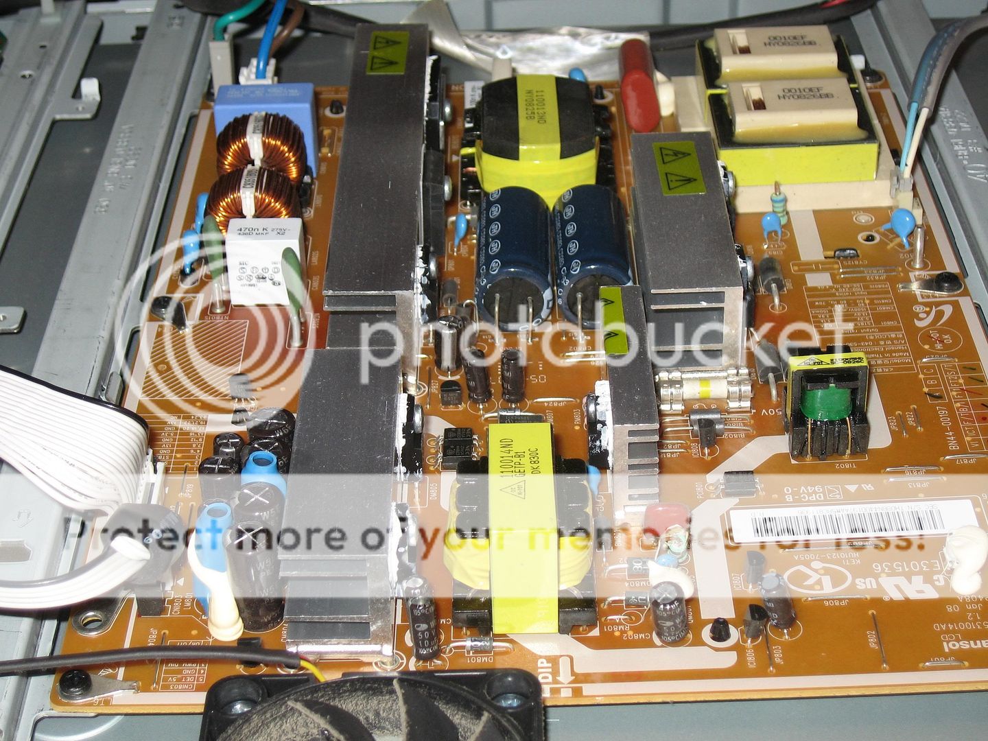

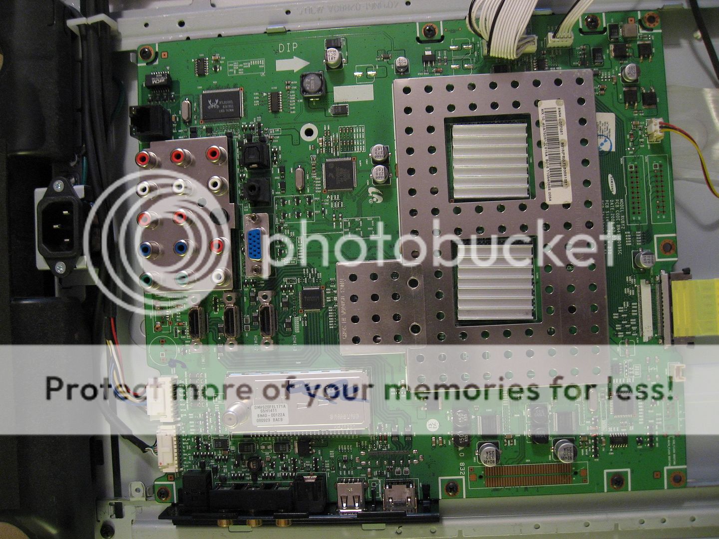

Just an update.
So I opened it up and I couldn't find anything wrong visibly with the caps.
My soldering equipment is quite crappy. So I just tried a little re-soldering of the connections.
It SEEMED like the TV started up faster and cleared up faster but after a day it's back to the usual.
1) Anyone know where a I can buy reasonable Soldering equipment and GOOD replacement CAPS?? I think I will see if replacing them will help.
2) Took some pics, so if anyone can tell me if anything seems wrong, please let me know.

post #12 of 30 Old 09-12-2011, 10:48 AM
MrBobb's Avatar
Join Date: Sep 2008
Posts: 3,722
Quoted: 164 Post(s)
Liked: 62
If ur intending to go DIY, here are some reasonably priced good soldering equipment. Don't have to buy the most expensive one, middle-road OK.

post #15 of 30 Old 09-13-2011, 07:38 AM
EG3
EG3's Avatar
Join Date: Jan 2010
Posts: 330
The problem with the distorted video is not a capacitor problem. This is a panel problem (probably a tab bond). When the problem occurs, try squeezing the top corners of the set and see if the problem goes away. You can also grab opposite corners (top left/bottom right or vice versa) and GENTLY rack the panel. Again, if the problem changes, you will have confirmed a panel problem.
EG3 is offline
