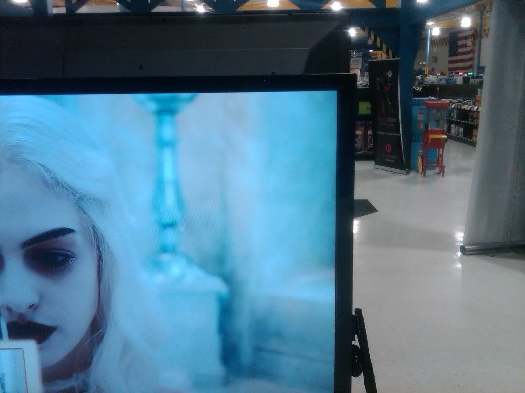

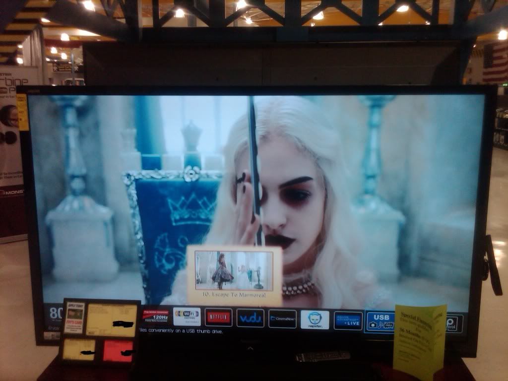

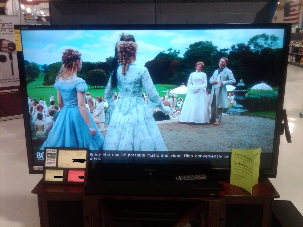

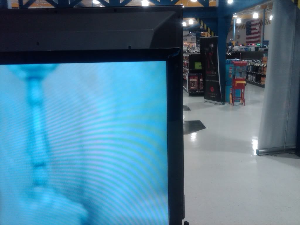

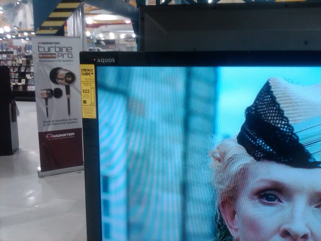

Stopped in to Fry's today in Anaheim and there it was in the middle of the TV area backed up against the Mit 92" RP TV. I must say from a distance I though it was one of the 70" models. It is just so hard to judge the size of these TVs when their placed right in the middle of a warehouse floor. In a typical home with 8 foot ceilings in a 10 x 15 room I am sure this thing looks just massive.
Spent about 20 mins looking at and here are my thoughts (remember I am in a store just visually observing. Don't crucify me as I am not an expert):
1) Up close you can see all the pixels. This TV is meant for viewing at least 8 to 10 feet at a BARE minimum.
2) I did not notice any motion blur. Although I was not watching any sports just Alice in Wonderland Blu Ray. It was pretty fluid.
3) Overall the picture looked pretty darn good. On par with the sharp 70" models. It is no Elite (X5) by any stretch of the imagination but compared to all other current 70" models I would say it looked about the same. If you are not an absolute Videophile and don't care about 3D I would say this TV would be just fine for the normal everyday consumer looking for a BIG TV.
4) I think the one piece of news that a lot of people would like an answer too is how do the corners look. Are they as dark as the 70" models. I kept forwarding to light scenes in the Alice in wonderland Blu Ray and really could not find even a "hint" of the dark corner problem seen on the 70" sets. I remember it being so obvious on all the 70" sets but here I could just not find it (unless there is something I am missing and the TV image has to be yellow for example). But in the daylight scenes in Alice with white and blu sky backgrounds and the all white scenes later in the movie I just did not see it.
5) I wished I could have sen it hooked up to Cable or DirecTv as I really would like to know how these bigger sets look for NFL broadcast games. At some point I would think the PQ will start to suffer from broadcast TV even in HD.
I have attached some pics of the set as everyone who has posted in here so far has been asking.
