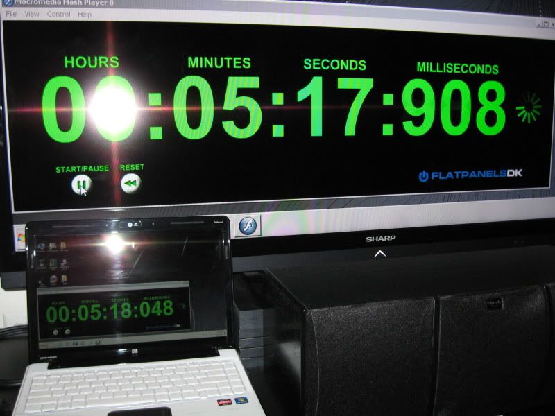

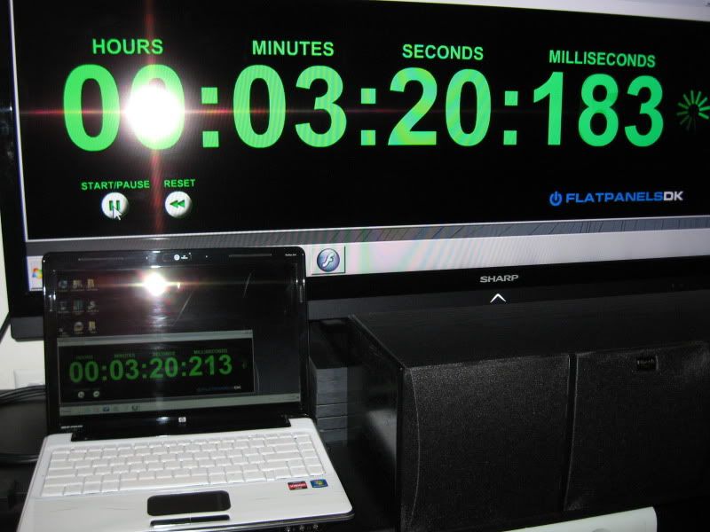

Thanks, Jason. Now prior to your post on settings, I calibrated my set using WOW using Movie mode. I turned everything regarding processing to OFF. Fine motion (120hz) and the mode for SOE and AUTO Contrast were all OFF. So given this, would the above MOVIE mode be same as the GAME mode you posted which had all processing off also? Which one would be the most accurate for blu ray movies? Sorry for all these questions...I think I am getting close to PERFECTION here!!!
rbanez is offline
post #825 of 1496 Old 02-15-2012, 09:29 AM
DaGamePimp's Avatar
Join Date: Jan 2001
Location: WA State
Posts: 16,045
Quoted: 449 Post(s)
Liked: 501
Movie mode still has some processing that cannot be disabled even when the user adjustable settings are set to OFF, so game mode has the least amount of processing of any mode on the 632.
I have done the tests and here are the results.
Game mode... 30ms
Movie mode... 140ms
Jason
Great! Thanks Jason. I will stick to GAME mode then. Now after using your GAME settings, do I need to recalibrate using WOW or just leave your settings alone? Also, my biggest issue is the OPC. I usually turn that on and give a range since it seems that in a dark room (watching blurays), the screen gets kind of bright and I set it to like -4 min and +10 max. I know it slightly affects certain settings but do you know if does affect it much? Do most people leave backlight set at a certain level regardless of room lighting? Thanks again.
Game mode... 30ms
Movie mode... 140ms
Jason
